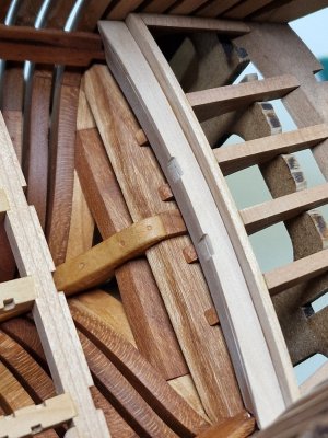

Today I'll show you some options for imitation bolts and nails on clinker.
The photo shows that the size suggested by the anatomy is clearly too large. The bolt head physically couldn't be 1.2-1.3 mm. That's simply enormous, considering the 0.5 mm head height. Therefore, studs with a 0.7 mm shank and a 1.2-1.3 mm head will definitely not work. This will look especially bad on the sheathing, where there's a taper of 4 mm.
Now a few words about mistakes. I specifically wanted to show them clearly, and how these errors will be visible, especially if you use bitumen.
1. Any cracks and crevices will be very visible after applying oil, and especially bitumen. Always keep this in mind.
2. The hole should be no larger than the dowel or wire. Otherwise, there will be a dark halo around it.
3. The bolt heads should be to scale (otherwise, you'll get a cucumber effect with its bumps). And ideally, all the nails and bolts should be as similar and identical in shape as possible (this will at least look prettier and neater).

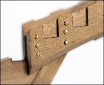

A quick option is to glue the nail or wire into the board and then cut it off and sand it flush with the boards... but I don't like this visually, although it's good and simple.
I like it when the dowel or wire protrudes slightly above the surface, creating some texture, but only very slightly. So, I initially did it like this:
I drilled a 1 mm hole, inserted a 1 mm wire into it, and snipped it off with wire cutters, leaving 0.5 mm. Then I sanded it down. This way, the wire protruded slightly above the surface, but was rounded.
I liked the 0.8mm wire option better than the 1mm wire; it looked more natural, but...
... I bought special cup-shaped burs:
These burs come in various sizes, from 0.8 mm upwards. I noticed that the 0.8 mm burr worked very well on nails with a diameter of 0.5 mm, but when used on 0.8 mm wire, the results weren't very visible.
That is, even under magnification, any geometry of the head is barely visible. It just looks like the wire has been scratched, but on 1 mm wire, this burr works wonders, in my opinion!
In the photo above, you can see that the polished 1mm wire looks ordinary and unnatural (although this result is very easy to achieve).
But after burring, a clear bolt head profile appears!
Yes, you need to control the center when positioning—otherwise, the bolt head may be off-center, but this is mainly due to haste and the uneven surface of the wire before burring. But I really liked the result. And most importantly, it's very quick and repeatable!
So, to summarize, the current plan is to make a test piece and perform the following manipulations on it: use a 1 mm diameter burr to process the 1 mm wire, and use a 0.8 mm burr to process the nails (0.5 mm birch toothpicks) (since that's the smallest).
And here's the planned result, very enlarged:
I love how fast, repeatable, and easy this method is. It only takes a few steps: mark the hole with a needle, drill, insert the wire, cut it, and lightly sand it with fine sandpaper to remove the sharp edges. Then, use the burr to create the cap, which takes about a second... hmm...

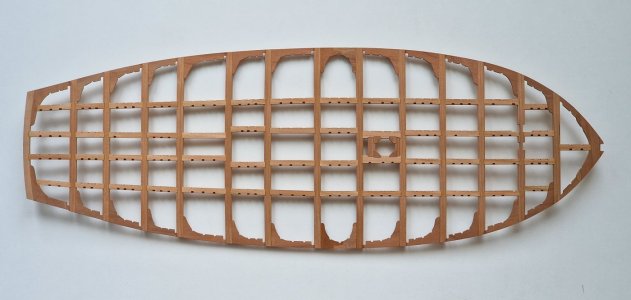

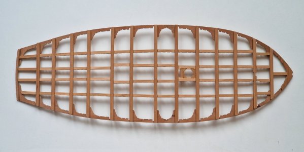

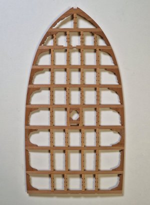

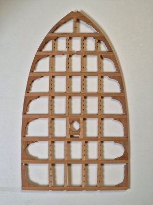

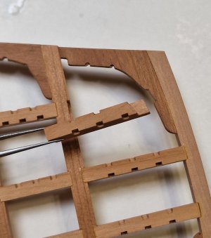

Continuing with the deck... today I managed to complete three spans at once.
The new additions are the prefabricated knees that connect the front and back of the deck.

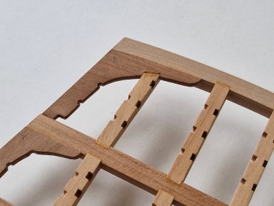

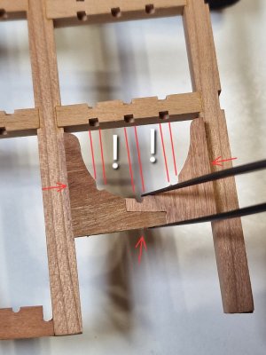

The important thing here is to connect them so that the connection itself is in the right place, and the edges of the connection with the beams are precise, but it is also important that the grooves on the carlings and knees match, so that the partitions are parallel to each other.

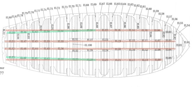

The second point is that almost all the carlings run parallel to the ship's axis (highlighted in red in the diagram below). However, the outer carlings, from the middle to the stern, run at an angle (marked in green in the diagram). This is important, as the carlings now need to be prepared in pairs (two middle and two side ones, ground at a slight angle).
Well, everything else remains unchanged... first I glue the carlings to the beams and then glue the knees outside the hull.

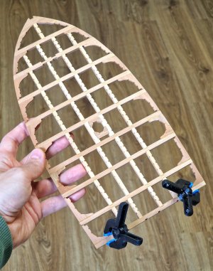

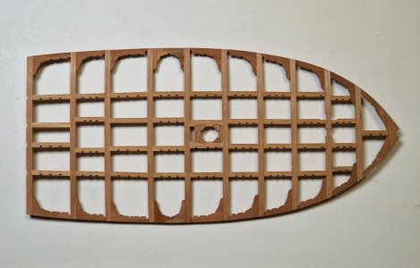

The deck keeps growing and growing... and this is what it looks like relative to my hand.
I'm one span and 2/3 are already ready...

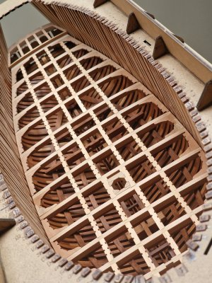

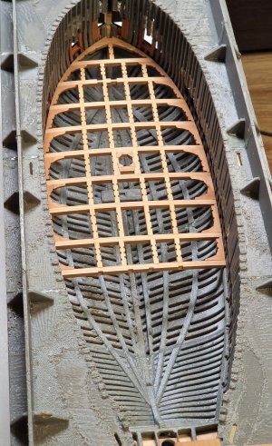

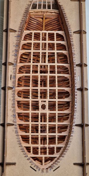

And here's how it looks in the ship's hull... in first!
But it's also no small matter that she easily fits into the ship's second hull...
...and what a shame it can't be cloned. CautiousROTF
We'll have to make a simplified version for the second hull, so we can then cover the entire deck with planks.

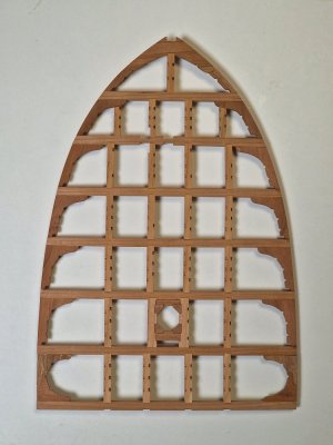

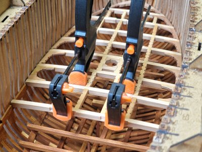

There will be one issue at the very end, since the final beam is already glued in place and the cleats need to be reinforced to ensure they are held in place while polishing the deck away from the hull, but more on that next time... ;)

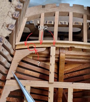

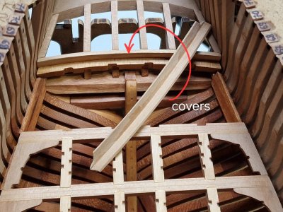

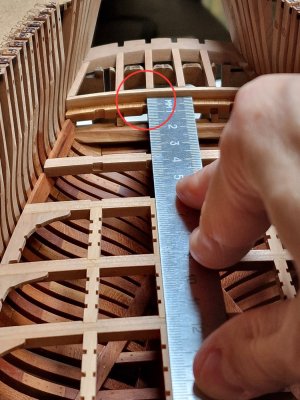

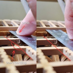

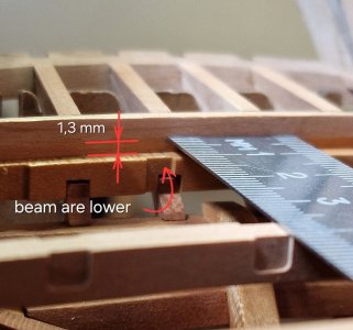

The last beam was already part of the hull, and it ended up lower than it should have been...
The place in the red circle is closer:
1.3 mm is a lot to ignore, because if the boards on this model were nailed, there would be a bend in them.
And since I'll have deck planks on the second hull (and the hulls are exactly the same), I need to calculate everything here and repeat the same steps to ensure the deck planks are aligned correctly.

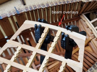

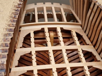

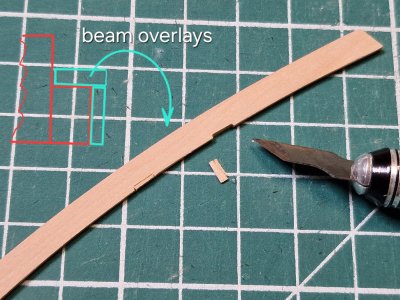

But that's not all... The beam ended up being further from the second-to-last one, and the keels and knees didn't reach it...
Therefore, I decided to make an overlay on the beam, increasing its height and width.
The picture above shows the profile of this escutcheon in green. This is actually beneficial, since the deck is removable and the final carlings and knees would be fragile without the final beam, so the escutcheon will strengthen the structure at the end.

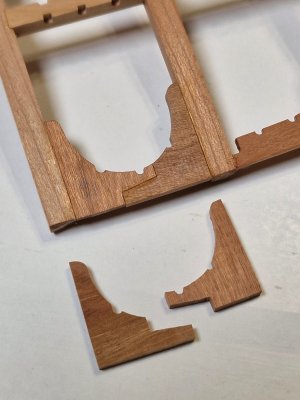

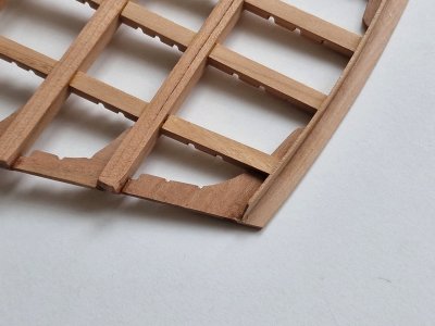

The side carligni here are a little more complex in shape, which are placed under the knee.

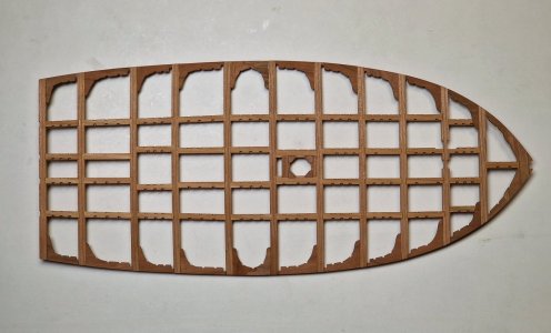

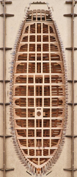

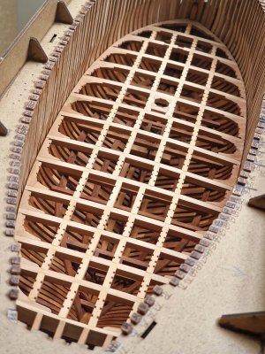

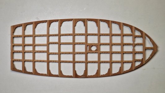

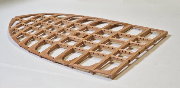

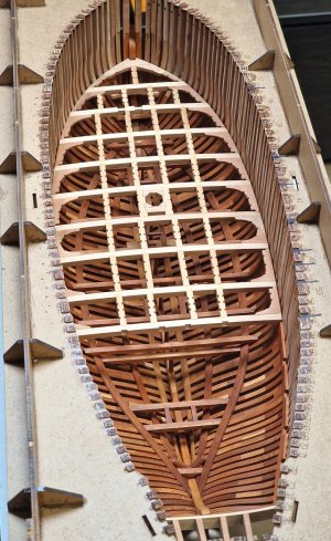

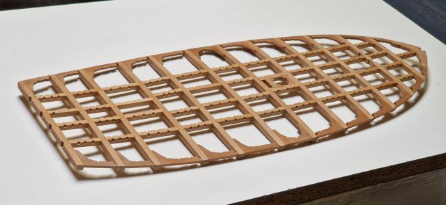

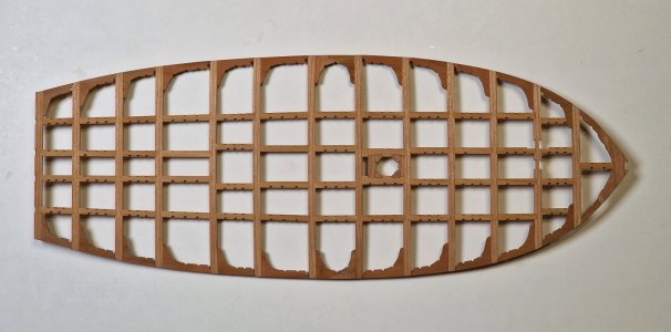

Well, here's what the entire deck looks like from both sides (without crossbars and without sanding yet).
The rear section of the hull looks like this. (The gaps between the deck and the hull are larger than necessary, but otherwise the deck wouldn't be able to be removed. These gaps will be covered by the waterway, and that's where the glue will be to secure the deck in place after its final positioning.)
More than 100 parts and here is the result in the case (not glued yet).
Now comes the big work of removing excess glue, rough sanding, and then securing the Ledges. I haven't yet decided how I'll implement it all... but more on that later.
