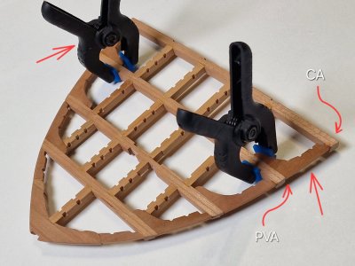

I'm not sure I understood the question correctly, but I'll say this: any gap in wood or between two parts will be very visible after applying oil. CA glue works similarly. It also greatly highlights cracks by filling them. To prevent it from shining, it needs to be sanded or scraped off, but this will still leave a black line, albeit a matte one. Filling gaps... depends on the purpose. If I want to highlight something with a dark line, I intentionally create such a gap and the glue highlights it, but more often than not, the gap itself under the oil creates the same effect of a dark line. I hope I answered the question, or could you clarify what you mean?
Not all.
I've seen videos where Olha for example, drills holes for dowels, nails, but instead of this nails, she put CA glue into this holes and fills them with CA glue, and next sanded.
Similarly, if there's a large gap in wood, some modelers fills it with glue instead of using putty.
CA fills gaps like putty.

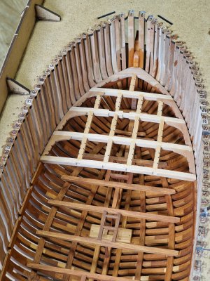

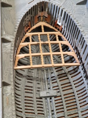

Chapter 6. Upper Deck
1. Upper Deck (1st hull)

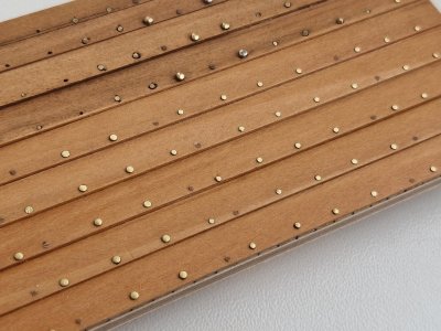

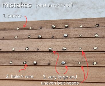

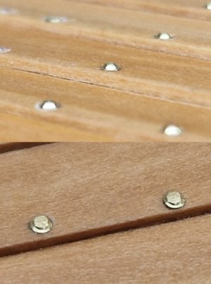

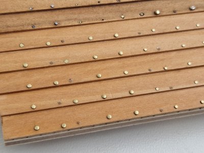

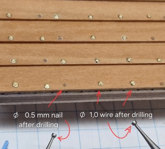

Since I'm currently actively working on the test pieces with imitation bolts and nails (and this takes time), I can't continue with the sheathing yet, so I've returned to the first hull (skeleton) and am continuing to work on the Upper Deck.

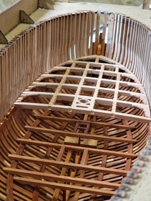

On the right is the finished deck section, on the left are the new parts. And the carlings (parts EL09 and EL06) with missing grooves for the small transverse parts (ledge).
I had to make these grooves as shown in the photo above. Then I glued the third beam.
Let me remind you that the deck will be filmed until the very last moment (at least that's what I plan to do, and then we'll see how it turns out).

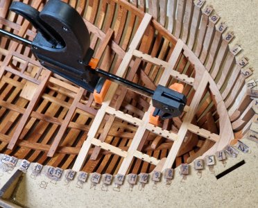

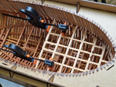

I've written before about how I build a deck, but here's a quick step-by-step description:

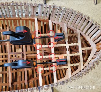

We have a fore-and-aft section and, say, any beam, and we need to glue four carlings to it.
1. First, I place all four carlings side by side, making sure all the ledge grooves align (otherwise, they will be glued crookedly).
2. I place knees on the sides so that their ledge grooves also align with the carlings.
3. I calibrate one end of all the pieces so that they fit neatly and evenly against the desired beam.
4. I insert the deck section into the hull and place the next beam in its place. I align the carlings with the grooves of the existing beam and determine how much it needs to be shortened relative to the new beam.
5. I calibrate the carlings' length on a grinder and then join everything together without glue and place it in the hull. If everything fits, I glue them together using clamps.
6. Then I remove the deck fragment and...
7. ... I glue the knees, the front part with PVA glue, and the small rear part with CA gel. Before that, I sand the parts on all sides and create imitation bolts. By the way, I also sand the carlings on all sides, just like the beams before fitting and gluing them together.
The end result looks like this.
If you're having trouble understanding the process from the text description, let me know, and I'll try to take step-by-step photos. I think it'll be clear to anyone who's building this kit, but I'm not sure.
So far, the deck has been easy to remove and reinstall...
...and most importantly, this deck can easily be installed on a second hull...
...and we're considering duplicating this deck to quickly and easily create a duplicate for future planking.
So, almost 1/3 of the deck is already complete, but there's still a lot of work to do...

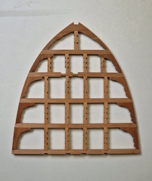

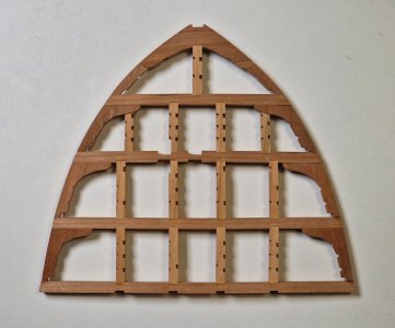

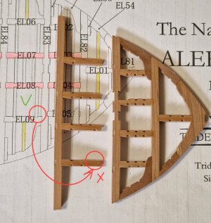

How do you make such clean and perfect notches in the beams and carlings?
I don't want to disappoint you, but these are milled parts from a kit. It's a good kit, but still a kit. Yes, like any part, it needs some fine-tuning, but the milling quality is quite good to begin with, so with some skill, you can make a good model from this setup.
At the beginning of this thread, I did a detailed review of this kit:

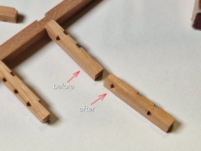

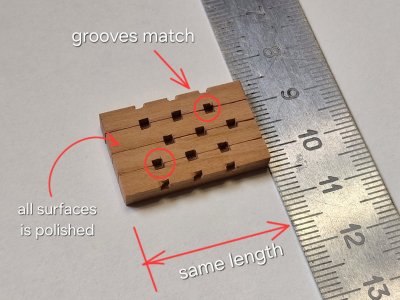

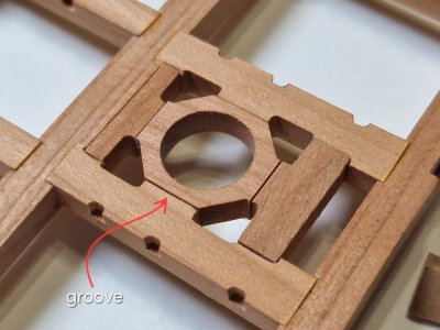

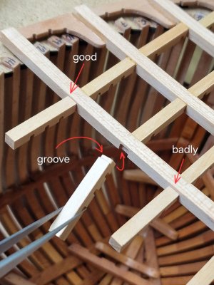

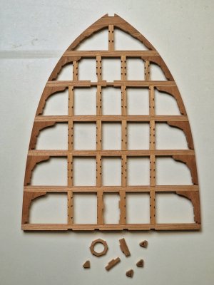

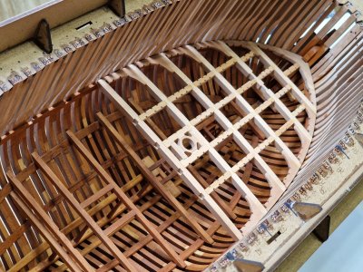

So, let's go into a little more detail. Any beam-to-beam assembly begins with adjusting one carling beam to length.
Then I calibrate all 4 to the same size (I make sure that the grooves match, they are circled) and sand all the parts on all sides.
Then I create grooves in the carlings so that they sit completely in the beams and do not stick out above the deck level on top.

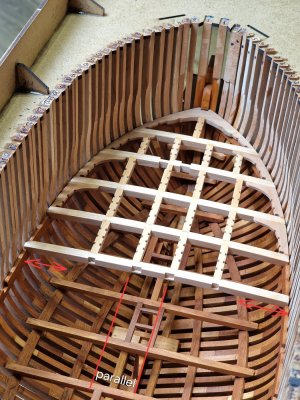

Then I glue everything in place, carefully monitoring the parallelism of the carlings. If necessary, the beam has a small amount of offset, allowing for precise positioning while maintaining parallelism.

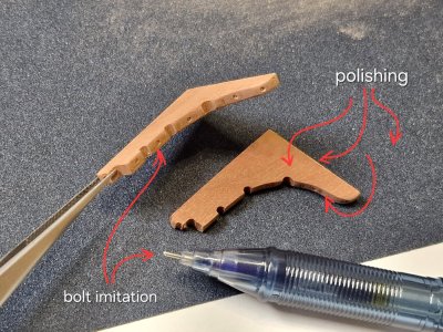

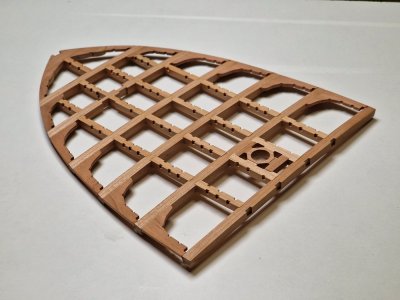

After that, I prepare the Knees: I sand them on all sides and make imitation bolts.
Then I pull the deck piece out of the hull and glue the prepared Knees.

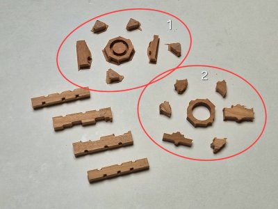

Before this, all the manipulations and details were practically unchanged, but between the next beams there will be a mast insert, and I have two sets of parts for it.
I chose the best ones and at first I did everything the same as I showed before...

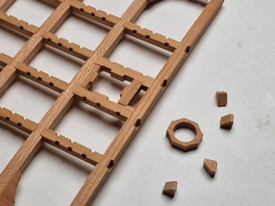

... and then glued the first two parts: After and Fore partner chock.

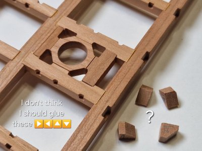

Afterwards, I glued the ring-shaped part, making small gaps between all the parts for better visualization later.

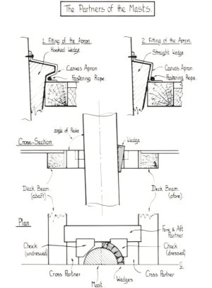

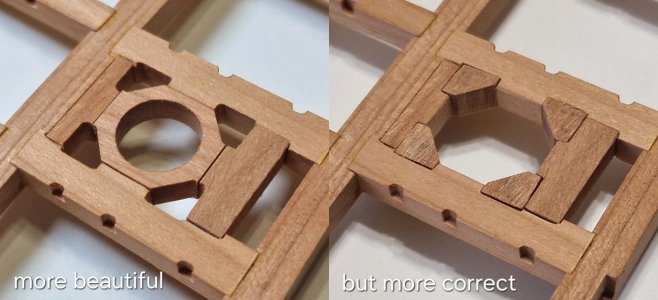

I still haven't found the name of this part, but I'm thinking of not gluing the triangular filling chock pieces on. I like this unfinished look.
As for the ring-shaped detail, I don't think it ever existed in that form. The mast was secured with spacer wedges driven between the mast and all the other components, filling the entire space that constituted the ring-shaped detail.
But visually, it looks nice, so I decided to leave it as is.
But maybe I'll change my mind and remove the ring and glue in the triangles... I have spare parts, I can change my mind several times. ROTF
Almost half the deck is ready, now it's just Ctrl C - Ctrl V... but if only it were that fast in reality... Cautious:rolleyes:ROTF
Update:
I'm still thinking of removing the ring and gluing in triangles to make it look right. Yes... it looks better with the ring, but it's no longer right. So, I think I'll redo it, especially since it's very simple. According to anatomy.

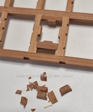

Still couldn't resist and got to work, just now, I redid the partners' masts. :eek:ROTF
Yes, I liked the original look better, but it needs to be done according to the canon, because...
... I removed a non-existent part (which the kit manufacturer invented and which simply doesn't exist—I'm talking about the ring-shaped part).
I installed the triangular partners, and now all the parts are in place and...
... the most important thing is that everything is correct now. ;)
The exterior is still natural—not final. Everything will still be sanded and polished flush with the deck, but I'll leave small gaps between elements to better visualize individual details.
P.S. although, I already like it. :rolleyes:

Well, let's continue with our experiments and tests...

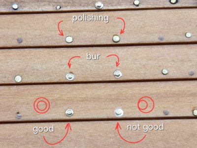

Today I'll show you some options for imitation bolts and nails on clinker.
The photo shows that the size suggested by the anatomy is clearly too large. The bolt head physically couldn't be 1.2-1.3 mm. That's simply enormous, considering the 0.5 mm head height. Therefore, studs with a 0.7 mm shank and a 1.2-1.3 mm head will definitely not work. This will look especially bad on the sheathing, where there's a taper of 4 mm.
Now a few words about mistakes. I specifically wanted to show them clearly, and how these errors will be visible, especially if you use bitumen.
1. Any cracks and crevices will be very visible after applying oil, and especially bitumen. Always keep this in mind.
2. The hole should be no larger than the dowel or wire. Otherwise, there will be a dark halo around it.
3. The bolt heads should be to scale (otherwise, you'll get a cucumber effect with its bumps). And ideally, all the nails and bolts should be as similar and identical in shape as possible (this will at least look prettier and neater).
A quick option is to glue the nail or wire into the board and then cut it off and sand it flush with the boards... but I don't like this visually, although it's good and simple.
I like it when the dowel or wire protrudes slightly above the surface, creating some texture, but only very slightly. So, I initially did it like this:

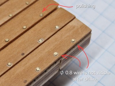

I drilled a 1 mm hole, inserted a 1 mm wire into it, and snipped it off with wire cutters, leaving 0.5 mm. Then I sanded it down. This way, the wire protruded slightly above the surface, but was rounded.
I liked the 0.8mm wire option better than the 1mm wire; it looked more natural, but...

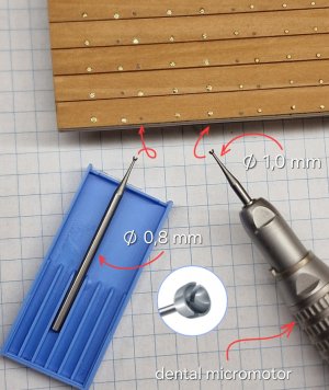

... I bought special cup-shaped burs:
These burs come in various sizes, from 0.8 mm upwards. I noticed that the 0.8 mm burr worked very well on nails with a diameter of 0.5 mm, but when used on 0.8 mm wire, the results weren't very visible.
That is, even under magnification, any geometry of the head is barely visible. It just looks like the wire has been scratched, but on 1 mm wire, this burr works wonders, in my opinion!
In the photo above, you can see that the polished 1mm wire looks ordinary and unnatural (although this result is very easy to achieve).
But after burring, a clear bolt head profile appears!
Yes, you need to control the center when positioning—otherwise, the bolt head may be off-center, but this is mainly due to haste and the uneven surface of the wire before burring. But I really liked the result. And most importantly, it's very quick and repeatable!

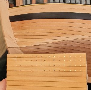

So, to summarize, the current plan is to make a test piece and perform the following manipulations on it: use a 1 mm diameter burr to process the 1 mm wire, and use a 0.8 mm burr to process the nails (0.5 mm birch toothpicks) (since that's the smallest).
And here's the planned result, very enlarged:
I love how fast, repeatable, and easy this method is. It only takes a few steps: mark the hole with a needle, drill, insert the wire, cut it, and lightly sand it with fine sandpaper to remove the sharp edges. Then, use the burr to create the cap, which takes about a second... hmm...
