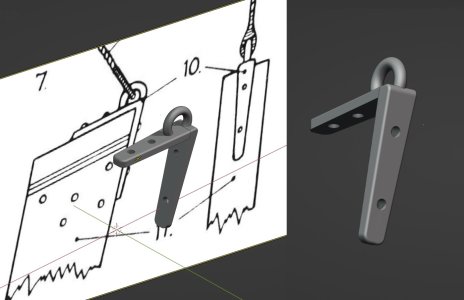

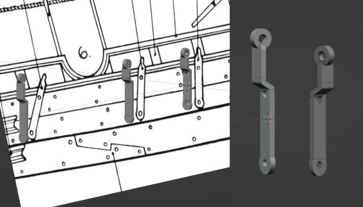

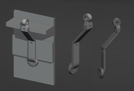

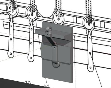

So, to finally finish the outer surface and move on to the inner, I need to finish the rudder, or more precisely, the rudder hinges. I've looked through a ton of photos and drawings of cutters and I'm modifying my hinges, or more precisely, I'll make the two lower ones longer, overlapping the planking.
I'm following ship logic... the lower hinges bear a tremendous weight, considering the two upper ones are small. And since there are ribs under the planking, it's logical to do it the way most cutters do (especially larger ones).
Plus, I don't believe there wasn't an emergency rudder-turning mechanism (manually using chains). In the photo above, it's shown in blue and red. (I've already decided and will use the red version.) Plus, if the rib wasn't large, the hinge would bend around it - shown in black. All of this can be seen on virtually all ships of that period. Incidentally, the anatomy of this ship itself confirms the hinge length, where, in fact, one drawing shows exactly that.
The option on the right is definitely more accurate and functional.

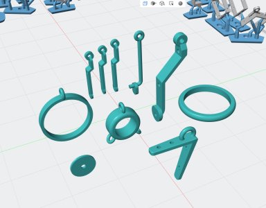

As many already know, I'll be 3D printing the metal parts and then copper-plating and blackening them... but to print them, I need to somehow process them... At first, I thought it would be faster to scan the existing parts from the kit and then print them... but then I changed my mind and decided to do everything from scratch.
3D Modeling. Part 1/3.
Just so you understand, it took me only two days to create everything you'll see below, including preparing it for printing. This is because I definitely couldn't have made these same parts for both models in two days...
I modeled them in Blender 3D and then used the Anycubic slicer for printing.
Since it doesn't matter how many parts you put in for printing, and the only thing that matters is the height of the longest part (the duration of the process depends on this), I made a number of other parts at the same time so that I could print them simultaneously.
These parts (top and bottom) could be made from copper or brass plate, but achieving symmetry and precision by hand is more difficult than this method. Let's see if this thickness works... 0.2 mm

I always check one copy for compatibility and errors before printing...
Then I prepare everything for printing, duplicating everything in the required quantity. To be on the safe side, I always print with a margin for defects (both during and after printing). And since I'm making parts for two models at once, I print, for example, not four parts, but six. Or if I only need one part, I print at least one more as a reserve.
I recommend placing small details around the perimeter. 1) It's easier to tear off later. 2) The film is more intact there. 3) The film stretches less during printing.
I myself am interested in how it will be after copper plating and blackening... we'll see later.

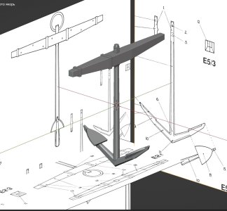

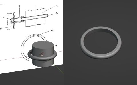

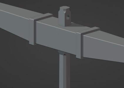

3D Modeling. Part 2/3.

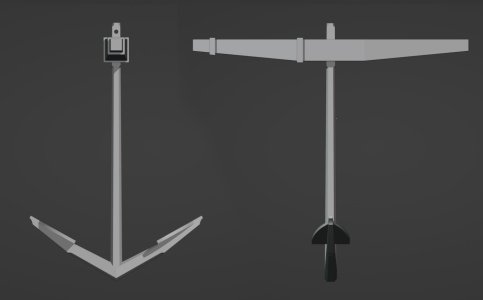

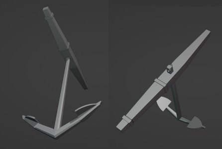

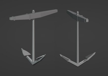

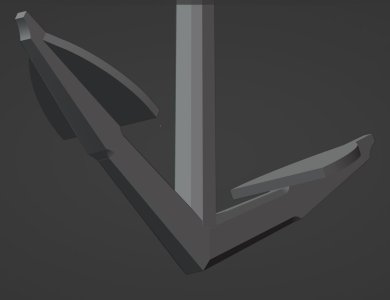

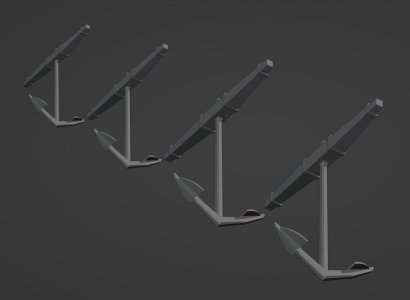

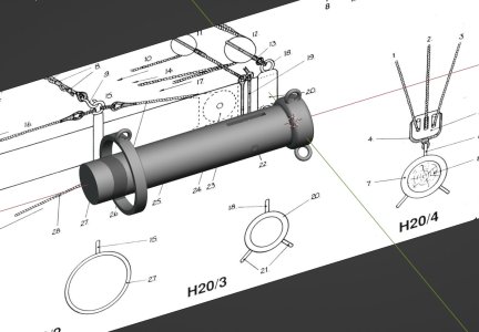

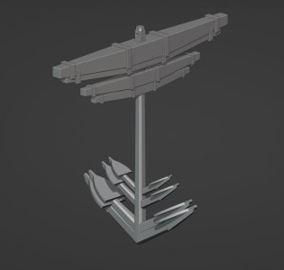

I thought I'd gradually begin modeling, but once I've started, it's hard to stop... ROTF
In this part, I'll show the anchors and other small metal parts from the ship. I've practically done everything... All that's left is to model the cannons with their carriage parts (rims, etc.) and the small hand cannons... and that's it!

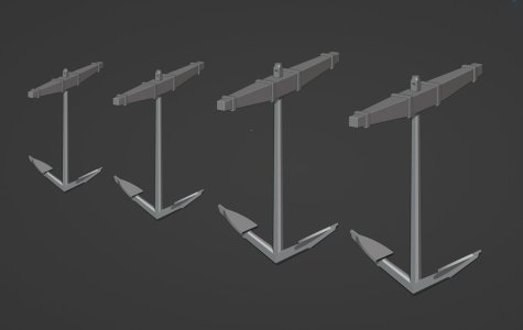

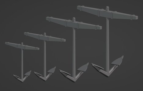

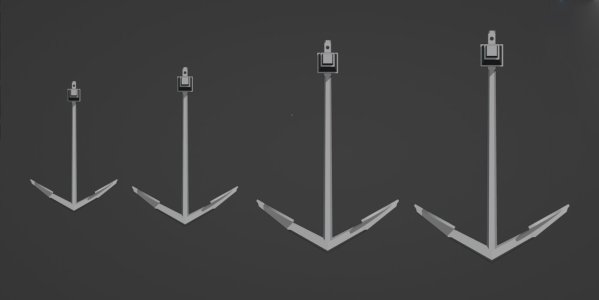

By the way, there were at least four anchors on the cutter (maybe five). I decided to make four, as indicated in the anatomy (and not two as in the kit, which are also identical). And I'll place two small ones on the Channel... but more on that later.

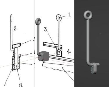

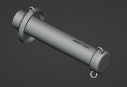

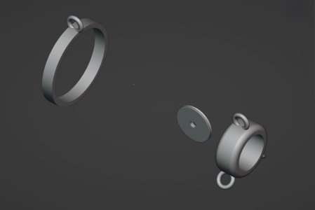

Well, here are the remaining metal parts:
Now, just add some support and get printing... I'm already itching to copper-plat them...
