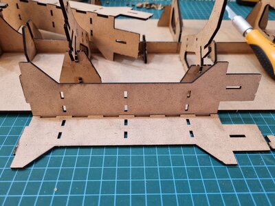

Today I finished preparing the jig of the model.
first I removed with a knife the two parts that were accidentally glued yesterday , and for that thanks to Jim who helped point out the mistake.
Next I made the pillars that support at a 90 degree angle. At first I mounted them in a way that did not fit the holes they go into , then I adjusted them to the numbers (28 + 29) that appear in the instruction booklet and it fits in easily and fits.
By the way, this time too, one of the parts of the page simply did not withstand the pressure of the connection to the other part and was simply torn. Do not worry the problem was solved by gluing and connecting all the parts that supported the page.
Next I connected the 25-27 parts that support the frames and then the board that covers / closes the jig from above.
I attach pictures of the process and wish us all a pleasant and enjoyable weekend
