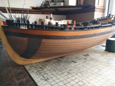

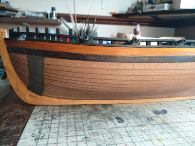

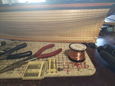

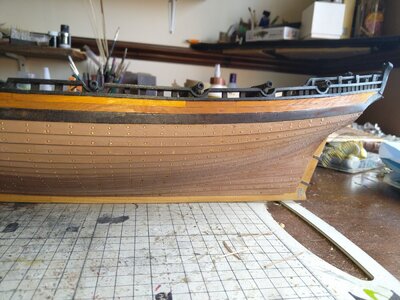

It is a sh....t load of work making all these bolt but definately worth the effort.Holes drilled now filling in with copper wire then burred over as per Maartens description, picture shows tools and wire used, hope it helps somebody when get to this stage. Happy modelling cheersView attachment 240605

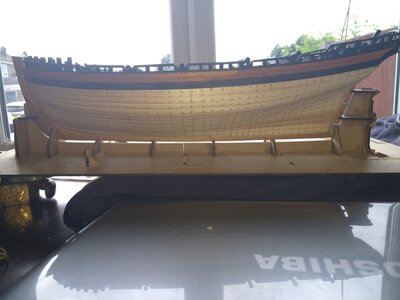

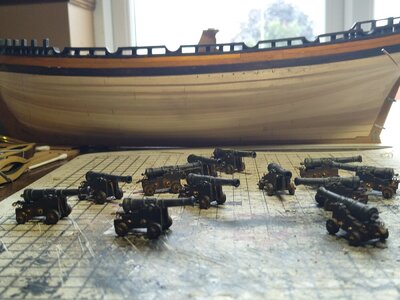

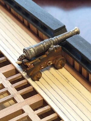

素晴らしいですね。 今後の投稿が楽しみです。Holes filled just got to burr them all now!!!!! Layed cannons on top definitely more planking required.View attachment 240759View attachment 240758View attachment 240757

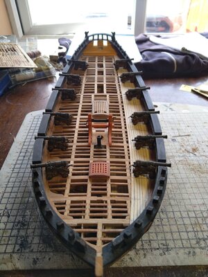

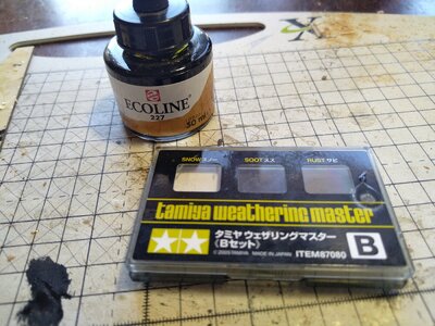

デッキ張りが、素晴らしい。Small update, decided to colour planking, now starting on grates etc happy modelling all View attachment 243282View attachment 243283View attachment 243284View attachment 243285

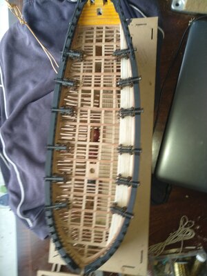

デッキの追加張り、良いと思います。次回の投稿が楽しみです。Thank you all for the likes and comments fukui, might put some more decking down not quite sure yet, what do you think?
Thank you Jim, I'm jumping back and forth a bit not finishing one thing off, probably end up missing something if it not for the gentle reminders thank you and keep them coming. No not varnished anything yet, and gratings are from kit they very good just trying different coloured inks to get to required effect for me. As i'm sure you all aware this model is great fun to build. Big thumbs up and well done Trident.
