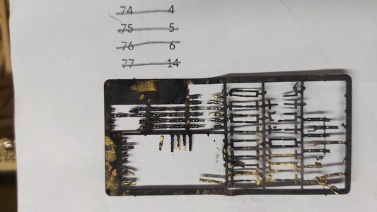

WARNING: some good news & some bad news.

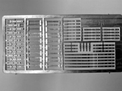

I used some brass black on the PE parts suppied in the kits. Bad move. not sure if its true brass or some alloy but the parts only got a powdery surface and when I picked thm up they disintegrated. So ALL the PE in my kit is now kaput!,
The good news is that I had some black cardstock so replicating the door hinges was not to difficult. The parts are so small that its not a huge issue. Just need lots of magnification, steel ruler and very sharp no 11 and some imagination.

Great idea, Poul. But, their chemicals will not be able to reach us, they are prohibited for shipments. Maybe the 'Brass black' should be diluted with water? Also, it is a possibility testing them with our (available to us) using the scraps of frets.
Hi guys, the Solution of Casey Birtchwood Brass black should always be diluted for PE. I normally use a 10% solution mixture with water. Sronger solutions can lead to pitting on the surface. I have used the same product for a long time and its the same stuff as shown in an earlier video. It typically just darkens the brass and leave a small film of oxidization on the parts. Sometimes areas will not darken and have to be cleaned with acetone first.
The liquid turns dark blue as it does it job. In this instance the parts went black, but the liquid remained clear.When n I took the parts out the black fell off and the parts strarted to fall apart as I washed them under slow running water . Never had this happen before. The PE looked and felt normal prior to dunking. They fell apart over a 10 minute session. As to why it happened I have no idea.
