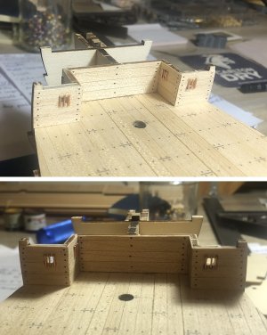

While sleeping last night, I had a dream about those skylight doors. There is still something wrong with them...
First of all, according to the build kit, the doors are too small, resembling cabinet doors.
Besides, what are the slanted hatch lids for?
This morning, I had a closer look at some HMS Beagle plans and discovered that there is a ladder-way from the Captain's cabin to the upper deck.
Aha! So, these doors should be taller. . . I extended the doors and panel to indicate this.

How many bumped heads?

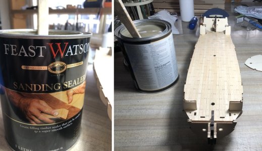

Yesterday, I bought a tin of satin clear varnish and a tin of sanding sealer (pore filler lacquer) from the local hardware store.
As recommended by the kit instructions, I gave the deck a coat of sealer.

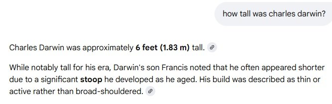

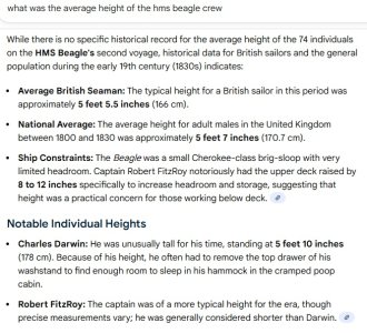

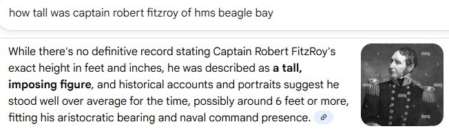

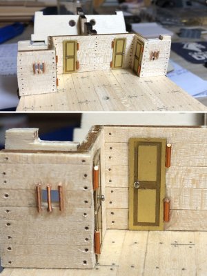

I am disappointed with the OcOre's HMS Beagle kit regarding the degree of accuracy.
The kit's scale is 1:60, but parts of the ship are too small for humans of that scale. For instance, the four doors in the aft section are 22 x 13mm. That is, 1320mm (4' 4") high and 780mm (2' 6.7") wide. The cabin interior height is 23.5mm i.e., 1410mm (4' 7.5").
If the 1:60 scale is true, the ship must have been for dwarves.
It does not say much for Darwin's theory of evolution, regarding humans.
Nope, the scale is about right. The average adult male at this time was about 5'6" (1.68m) high and wasn't afraid of ducking his head. And just for the record, even after rising the main deck by 6" (15cm), one could barely stand under it...
Thank you for your response and explanation.
I still cannot get over the fact that even a 5'6" person has to bend down more than 1'2" to get under a 4'4" doorway. Correction, 4'3" doorway, due to doorhead and jams.
Nevertheless, I will base my figurine sizes/scale on your recommendations.

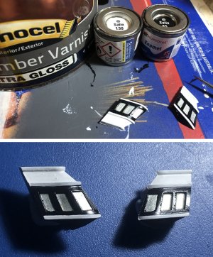

From the beginning of this build, I had a few alternative ideas I wanted to implement. One was to remake the stern quarter galley windows to have windows. But I discovered that in reality, the galley windows were fake, built simply as an ornament. To model them to have windows would have been a bigger fake.
I learnt that quite often, while looking at windows, what one sees is a greyish background. So I decided to apply a few coats of clear ultra-gloss varnish to the windows. This produced a glare effect. The photo below shows the glare as white (it's the best my iPhone can reproduce).

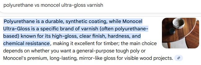

Have you thought about coats of polyurethane?
I don't recall whether I did or not, but I do remember asking the paint shop, several years ago, for the highest gloss possible.
However, I did inquire about the following and discovered that the varnish I used is likely polyurethane-based.
I used the Monocel Ultra Gloss on my cherry wood cabinets when I built them 23 years ago and they still look brand new. My Captain loves them because they clean up very well with a damp cloth
I think it would be a little much on a ship of the line but would be great for a fiberglass hulled boat.
