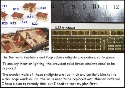

Before I do any planking, I need to work out a few details about the interior wiring for lighting and how to alter or replace some of the kit pieces.
I want to have interior night lighting visible through the skylights, but there is a problem...

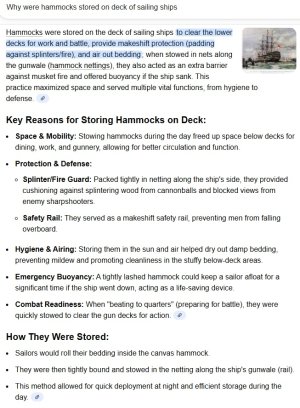

Hello Maties. I need your help. I have a Question...
They are supposed to be the crew's hammocks set outside to dry/air out. The question I have is why are the hammock nettings solid an both sides? Kind of defeats the primary purpose. I can understand wanting the additional sideboard to help mitigate swamping that the Cherokee class brigs were famous for, but I question the depiction of solid wood on both sides. Just my two cents.
I asked Google AI...

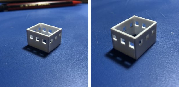

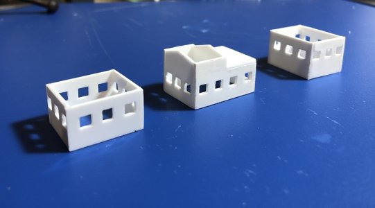

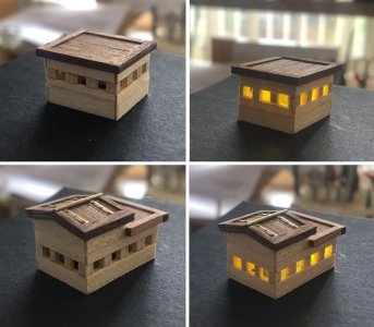

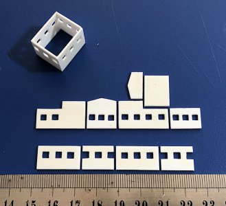

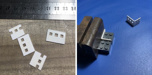

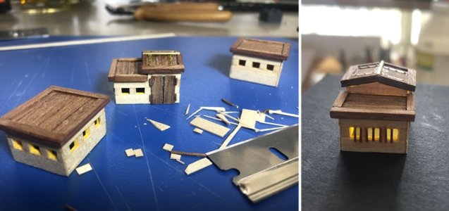

Even though I completed the wooden panelling, it is still not finished. I've run into a few problems (as expected with model building).
The white 1mm polystyrene sheet is quite light-transparent. I will have to dim the light source even more.
The interior needs to be repainted white to see if that lessens the effect. I am after a warm light effect.

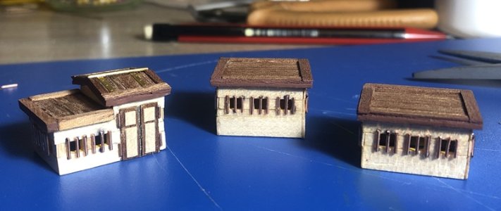

Below: I am not happy with the doors. I might add panels of the lighter timber.
I experimented with a section of the captain's skylight that is not seen when placed on the deck.
I included protective bars across the windows. I will try to do a better job of it with the rest of the windows.
When the interior light is too strong, you can see the interior light penetrating the upper panel.
