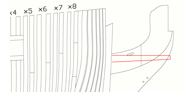

Where do i trim it down to on the plan enclosed
Thanks

The leading edge is tapered all the way down to the gripe which is just above the curve where the cutwater attaches to the keel.
The leading edge should still have a squared off cross section.
I hope I explained that well. :)

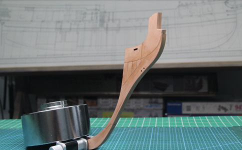

Found these from Arban
Ist shows the lower part - looks as though he used a strip of Masking tape to show how he cut the slot correctly
But his Cutwater does not show if its been cut down
any ideas please

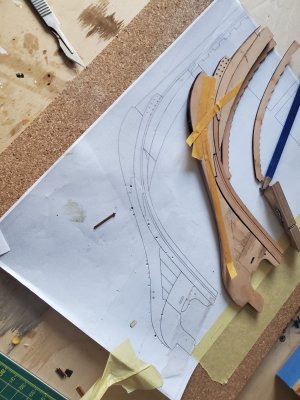

decided to give a frame a go - Keef has done 7 not gluing just to give me an idea tomorrow is another da with fresh Eyes

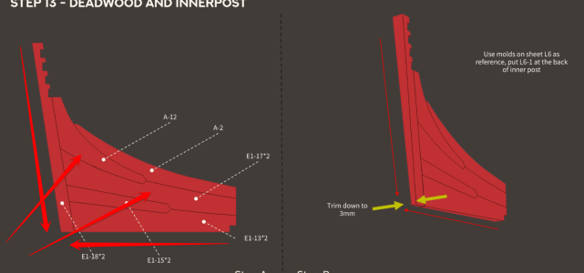

Have decided to start on the Stern
It talks about triming it down to 3mm
I realise its from the top of
How far up Stern Deadwood Does it go
Ive cut too much off the bow Dont want to do the same
Then we put on part G1 etc and trim down to 4mm
I presume its to take the planking up to the stern post
Thanks
Thanks
It tells you on the right hand side of the diagram to use the template L6-1 as a guide

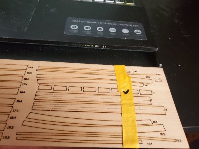

It's not mentioned in the instructions, but there are 2 templates. One goes on the bottom and one goes on the back and they will give you the taper. :)
They are L6-1 and L6-2
