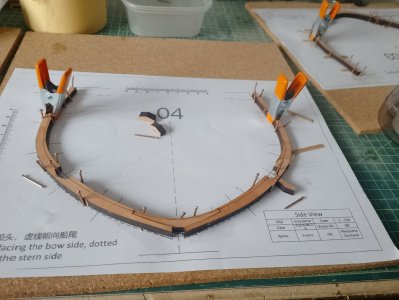

Not sure if you are talking Stern or Frames
But its bit late now its all stuck
Note ive still got to lift the upper frames in and ive moved 04 (second picture ) down slighly so it lines up with the dashes
Its also too late for the stern as its also glued up
Could have given me a clue as i will not be able to sleep
The stern section looks Ok, it's the frame. Zooming in on your photos, I see that you have put the wrong chocks in. Also you are offsetting the pieces. Each piece or futtock should be directly over the drawing for both A and B side. They fit exactly over their place on the drawing. The line in the chock is the sanding line and should correspond with the sanding line on the pieces each side of the chock, it is not the outside edge, so you have glued the chock meant to go on side B on side A. Every chock has it's own place. Also I didn't say NOT to sand the char at the joints but just be careful not to take too much off that you change the shape of the joint surfaces. You have to clean also the surfaces that butt on to the keel. I have to go out now. Do you want me to go through the make up of a complete frame when I get home later or are you OK with it? This kit is very detailed and so quite complex, certainly the most difficult of the ones I have made. You have to concentrate and have an idea of what you're doing

I dont think i explained properly what i am now doing
I found that when i built a full frame parts move so
a) I got these new clamps (to me) from Amazon
I then do 1 joint each side putting a set i 1mm spare pieces under when needed build
Usually the top 2 pieces are actually the same size so those I build flat and join lifting them after they are dry with the spare pieces
Using Titebound with the clamps now works really well and ive had no movement
I did post a picture with the lower part of no 4 slightly too high and when i put down the upper row it was obvious (Now Corrected)
Sorry if i confused
Note the spare pieces ready to lift the upper parts
REally cant recommend the clamps better

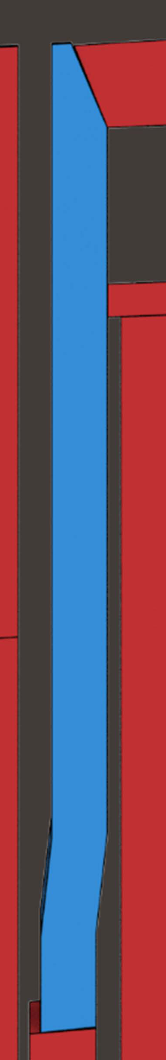

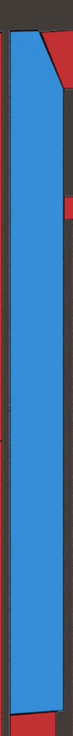

02 with the long upper part is THicker than the lower one - JUst doesnt seem right
But will LATER check to make sure ive got the right part
I don't see a part labeled O2 and I looked throughout the entire instructions and don''t see an O2, so I don't know what you are talking about.
sorry its frame 02 the top long top part of the front of the frame see photo sent private message
Shows how important it is to use the right terminology
Oh, it is correct on the plans. You will notice quite a few of them in the build because that piece needs to support one side of a gun port frame. They actually shaped it a little bit on the real ship is in this image. Look at step 26 in the instructions. :)
But if you look at the bottom of the above picture the blue part is thinner the the red one below it
Why is My "Blue" part of the frame 7mm
Will check the other parts on that sheet to se if they are correct (Tomorrow)
But yes I see that on 26 It is wider and it is 7mm
