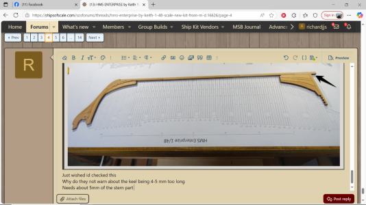

I think you'll find that picture is from my build. I don't know why Richard is showing this?
Because i was asking a question as to why its too long and your picture showed it best

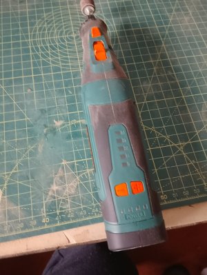

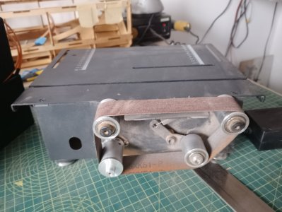

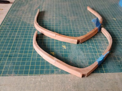

# 106. Your image shows IMHO potential for major pitfalls.
#1 that large chip out of frame bottom….unless you find broken piece or sand glue and trim replacement it will not tightly fit keel and show as a glaring gap.
#2 it appears the notches are sanded to the point of notch being well over 90 deg…..see #1.
Those are important joints to fit keel well and anything less than tight will jump right out. Better you know now the risk further frames with issues.
Some areas can be masked by future steps…..these cannot.
