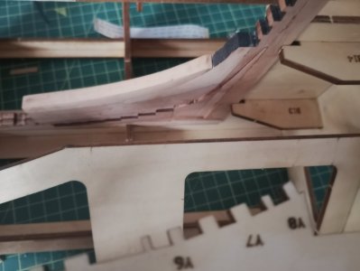

Some builders would not consider this important, others do, but it is your model, so go with what you want. The keel is tapered forward and aft with the dimensions you show above. Keep in mind that if you ignore the actual dimensions of the keel but the knee of the head is properly tapered it will not match up with the boxing joint, and if you taper the stern post properly but not the keel, there will be a shelf on top of the keel at the post.
Your model, your call.
Hi Richard,
Totally Agree Ive Not tapered the Keel at the bow - still waiting for replacement parts for Knee
Photo shows Stern Keel where it does have a shelf but told not too worry
Might just taper the stern of the Keel before i finally fix te Ribs

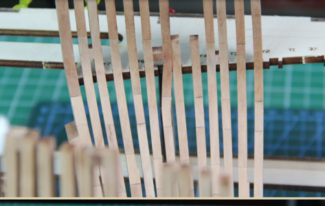

Really getting on with the Ribs
By weekend 1 - 17 will be completed (except 15 Waiting for new upper Futtock
Hopefully ive got over the problem of joint snapping - really strange as ive use Titebond Ultimate ! (Always 24 hours before the next stage)
Will drop 15 in to make sure it all fits before building 18 - 37
It is much easier on the middle ribd with little or not much to remove other than the chard (Waiting for the stern ones!!
For those following my build make sure you remove the Black chard on the slot that goes into the keel BEFORE fixing them together
I know my learned colleagues will do that but just a suggestion
Again ive found very thin Tamiya type tape holds the lower section of the front and back frame together while it set allow a little adjusting of the upper frames

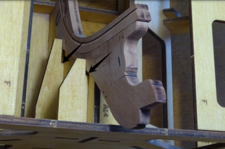

A couple of questions about this so far
A) It looks like KEEF has a slight gap between the front of the Bow and the Frame (First PIcture) I have similar although the Keel is Exactly placed on the Plan
B) You see he has placed the ODD numbered Cant X frames in first and the na added the Rear EVEN frames ois this what you recommend

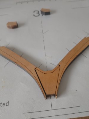

Getting close to that magic number 37
So once fitted about 5% through the Build !¬!!!!
I love the accuracy of everything
Will NOT miss getting rid of the Chard and shaping the frames playing havoc with my breathing Yes I am using a mask
