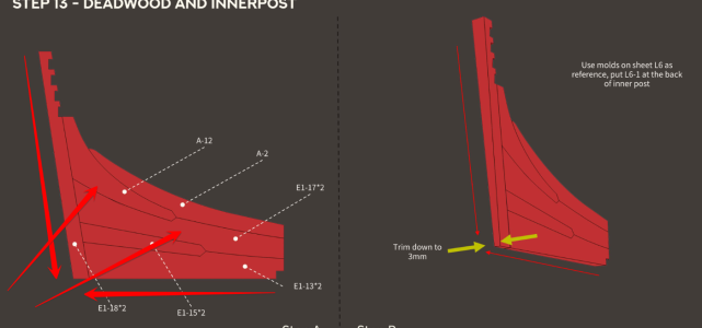

It's not mentioned in the instructions, but there are 2 templates. One goes on the bottom and one goes on the back and they will give you the taper. :)
They are L6-1 and L6-2

The whole deadwood is tapered, top to bottom back to front using the parts L6 1 and 2 as a guide. Put L6 1 on the stern post and L6 2 along the bottom and sand to the lines showing the taper
I do understand about the trimming this was not what i wanted its how far into the deadwood the tapering goes
Is it just that section ie E1-15 (2) and E1-13(2) or does it gradually go int dead wood

Yes. It goes all the way into the deadwood from top to bottom and front to back. A very slight taper.
only taper it with the parts shown in step 13. You will add more parts in the next step and put a slight taper into those as well. :)

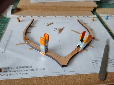

I used the idea of Selletape ove the joints quite useful
BUT I had problems with the joint not sticking properly
SO now ive gone cack to what i did on Blandford
Ive taken Photocopies of all 37 Sheets and put them in the sleeves that are used in Folders
A thick Cork Tiles under each sheet
Fix in each corner with a Map Pin
And then used excessive glue on each joint
AS Keef recommended fixed each separate piece and allowed to set
Although it takes a bit more time it really woks for me
Since doing this ive really got going with the frames

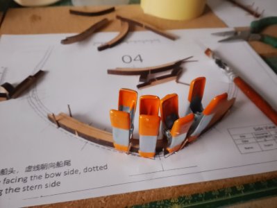

Found some great clamps for the Frames
Been having problems with the Glue but have stopped Cleaning up the Joints and glue both parts and use Keef's idea of Sellotape then clamp
I am doing 1 pair of joints at a time and letting it set
Seems like its really strong

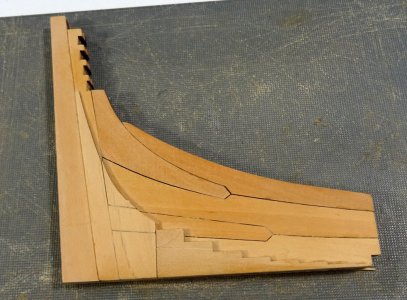

AS you know ive not been sure about the Stern Deadwood
I know i was not sure about how far into the deadwood i should trim the stern and deadwood
The frames Y1 - Y8 Must lie flat and as we get nearer the stern the gap between the top of Y frames is 8mm (is same as the Deadwood
but it narrows at the lower part the nearer the stern we get
Y8 is about 6mm so that part of the deadwood needs to be 6mm (Tapering up to 8mm
Took all this into consideration as i sandpapered the deadwood
Incidentally the 1 and 2 jigs are over 3mm and need a bit of triming

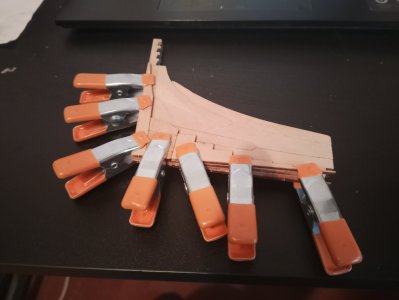

Ive tapered the keel and fitted the parts G1 G8 9 and waiting for it to dry
and then taper to 4 mm
It looks good so far

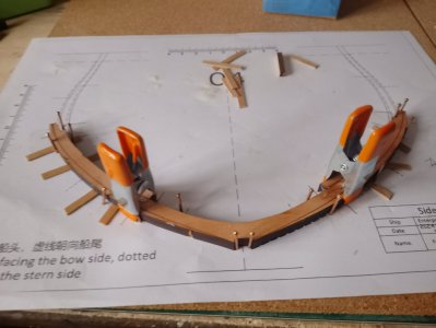

Note ive still got to lift the upper frames in and ive moved 04 (second picture ) down slighly so it lines up with the dashes
Its also too late for the stern as its also glued up
