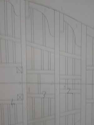

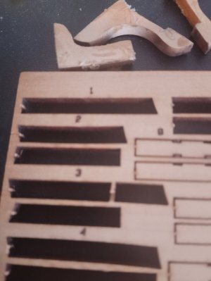

OK So decided to do a few of the Gun Deck Carling
F3 3 (three parts) are too short Next few "Seem" Ok any ideas please
Looks like 3 will Fit 7 and 7 will fit 3

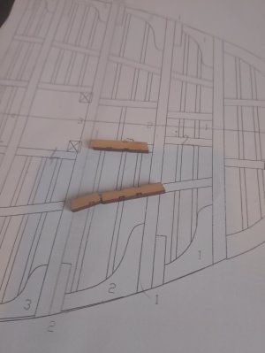

Check your part #'s, I'm about 1/2 way done from bow, I don't think any were short. All moderately long.
make sure your deck beams are fit/spaced properly.
Tim

if you look at the last photo it shows the three parts 3 and the plan - nothing fits its too small ~~
Rest but will check
Richard, appears you have incorrect carlings based on slots for cross pieces.
I am past this but cannot recall mismatches with slots.

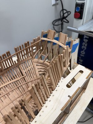

Good afternoon Jeff. All looking mighty fine. Those stern timbers are not easy - kudos. Cheers Grant
Thanks Grant. I appreciate you comment more than you know. I think it would be better if the instructions provided more guidance on exactly where they get installed. Maybe have a template to make sure they are in the right place so they align with the stern facia piece. :)
