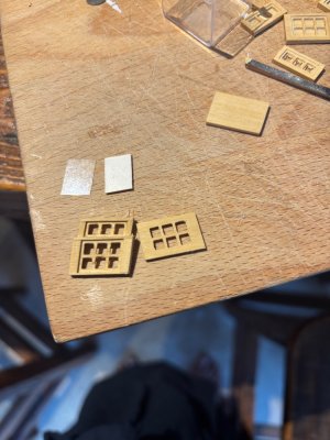

I decided it was time to re glue my stern timbers on for the third time:p. I absolutely know I will break them again so to strengthen them the windows and supports are to be done.
Whew this takes a long time………
I decided I am going to build this as per the kit with some of Grants creations.
Stern timbers with the inner window guides:
I added some walnut panels to the “guides” to keep the aesthetics of my cabin.
Windows. The kit windows are very cool boxwood. It takes a minute to cut these out and clean up. The inner side does chip so for my other windows I need to find another way of cutting these out.

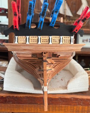

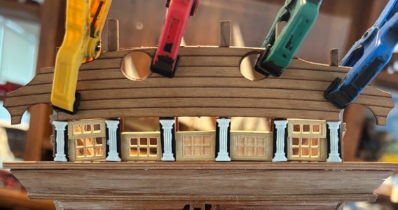

Good afternoon everyone.
Just a quick post. My windows are slowly coming together. Again prestick and clamps hold it together.
So much fine tuning to do but I think I will get this- plenty mods from kit which in hindsight made my life difficult :oops:.
I’m not so sure about the cabin side…..may rework this.
Prestick the pillars
The black is very prominent however there are a gazillion boxwood decorations to add so I think will look cool.
At least my stern timers will no longer get snapped off when I am doneROTF.
Cheers Grant

Maybe the mods made your life difficult, but the results are turning out excellent !
Thank you Jeff. I sometimes think it would have been better to copy the actual design of this ship than try and modify the kit. My stern timbers kept breaking even though I was acutely aware of these. Whew I will get it right sometime ROTF. Cheers Grant

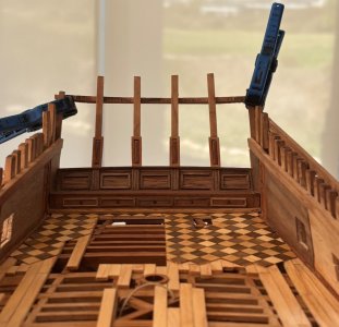

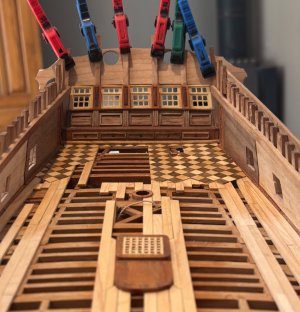

Good morning Gentlemen.
Some more refinement.
The over hang by the top of the windows was too much. I wasn’t going to use the CNC cut and pretend planking from the kit and my 1mm planks I used where too thick.
Cut some 4mm planks from some veneer I bought for the base stand, stuck the old part in boiling water, ripped the old planks and redid with cherry veneer.
I also decided not to paint. I think the boxwood decorations and oiled cherry will look way better and fit my mostly wood build.
Bent this again:
Cool clampsROTF
Where I am at now. Some more refinement to do however I am encouraged with the
