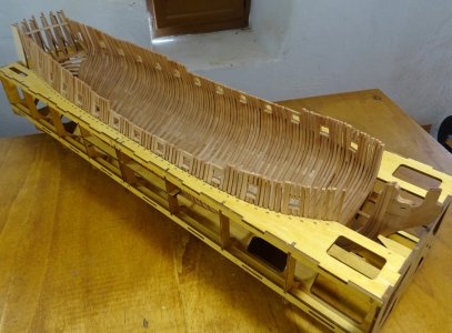

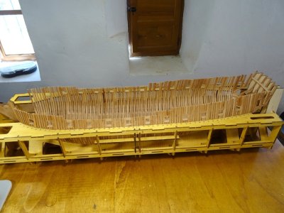

Thank you for your kind thoughts. I have given some thought to the finished construction and have decided to plank the hull only down to the wales, port and straboard, leaving all the lower frames and keel exposed. All the deck timbers will be left exposed, except maybe half planking of the lower decks to facilitate the mounting of the cabin walls and bulkheads. I am glad you have plans to build this excellent kit. It is not difficult at all to change from POB to POF, just more woodwork involved but less rigging . I wish you well with your present Victory project. It is a great subject

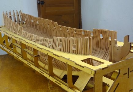

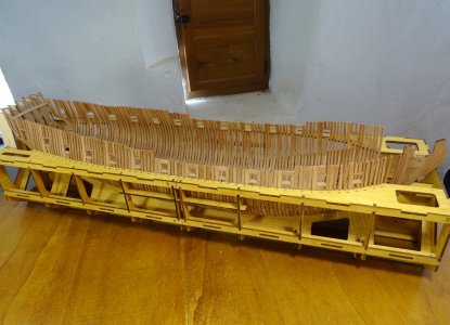

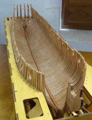

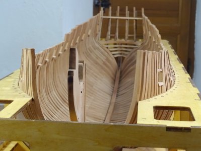

It has been a while since I last posted. That's because there is not really much to see. I have added the keelson, which fitted perfectly and also trimmed the frames to their correct heights, a time consuming task with little visual effect but I think it has cleaned up the shape of the hull rather well. I got the heights by measuring the depth of the jig in relation to the bottom of the keel and transferring this position onto the 1:1 drawing. Then it was a matter of taking the height of each frame. The amount of trimming needed varied from around 4 to 6 mm at the bow and stern to only up to 2 mm above the mid ship gun ports
that going to be a beautiful hull of the ship, well done Keef :)
That’s looking very nice, Keith. Although it looks a small step, for sure it’s time consuming.
Everything is looking really good. The fairing is extremely smooth.
Hard to tell how much taper on the knee of the head that you did from the photos but thought the following from the contract might be of interest.
The knee of the head to extend to the upper side of the upper cheek, to be 11¾ ins thick at the stem and 6 ins at the fore end

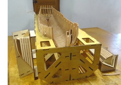

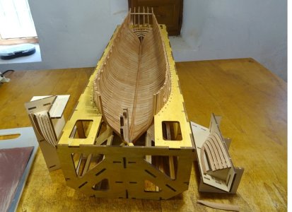

Jig parts B17a, b and c have been added to the cradle to support the counter timbers. The outer timbers, port and stbd are made up of 2 parts and sanded to form the fashion pieces, I think they're called. A cross frame, which took a very small amount of adjustment has also been fitted which I hope will give a little more support to what could be a very easily knocked and broken assembly
Where do we get the height of the Cross Member on the stern please
