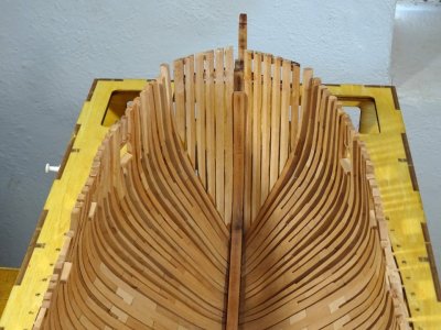

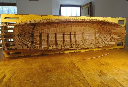

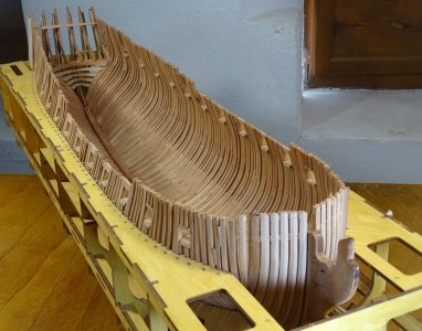

A quick follow up from yesterday. Once the glue had cured, the port side hawse pieces were fitted, completing this part of the build and closing the shape of hull. I am very pleased with the result and admit to being quite happy to get this part out of the way. On to the next step that will be marking the positions for the thick stuff and deck clamps
Congratulations with this milestone, Keith. The fitting of all those hull parts looks very nice!
As always Keith, you are owning this Enterprise. Cheers Grant

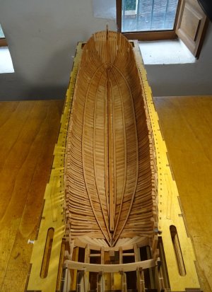

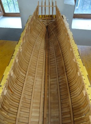

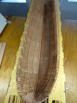

Hi All. This stage in the build is beginning of the insertion of the inner planks, thick stuff and deck clamps. Each are made up of 6 lengths, stretching from stem to stern and to get the correct positions of the pieces, the kit supplies plywood jigs marked with a corresponding rib number. These are each fitted over the keelson with the plank position marked along its length. A great idea from M.D. Quite a few more to go, so will keep you informed as I commence
Great to see you back at it. :)
What a super idea! Even if the hull is a tiny bit out of square these will make sure the deck clamps will be in the right place along the length of the hull which is super critical to having the deck and subsequently the gun ports at the right elevation. Thanks for sharing this, it can be useful with any POF build.
True story. I wish I had these......
Good morning Keith. Such good work. This is going to be a "classic". Cheers Grant
I will say, since now I have fit, at least partial beams on all decks.....all beams on lower deck, using the jigs worked out better than I would have expected.
The beams are very close to being dead level fore and aft requiring only modest sanding on minor high spots.
The gun deck, which I have about 1/2 beams seems to be fairly close relative to ports so far.
I've gone this route primarily to check important spacing for all in case I needed to tear out/rebuild anything.......so far pretty straight forward.

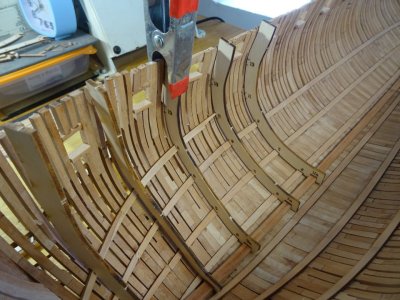

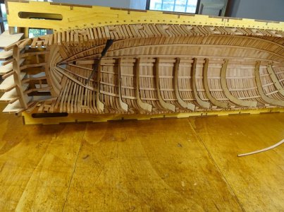

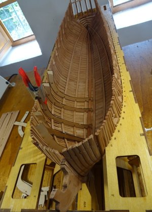

Just to keep myself in touch, the first side of the lower deck clamps are being installed, showing some of the plywood jigs marking the positions of the planks. There is some tight bending of the pieces needed at the stern and bow
Perfect Keith. Oh boy all kits should include those jigs. I had many interesting moments trying to get my beams right....and as I build I am noticing some tiny deviations (nothing which is visibly noticable) but having that jig is a must. Kudos with your Enterprise, so far it is superb. Cheers Grant
