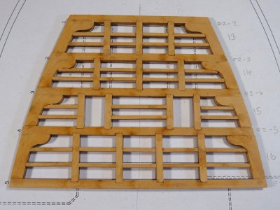

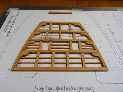

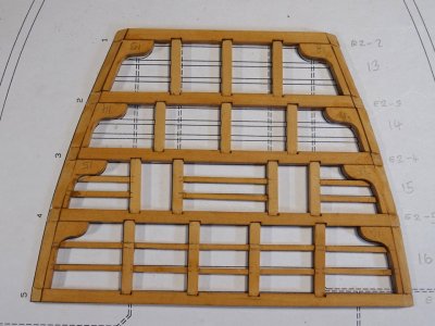

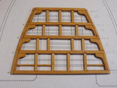

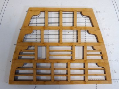

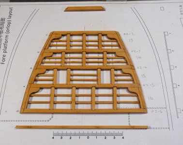

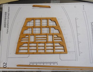

Moving on now to the first of the deck timbers. This is the fore platform or orlop deck. It is built directly over the plan provided. It has to be built upside down on the plan as the frame, cross beams and carlings are all different thicknesses, and this way ensures they all line up on the upper surface. I am now back to doing what I love

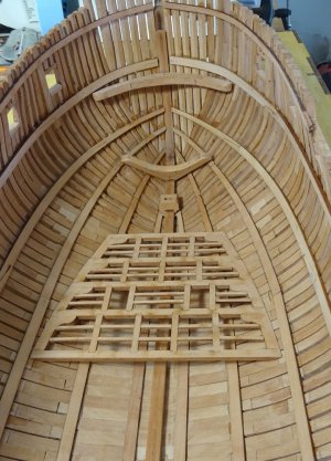

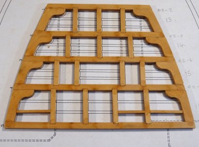

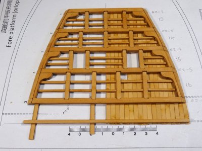

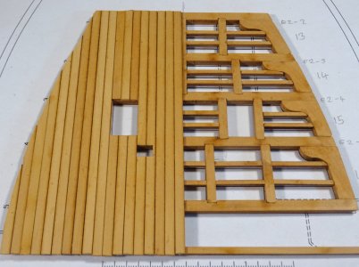

Hi all. This afternoon I am finishing off the fore orlop deck timbers and as the instruction manual suggests, I have laid the deck planks over half of it. The cabin bulkheads are the next details to be made on this section of the model, which I intend doing before installing the complete assembly into the hull structure
