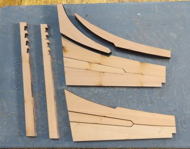

HMS ENTERPRISE by Keith 1:48 scale. New Kit from M.D.

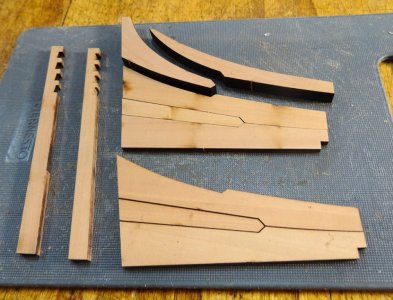

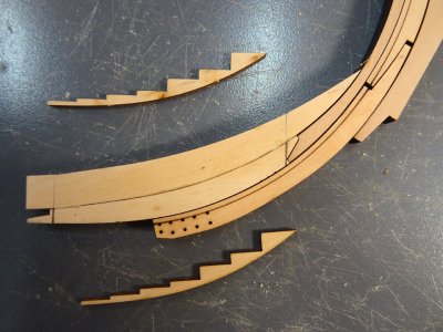

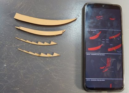

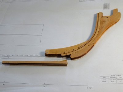

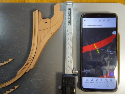

The cutwatwer is glued together and has to be tapered at the head to a thickness of 4 to 4.5 mm. The keel timbers are 8 mm thick, so for ease of handling it will done at this stage before joining to the rest of the keel. In the meantime I have identified and placed some of the timbers that make up the front deadwood and apron. The dead wood is made up of 4 parts glued together to form one piece. The centre portion has to be tapered, sanded down to 3 mm at the lower edge and the supports for the front cant frames will be fitted this portion. The instruction manual is download on the internet in pdf form which I have on my phone to follow

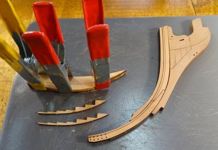

You are working really fast ! and with great accuracy. I just finished the stem structure in my build. I had a lot of fun ? sanding down the deadwater (apron) to 3mm at the base. I will not install it yet, but wait until I join the stem structure to the keel. I should finish the whole keel by next week and also start building the jig. Since the shipyard is in Houston, about as humid as Sevilla I'll varnish the jig with Tung oil also ! Thanks. Gracias....Donde viveis ?

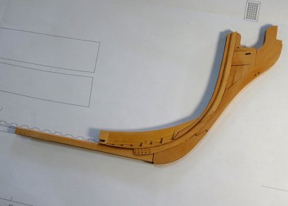

Hi Alex. Thanks for your comments. I have finished in my workshop for the day and I am halfway through sanding the deadwater. What a job! Hopefully will post the result tomorrow or the day after. I am enjoying this kit immensely and wish you the very best with your build which is slightly ahead of mine and I'm following your log with great interest. Keep up the great work.
As for your question, I live in Andalusia on the Costa del Sol, North West of Malaga.

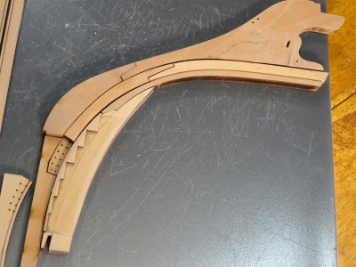

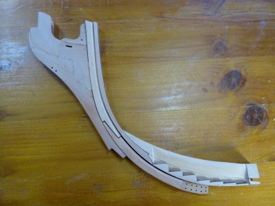

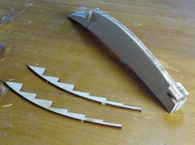

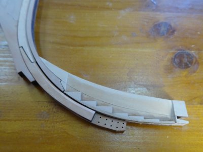

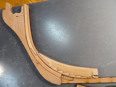

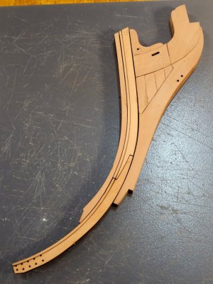

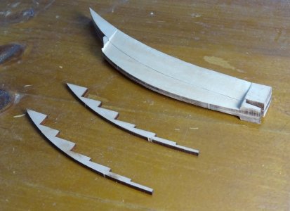

The job I wasn't looking forward to is done. The filing out of the front deadwood to take the cant frame supports. It was time consuming, but actually not as hard as l thought it was going to be and worked out quite well. I am working on cutting out the rabets on the keel pieces, using a file and side scraping with a modelling knife blade along the laser guide lines at a 45 degree angle. The pieces are dry fitted in these photos and all seem to fit perfectly

That looks great ! I will see mine in a little bit when I take off all the clamps. :D
Looking really good. I also sanded down the keel deadwood yesterday, but I'm not installing the cant frame supports on it or the stern deadwood assembly until I can get the keel structure vertical. Today I glued the false keel pieces together-a simple scarph joint. About to glue the false keel in, then rabbet and go vertical to install stern structure and forward cant frame supports.

Good evening Keith. I’m with Allan - Kudos. The cant frame deadwood is excellent - super accurate. Cheers Grant

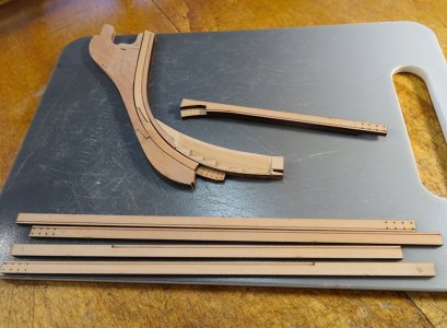

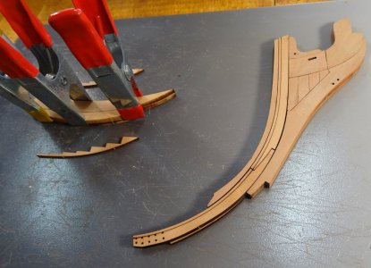

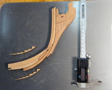

The bow structure (cutwater, deadwood and apron) are now assembled and fit perfectly with the 1:1 drawing. The keel sections are also assembled and the rabets cut. The 3 sections just need to be glued together and the false keel added. Meanwhile I have identified the parts for the stern deadwood and inner sternpost. With a little sanding it all looks like it will fit together perfectly, as the front end
