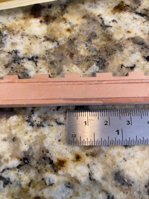

When making up my false keel I made stepped scarf joints. Only took about 15 or 20 minutes to make up with an x-acto knife and a file. As you can see though I installed them upside down. As an old friend once told me; “a dumb man won’t notice and a smart man won’t tell”.Thank you Jeff. As is yours. Have you decided how you are going to prepare your false keel joints. I'm just making a 45 degree scarf at each joint for ease. After sanding nobody is going to see it. I build for pleasure and not worried about 100% historical accuracy, as long as l think it looks OK![]()

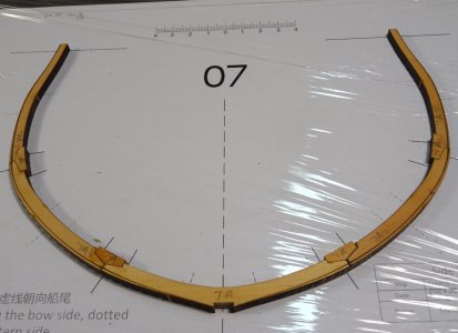

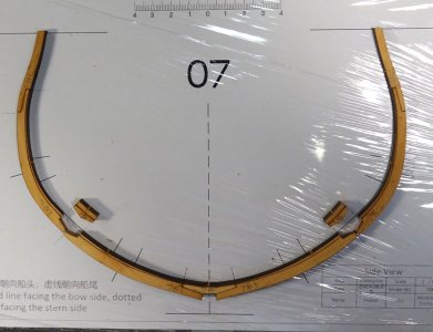

Also here the big step of making the first frame. Yours is also looking very promising, Keef.some photos of my first frame (no. 7). To protect the drawing which has to be used for both side A and side B, I have used clingfilm to cover it. The photo shows side A complete and side B pieces just laid over the drawing before gluing
She is looking wonderful !some photos of my first frame (no. 7). To protect the drawing which has to be used for both side A and side B, I have used clingfilm to cover it. The photo shows side A complete and side B pieces just laid over the drawing before gluing
