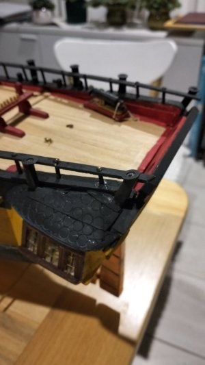

Interesting to see hammock cranes on the breast-rail. Nicely fabricated - just unexpected for me (which is entirely a reflection of my ignorance about all things nautical).

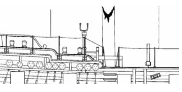

You may be right, Paul. My gut feeling was that most captains would not tolerate the cranes in their faces and I don't see them in any contemporary paintings I have found. They don't make sense to me, unless the captain was in the habit of hiding behind the hammocks during battle, which flies in the face of modern perceptions about how officers carried themselves during battle.
The plans I have are basic at best; an early attempt at the Enterprise class which CAF etc produced as kits. If you look at some of the completed kits they show the cranes there. Personally, I think they are a mistake and I am already tempted to cut them off. The exercise was worth it anyway because I proved that my two smaller soldering irons were dead and my old Weller needs new tips, so I've ordered those.

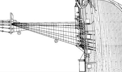

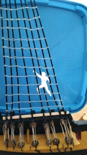

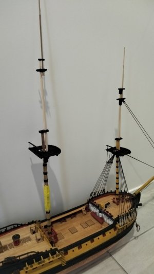

A point on the ratlines, hope you don't mind. What is the distance between rows of ratlines, it is hard to tell from the photos. At your scale they would be 0.27" to 0.3" apart. Also, from James Lees' The Masting and Rigging English Ships of War, page 44, after 1773 the bottom six rows and top six rows of ratlines ended at the second shroud from forward and ended at the second shroud from aft on English ships. There are some contemporary models that have a variation of this where the bottom four or five only go to the forward most and aft most shrouds, and then to the forward most and aft most every three or four rows.

My main printed reference has been Petersson Rigging Period Ship Models, based mainly on the fact that he used a model of Malampus, in the Bristol Museum built by the builder of the original ship, James Hillhouse. A model of the Medea (also built by Mr Hillhouse), is also held in the museum.
Although my ratlines are a work in progress they are as close as possible to 18" apart, or .375" in scale (as per the plans). But that is too wide for my Footless and Free-falling landsman so I will reduce them on the re-do.
As always, thanks for taking the time to add your informative comments.
You have a lot of agreement and respect for your decision to redo them. I would bet you will be very happy with your decision.

Why not use the original plans for the Enterprise class, of which Medea is one? There is a full set in high resolution on the Wiki Commons site. Just be careful not to use the ones that are Enterprise after she was converted to a prison/holding hulk for kidnapped men being pressed into the navy. Low res versions are on the RMG Collections site as well. https://www.rmg.co.uk/collections/objects/search/Medea 28 gun
Thanks again Allan,
The ones I downloaded from Wiki Commons didn't show the rigging. I'll have another look as Wiki is updated regularly and perhaps there is more there than when I last looked.

Their plans for Enterprise and family are the RMG plans in high res but rigging plans are rare for any ship in any era. Studying rigged contemporary models are probably the best things to follow or the information in James Lees' book. Marquardt's book is useful but limited. He acknowledges the specs on rope and such are from David Steel's work which is free online anyway. His drawings are quite good but the print is so small, these old eyes need larger magnification reading glasses to use it :(.

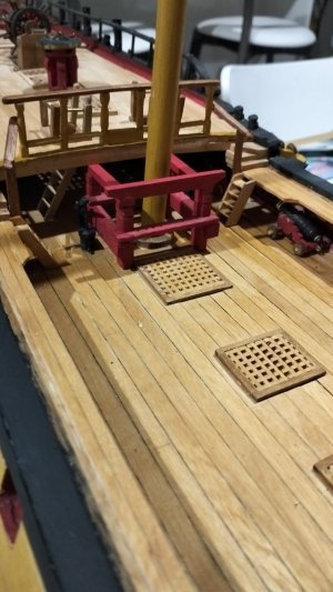

First, I decided to tear down the breastwork and do it again with better timber and no hammock cranes. The cranes were inappropriate in my opinion and I doubt that my Captain Gower would have tolerated them.
The timber is Queensland Maple and polishes up with a rich glow with 50/50 linseed oil and turpentine.
I added steps and handrails down to the waist.

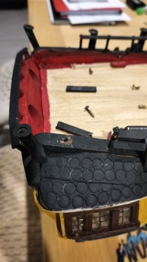

Next I set about doing some repairs. The rails near the stern were broken so I fixed those.

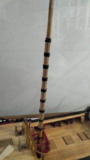

Moving on to the main mast, I built it up to its correct diameter with hoops and (panels?), adding two extra fishes which I knew the ship had fitted in India in 1783 after the mast began to crack.
Just dry fitted at this stage.

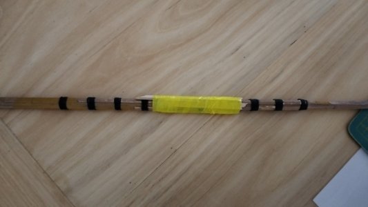

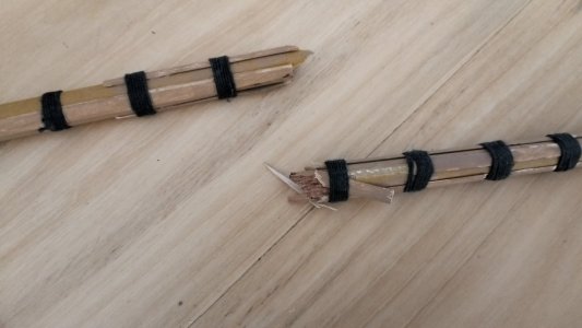

The reason for all the dry fitting of the main mast, tops etc is that I could remove it all for the first real step of the diorama.
The bare mast was removed and a sleeve of plastic plumbing pipe was slid on each end to meet at the appropriate position. A quick twist (heart in mouth!!), a loud crack and the mast was splintered right at the spot I wanted.
I then packed some wooden 'splints' around the break and taped it back together as a temporary measure.
All the parts were then fitted and glued and the mast stepped permanently.

The diorama will start taking place from now on as I add the many details I need in place before sending the Main and Mizzen crashing down over the port side.
