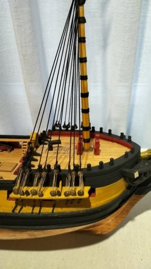

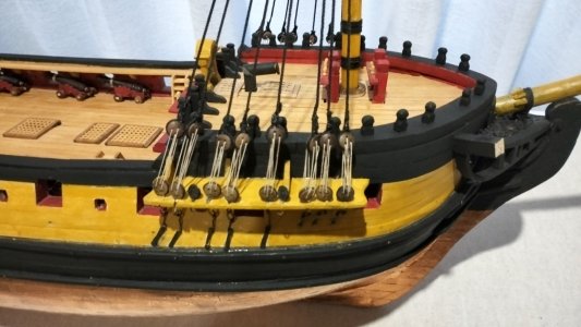

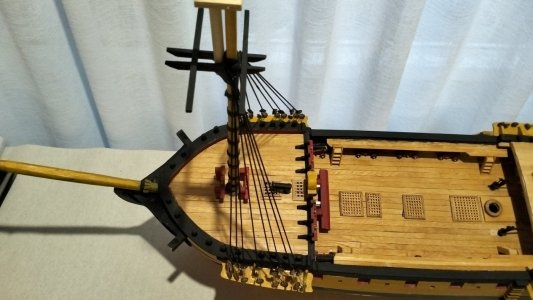

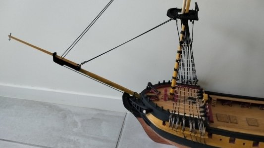

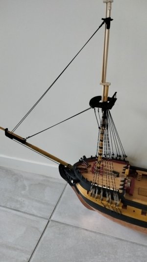

A long time between drinks, but I have been busy making chain plates, rope and preparing for the shrouds on the foremast. There is quite a story behind my beginning the rigging and I will relate it in a day or two. ;)
Not museum quality but my first (and probably last) attempt and I have enough confidence now to continue until the foremast is fully rigged.
I tried really hard to do the lashing above each deadeye but with .25mm poly thread required for the scale it was taking me too many tear downs and re-does and in the finish I resorted to super glue and now I have asthma again (despite wearing PPE). I worked on trying to get the deadeyes level as well, but in the end I had to accept that with a working ship at sea there would ultimately be differences in height due to stretching of shrouds over time.

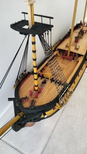

Next job is the spreaders (?) for the shrouds and then the hundreds of clove hitches for the ratlines.

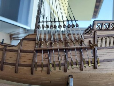

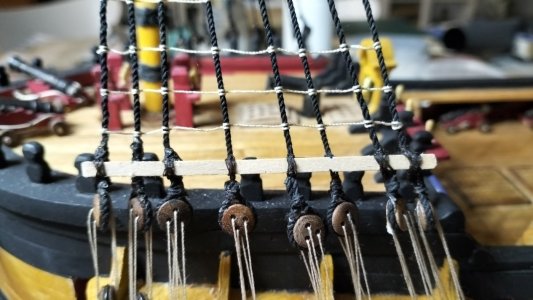

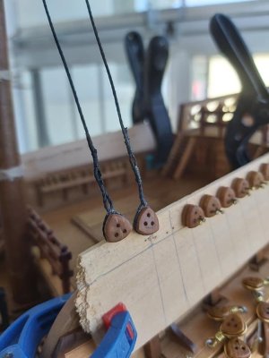

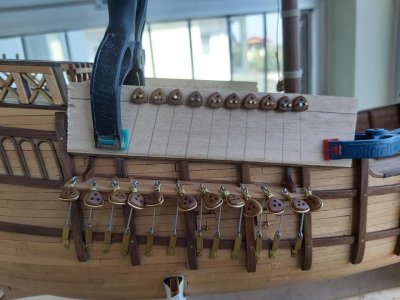

I use the jig in the photo to keep the deadeyes in line. I nail the deadeyes to the jig and tie the shrouds to the deadeyes in this position and then remove the tied deadeye from the jig. You can try this jig on main and mizzen mast.
That looks like a great idea. It would certainly have helped me and I can see how it would have helped with the lacing as well. Thanks for sharing. In fact, I think I might even do the foremast again if my effort annoys me enough!!
