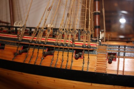

A long time between drinks, but I have been busy making chain plates, rope and preparing for the shrouds on the foremast. There is quite a story behind my beginning the rigging and I will relate it in a day or two. ;)
Not museum quality but my first (and probably last) attempt and I have enough confidence now to continue until the foremast is fully rigged.
I tried really hard to do the lashing above each deadeye but with .25mm poly thread required for the scale it was taking me too many tear downs and re-does and in the finish I resorted to super glue and now I have asthma again (despite wearing PPE). I worked on trying to get the deadeyes level as well, but in the end I had to accept that with a working ship at sea there would ultimately be differences in height due to stretching of shrouds over time.
Next job is the spreaders (?) for the shrouds and then the hundreds of clove hitches for the ratlines.
I use the jig in the photo to keep the deadeyes in line. I nail the deadeyes to the jig and tie the shrouds to the deadeyes in this position and then remove the tied deadeye from the jig. You can try this jig on main and mizzen mast.
That looks like a great idea. It would certainly have helped me and I can see how it would have helped with the lacing as well. Thanks for sharing. In fact, I think I might even do the foremast again if my effort annoys me enough!!

In case you think I had died, I've finally got an update for my scratch built Medea.
I knew I would struggle with the rigging as I have little feeling in my hands and I'm still learning to use tweezers. (I never had these problems in my little blacksmith shop on the farm, but that might have contributed to my hand problems).
You will notice that the cathead is marked 'P' (the one on the other side is marked 'S'). This could denote Port and Starboard, but in my case it means 'Practice' and 'Satisfied'. Because I've never done any of this before, I practice on the Port side and once I've learnt a bit I do it on the Starboard side until I'm satisfied.
It all needs tightening up and a bit of dilute PVA to hold ropes in shape.
I really struggled with the ratlines but I think I can improve enough to do the Starboard side satisfactorily for viewing, and after that it will all be a tangle across the deck and over the side for the Main and Mizzen rigging.
IMG20251010212648.jpg A close up before the lashing was finished.
I'm going to attempt to re-do the dead-eyes on the Starboard side to get them nearer to level and lashed correctly. I seem to have lost my way with some of the lashings!!

If you are redoing the deadeye lines, look at the attached photo and consider using slightly larger diameter line. With my limited knowledge, intuition says the line you used is slightly smaller diameter than what should be used.
Another hint Uwe told me when I was rigging deadeyes was to file three small grooves for the lines to rest in.
I look forward to more posts on this wonderful build....we missed your updates!!!!

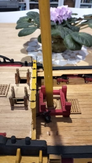

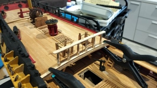

Another small (well 2 days of work!) update, to postpone getting on with the rigging. I had no plans whatsoever for this fitting except an end profile. Ugh!

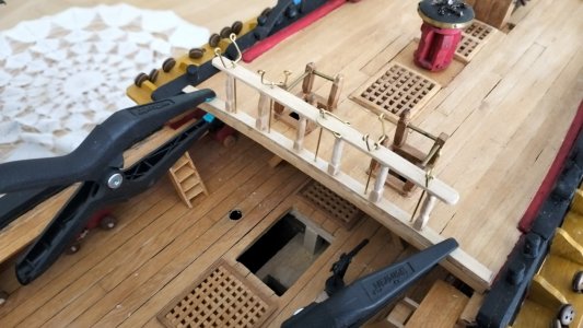

The breast-rail dry fitted.
Hummock cranes fashioned. The bosun found that the pump hadn't been glued in so that is a job for me after normal hours.

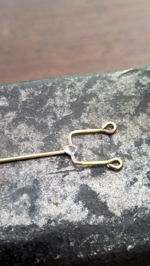

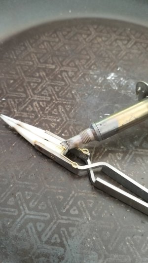

I found that by lying the cranes flat in the ceramic tongs I could solder the joint satisfactorily. But I have three defunct soldering irons so time to invest in parts for my Weller.
joint flattened on my mini anvil and then filed smooth.
Painted, blacked and ready for the netting (eventually).

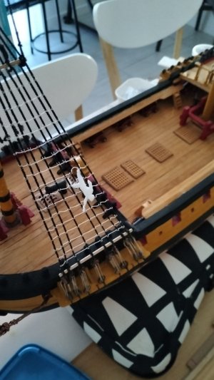

And a little taste of what's to come in the diorama. This poor landsman tried to climb the ratlines with no feet. Future efforts with my 3D printer might be better!
Enjoy
Hi Ian,
Love your scratch build!
A point on the ratlines, hope you don't mind. What is the distance between rows of ratlines, it is hard to tell from the photos. At your scale they would be 0.27" to 0.3" apart. Also, from James Lees' The Masting and Rigging English Ships of War, page 44, after 1773 the bottom six rows and top six rows of ratlines ended at the second shroud from forward and ended at the second shroud from aft on English ships. There are some contemporary models that have a variation of this where the bottom four or five only go to the forward most and aft most shrouds, and then to the forward most and aft most every three or four rows.
