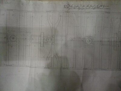

The museum curator who sent plans, replied they had no "actual" plans for the "unfortunate" ship Serapis but he sent the plans for Roebuck, which was the lead ship of thirteen 44 gun frigates, of which Roebuck was one. The plans list the thirteen shipyards the plans were delivered to and which ship each shipyard built. (see attached photo).
Mike Harris Campground.jpgRoebuck plans showing shipyard Chatham, England.jpg

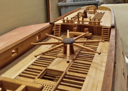

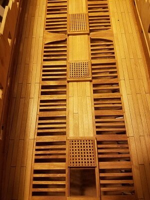

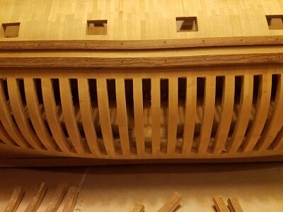

I decided to make the model in the Navy Board (Admiralty Board) style. After the 30 year break in work, I worked on the exterior hull planking and evened out the upper and lower lines, of each frame (1st photo). I also started to place deck planks on the lower gundeck, leaving the deck beams exposed (photo 2). . My plan is to use alder for the entire ship (with the exception of carvings, which will be boxwood). I plan to use 3 different WATCO oils (natural, light walnut, and dark walnut). In the below pictures, the rubbing strakes are dark walnut, the deck beams are light walnut and the deck planks natural). The reinforced (curved) beam is used, where the mast will go, to ensure the deck can support the cannons (3rd photo).

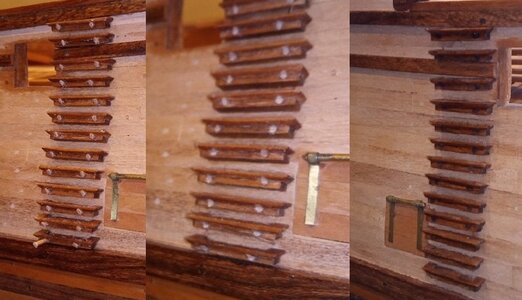

Some detailed pictures of the quarterdeck ladder building process. I made each step, then pegged it, using small dowels I fabricate by pulling small alder strips through a draw-plate (left photo). Then I trim the pegs and file them flush (middle photo). Finally stain with WATCO (dark walnut).quarterdeck rails montage.jpg

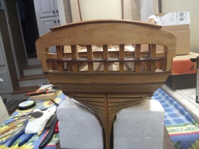

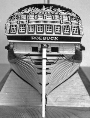

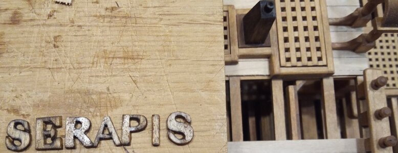

My next big step is working on the stern windows and balcony. I was lucky enough to find a great picture from a Russian Model Show of the Roebuck stern (photo 1). This is the effect I hope to accomplish. I've made all the spindles for the rails (tedious). Now I have to figure out how to recess the area between the 5 vertical beams and add a small curved extension for the deck. I'm also going to have to do my first experimentation with glass. I ordered some microscope slide covers. The second picture is how my stern looks right now. I did find another "easier" interpretation (picture 3) but it doesn't have the deck area between the middle 5 vertical beams. The high, vertical extension of the stern on the 1st photo is beautiful, but doesn't seem to agree with my interpretation of the plans, so mine will be lower, like the 3rd picture.
Roebuck stern2.jpg of the stern, but I like the idea of a small recessed deck on the upper level (photo 3). I'll keep you updated as I overcome each obstacle.

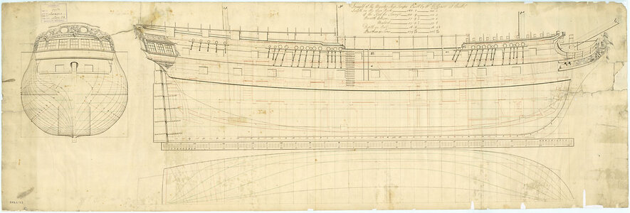

Hallo Brad alias @BradNSW ,
I am very happy to see, that you started the building log of your Serapis
Do you know the contemporary drawings of the HMS Serapis (1782), which aer available at the NMM.
Scale: 1:48. Plan showing the body plans with stern board decoration, sheer lines with inboard detail and figurehead, and longitudinal half-breadth for Serapis (1782), a 44-gun Fifth Rate, two-decker, as built at Bristol by Mr Hilhouse. The ship was completed at Hilhouse's yard in December 1782. Serapis had a single level of stern windows, unlike some of the others in the class, which had two tiers.
and also several deck plans
These drawings are maybe also of some help for you

Thank you Uwe, I have the full set of pans for Roebuck I ordered in the 1980s. At that time, they did not have plans for Serapis. Your plans show the single row of stern windows. THANK you...now I have some recalculating and more research to do!! I am working at 1:48, so it's fairly big. UPDATE: I just ordered the drawings of Serapis from Greenwich.
These plans also explain what another researcher, on another forum asked:
"Why did the log book of Serapis list her as 46 guns, vice 44".
I guessed the CAPT had added two stern guns/ports. These new plans you showed, confirm my guess.
I'm excitedly awaiting arrival of these plans, which will help immensely! Then, onto making modifications to my stern!
Both the Roebuck plans and the Serapis ones above, show what looks to be an (option to possibly add another (false?) deck, aft of the quarterdeck). The deck beams on the plans don't seem to be capable of holding the weight of an additional deck of cannons.
I've attached a contemporary oil painting of the battle that doesn't show any additional deck on the Serapis, so I don't believe it was incorporated in the build.serapis painting.jpg

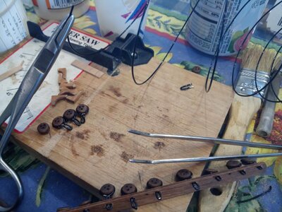

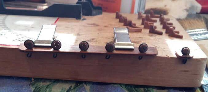

Finally got comfortable with a technique for wrapping the deadeyes, so I set up an assembly line and banged out 18 of the 70 some needed. There are two smaller sized deadeyes (about 20), for which I've ordered smaller diameter wire. Also shown in the photo are the small knees I will use to brace the deadeye rails. They will be pegged to the hull and the deadeye rails, once mounted, to add strength.Deadeye assembly line.jpg

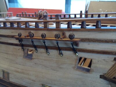

Mounted the first deadeye rail. Took a few tries to get the chain-stay links the correct length. Will have to paint the nail-heads black, do some touchup paint, where tweezers rubbed off the original black coating. I was intimidated by doing these parts, all from scratch but am satisfied with the results. Deadeyes are basswood. Everything else is alder. with either no stain, light walnut, or dark walnut.
mizzen mast deadeyes complete.jpgheads
