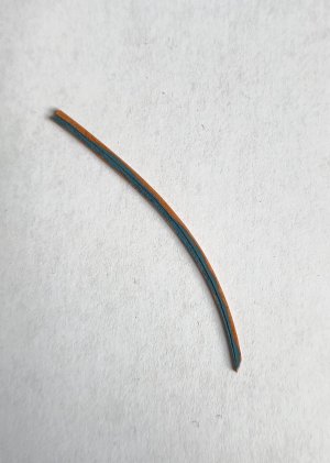

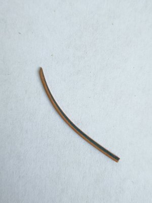

Thanks! It did wear out pretty fast, needed to change the side boards twice. And I glued two pin points in the bottom of the slot. Just sticking out a milimeter. This way the wood piece that you want to scrape doesn't slide. Ofcourse this must be a side you don't see because there are going to be 2 little dentsSuch a clever and simple scraping jig. I'll borrow that one for sure.

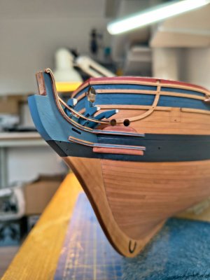

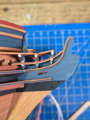

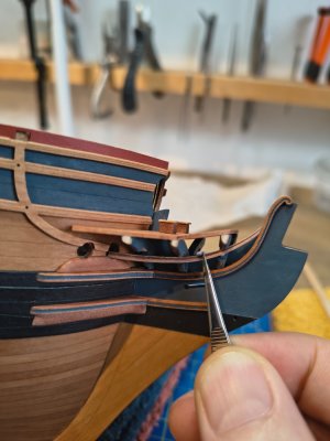

How did you do the curvy part that goes to the top of the stem?Thanks! It did wear out pretty fast, needed to change the side boards twice. And I glued two pin points in the bottom of the slot. Just sticking out a milimeter. This way the wood piece that you want to scrape doesn't slide. Ofcourse this must be a side you don't see because there are going to be 2 little dents
Oh that's part of the kit lasering. Pretty nice details that come with the kit. I think i have better pictures of that in the next update. Your work on the Kingfisher is simply amazing! Love that!How did you do the curvy part that goes to the top of the stem?

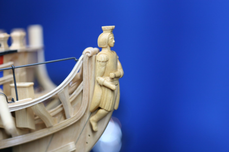

On my Kingfisher I created a double groove using a custom scraper (cutting one side at a time). I like your painted groove better.
Sorry to post my work on your thread. I'll remove it if you want.

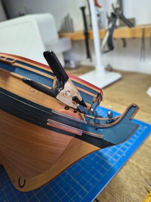

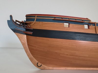

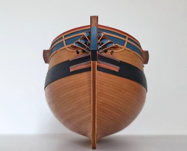

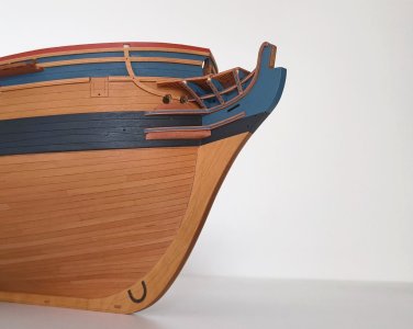

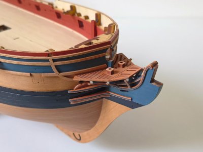

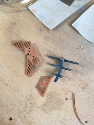

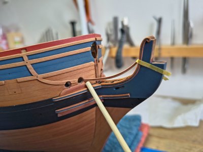

, going further with the headworks
