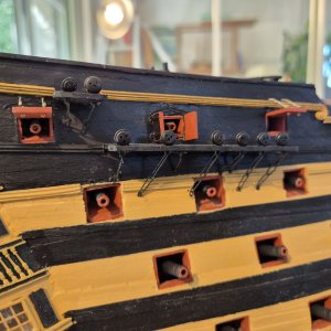

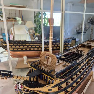

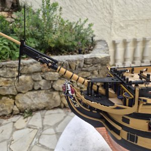

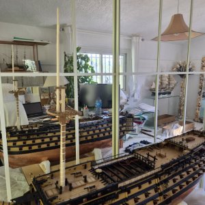

First thing I did this week was to install the hull decoraction. For the top rail, I used a thrid party rail rather than the brass rails provided in the kit. FOr the second (black) and third (ochre) rail, I used the kit provided profiles.
I then started to install the chainplates and struggled a lot connecting them to the channels (starboard side). It turns out that either the black stripe on the hull was too low or the channel was too high (which I don't believe) but in the end the third element of the chainplate that attaches to the deadeye and strop was too short by 1 or 2 mm. So I used 0.7mm brass wire to make this part a little bit longer and I soldered the wire, In the end the result is OK
View attachment 616665View attachment 616666View attachment 616667

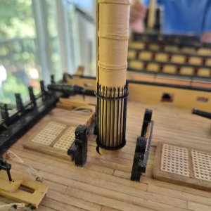

I also installed the poop deck barricade together with the buckets.
View attachment 616673View attachment 616674
Let's now move to the chainplates on the port side ...

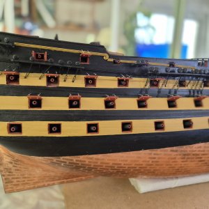

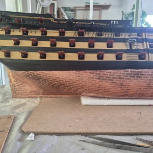

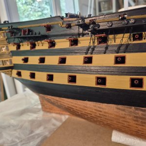

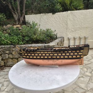

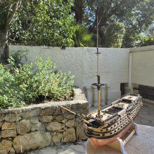

This week I started installing the gun port lids on the starboard side. This is quite a lengthy process and at this stage I have only completed the aft portion.
It's not difficult but long and repetitive.
I had to adjust some of the chainplates as they interfered with the lids.
Pictures below
Quarterdeck
Upper gun deck
Middle gun deck
Lower gun deck
Let's now continue and move to the starboard fore part ......![]()
