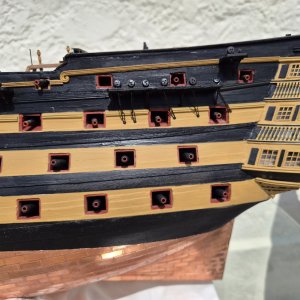

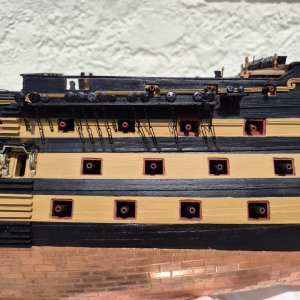

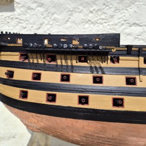

First thing I did this week was to install the hull decoraction. For the top rail, I used a thrid party rail rather than the brass rails provided in the kit. FOr the second (black) and third (ochre) rail, I used the kit provided profiles.
I then started to install the chainplates and struggled a lot connecting them to the channels (starboard side). It turns out that either the black stripe on the hull was too low or the channel was too high (which I don't believe) but in the end the third element of the chainplate that attaches to the deadeye and strop was too short by 1 or 2 mm. So I used 0.7mm brass wire to make this part a little bit longer and I soldered the wire, In the end the result is OK
View attachment 616665View attachment 616666View attachment 616667

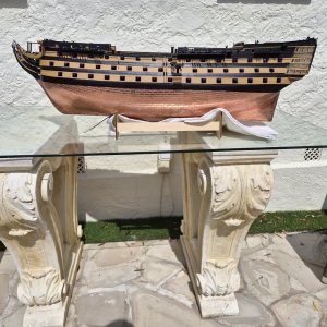

I also installed the poop deck barricade together with the buckets.
View attachment 616673View attachment 616674
