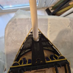

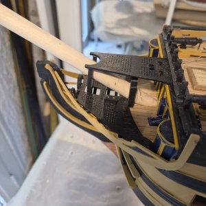

I completed the bow and added the bow gratings. At this stage I have not yet added the 2 boomkins.
I have ordered 3d printed figurehead components and shall work on that once received. I believe they are higher quality than the metal ones included in the kit.

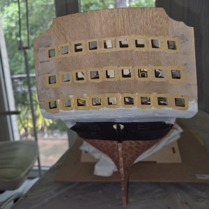

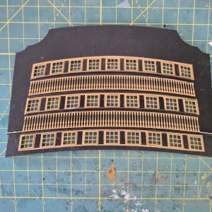

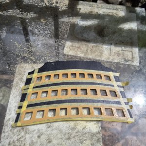

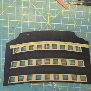

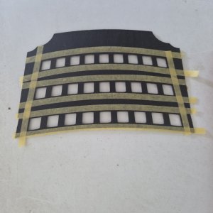

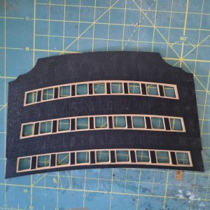

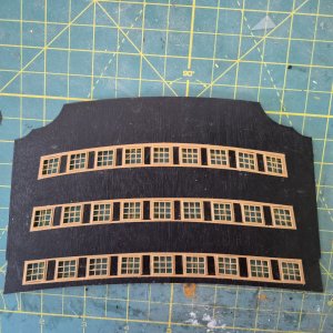

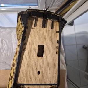

I started the planking of the poop deck but have postponed the completion since I needed to include the wires for the 3 stern lanterns that should be added to the stern fascia. These wires are under the poop deck. I therefore decided to start working on the stern fascia.
Rather than installing
Pictures below
20260504_141251.jpg20260505_164029.jpg20260506_121150.jpg20260506_174910.jpg20260507_194446.jpg20260508_163437.jpg20260508_183500.jpg20260509_162736.jpg20260510_122327.jpg
I have ordered very thin wires that could pass thru the small brass tube that will hold the lanterns.
Pictures below
View attachment 600968View attachment 600969View attachment 600970View attachment 600971View attachment 600972View attachment 600973View attachment 600974View attachment 600975View attachment 600976

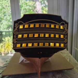

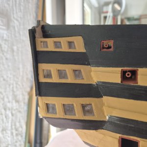

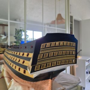

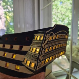

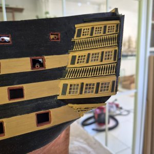

Hello friends

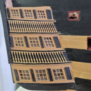

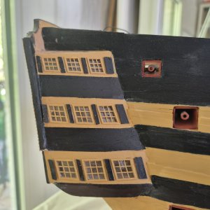

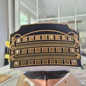

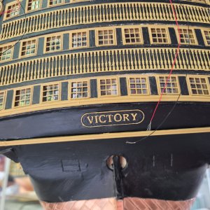

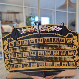

Having completed the stern fascia last week, I focused this week on the quarter galleries, having not yet received the 40 gauge wires for the 3 stern lanterns.
Pictures below
And now with lights on !!
I have also installed the 2 cat-heads
I have received the wire this morning and shall now install the stern lanterns mount and finish the poop deck.

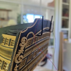

Hello friends
Good progress in many different areas since my last post from 10 days ago.

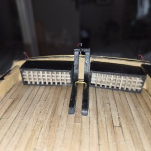

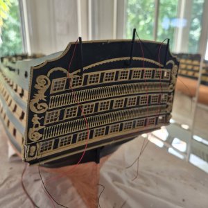

I have received the 36AWG electric wire from Aliexpress and have therefore installed the stern lantern supports.

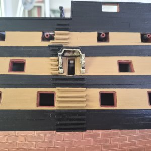

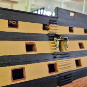

Next I installed the side entry port and steps

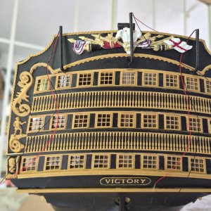

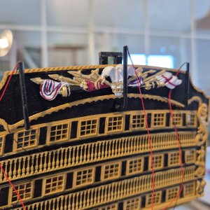

Next I worked on the trophy of arms and the Victory stern sign.
For the trophy of arms I ordered a 3D printed resin version from Woody's Model Works in the UK but was not really happy with the quality of the decoration. I therefore decided to use the metal version provided in the kit.

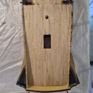

Finally I installed the poop deck and started with some of the fixings (flag locker, snatch blocks, cleats and kevel).

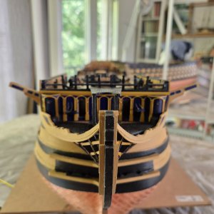

Little progress this week on the figurehead, the poop deck barricade and the channels
FIrst I completed painting and installed the figurehead. I tried a third party 3D printed version of the figurehead but felt this was not shart enough and kept the kit provided metal version.
Installing the poop deck barricade was no issue but I did not like the way I installed the fire buckets. I am now redoing this part; picture next time
