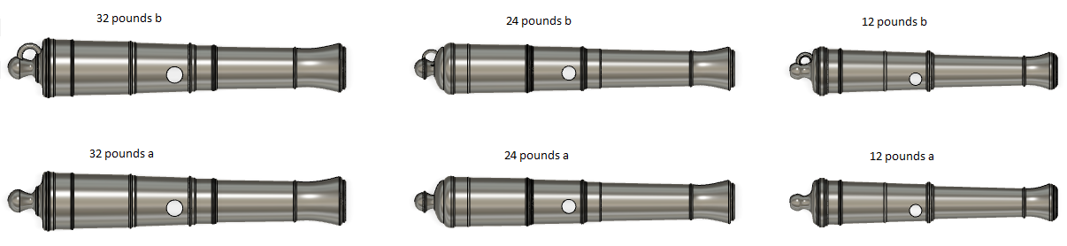

Due to the fact that the muzzle is thicker at his end, also the carriage is in front smaller than at the rear
Thank you for the photo. I saw today what you said and I realized I had assembled the wheel supports reverse (front to back). I will redesign the carriages according to the image by calibrating the transom to fit my guns. Also the image has a lot of terminologies, something I lack of knowledge.

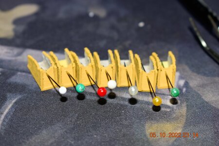

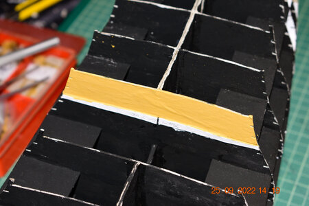

The inner bulwarks, painted yellow ochre:

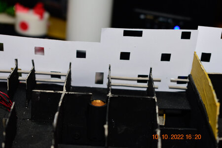

The inner bulwarks dry fitted and with two cannons:

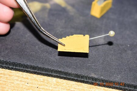

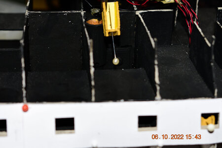

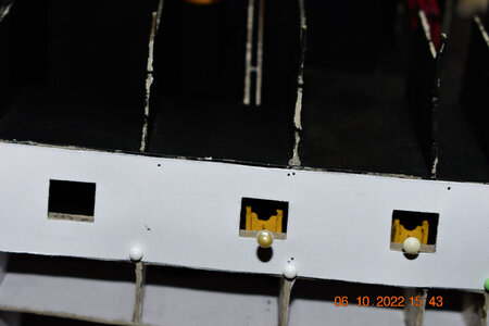

I noticed that the lower spacer (the piece between the two red lines on the front bulwark) is lower than it should be. That means after I glue the bulwarks I must cut the piece (thankfully its very easy) and reposition it accordingly to the gun ports.
Thank you all for your advises!!!

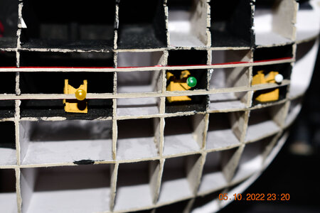

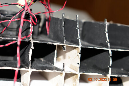

Good to see you are running your wiring for the lighting as you go.
There must be quite a bit of forward planning to get the wires to where you want them.
Well, I glued some paper coffee straws to use them as channels but my main issue and the main reason I didn't move faster is that I want the cables to be as much as possible to be invisible. And this is the main reason I didn't glue yet the remaining pieces of the first planking. Also since its my first model of the ship I don't know exactly how much LEDs I need and at what places. I have seen many models of the ship but when I complete this I will have a much better perception about the placements. So the next ship maybe have a different lighting.
Thank you

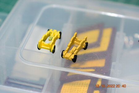

Well I glued the inner bulwarks and while I eas waiting to dry, I decided to give another try to the carriages. The design is based on the image Uwek posted above.
The results:
Thank you for your time and advises!!!

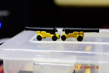

I finished the gun port frames:

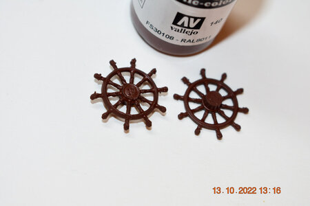

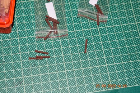

In the meantime I printed 36 carriages for the upper gun deck, I have to print ~10 more:
I spend almost one and half, two hours trying to make the cannon rigging, to this result. I have to say that I don't like it and I must experiment more (sorry for the quality but I don't have macro lens yet) :

Thank you, the truth is that this scale makes it a little hard some times, especially in the 12p guns, but that's the path, for the good and for the bad (although the good side of this kit is very nice and enjoyable, and the cannons is the only difficulty I had so far).

I fixed the cables to their positions:
And then I painted black the silicone and the cables of the middle deck.
The good surprise at this stage was the fact that even unpainted I couldn't see the cables even under this DIY lamp which is around 50 watts:
I imagine, painted will be even more difficult to be seen from the tiny gun ports with the cannons fitted in.

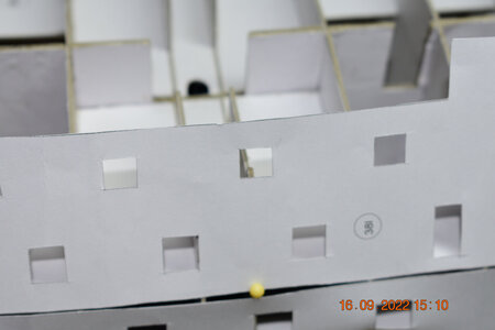

At the next stage, when glueing the sceleton of the mirror, i found the first mistake of the kit. Minor mistake since nothing will be seen, but i decided to fix it: At the keel plan, the parts are shown exactly as is. But at the detailed view of the mirror, the keel is shown with the same cut as the pieces H1 H2 H3.
i did managed to fix it and it was the first tricky part of the project.
