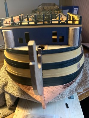

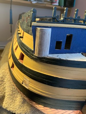

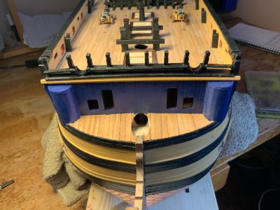

As can be seen from the above photo I have just started work on the Roundhouses which I hope to finish tomorrow along with planking the deck in front of the beak head bulkhead

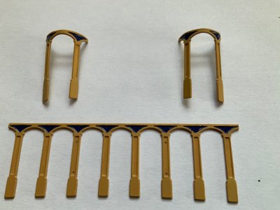

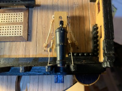

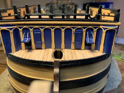

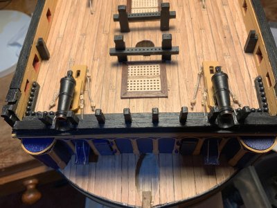

I have now completed the planking of the roundhouses, the beakhead pilasters have been painted and fitted ( I did not need to remove any material from the base of each pilaster), the beakhead doors and gunports have been painted and fitted, the forecastle shot garlands have been painted and fitted and the forecastle carronades have been assembled, rigged and fitted

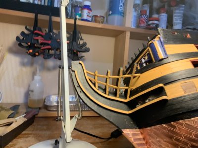

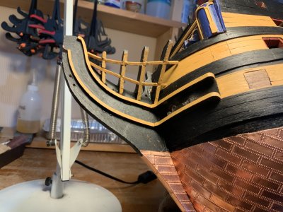

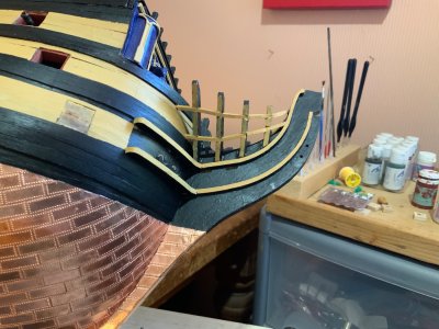

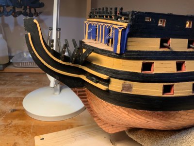

The Bows - a lot harder than I thought it was going to be, but I think I have got somewhere near in the end.

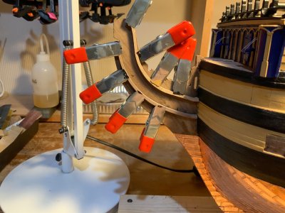

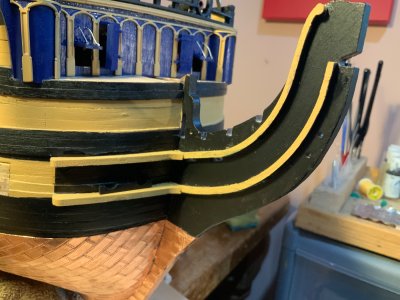

Firstly the upper and lower bow curved rails and the hair bracket and lower boat cheek rails were painted (top and outside edge painted yellow and the undersides painted black. They were then fitted to the shipIMG_0728.jpeg

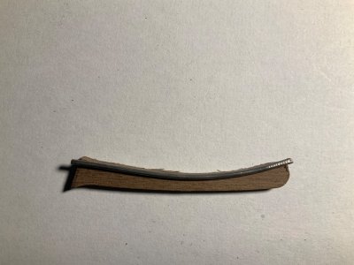

Initially the hair brackets (120) and the lower bow cheek rails (123) did not fit snuggly around the hull so I used some lead solder wire to form the outer profile of the hull and then transferred the shape onto the relevant parts and using a mini electric sanding band, the required curve was achieved.

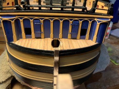

The hawse hole bolsters were then painted and fitted 13.5 mm from the stem as per the instructions and the 6mm hawse holes were drilled out.
The four head timbers were next which was slightly puzzling as there was no instructions as how to fit the largest of the these ( 107). The only way to get it through the required slot was to cut a piece off one side, insert the head timber and super glue the piece back on which is what I did.

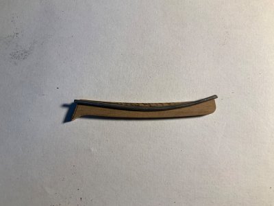

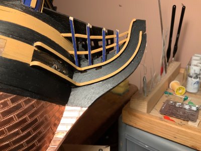

The hardest part for me was the next part which was fitting the rails using the 2mm x 2mm flexible beach. No matter how I tried I could not get the rails to lie flush against the outer face of the four head timbers. After a few hours of total frustration I decided that the only way to achieve this was to cut slots in the rails that corresponded to the slots in the head timbers. The slots in the head timbers also had to be modified, and I broke two of the head timbers trying to do this. I managed to repair these broken head timbers by reinforcing them on the backside with pieces of 1mm x 3mm walnut. It was a good job that the 2mm x 2mm beach was flexible as it needed to be when pressing the rails into the head timbers with pliers. The result is below and was the best I could do. Doing it this way allowed me to line the outer edge of the four head timbers with the 0.5mm x 2mm walnut which had to be painted blue.

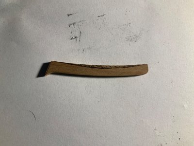

The photo below shows the way the rails were cut to allow them to sit flush with the outer face of the head timbers
