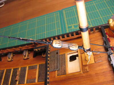

This is the mainstay. And was like you said standing rigging. Standing rigging was not used when you sailing. These kind of rigging was used to keep the mast in place. It was tensioned and keep in place. Sometimes the rope was belayed to the deck but could also knot to the lanyard itself.
In the picture above you can see it is belayed on a cleat on the rope itself.
