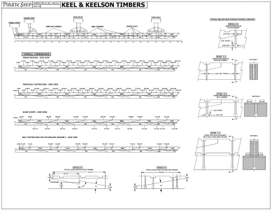

Some new work being done on the Pirate Ship. This file is a line illustration generated from the CAD software, saved as an uncompressed PNG file so you can zoom in and see the detail of the pieces/parts. Been working on the masts. The masts and rigging are requiring quite the self education to understand the purpose of all the ropes and what they do. I am modifying the technology of this ship however, and a lot of anchor points will be replaced with marine grade hardware instead of rope harnesses.
I also say to you all, who here wants to help build this ship in real life? In my mind, I designed it so that a normal woodworker could make all the pieces to the ship. When all the CAD drawing is done, I will publish a Bill Of Materials (BOM), so that anyone who is adept at dreaming and creating something can build their own pirate ship.

I am attaching two files that are crude, but I am going to redraw them with more clarity so that anyone who wants a copy can see it better. As we get older, our eyes fail us to seeing stuff up close! That's when you know you need reading glasses!!!!

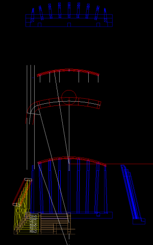

Believe it or not, this part depicted right here has been the most complicated and challenging part of the entire ship design. It's actually on the poop deck where the side handrail meets the handrail and short wall going across, called a taffrail. None of the railing, deck, and handrail has hardly any straight lines. To design something with curves in two and three dimensions all having to meet in space and preditermined points, then making the structural elements underneat graft into the existing structure is truly a challenge. I've been working on this little section for a couple weeks now, and think in a few days I will have it complete. My hats off the any woodworker able to reproduce it in wood, they will truly be a master at their craft.
SO, ALL THE IMAGES BEFORE THIS POST ARE USELESS FOR THE MODEL BUILDER. AFTER THIS POST ANYTHING POSTED IS FINAL OR CAN BE SIMPLY EDITED FOR MINOR MISTAKES. ALL THE DIMENSIONS ARE 1:1 SCALE SO IF YOU WANT TO BUILD THE SHIP AT A SMALLER SCALE, SIMPLY TAKE THE DIMENSION AND DIVIDE IT BY THE DENOMINATOR. THE BOLT HOLES AND DETAIL IS FOR THE FULL SIZE SHIP SO YOU CAN MODEL IT ANY WAY YOU WANT. THANKS.
