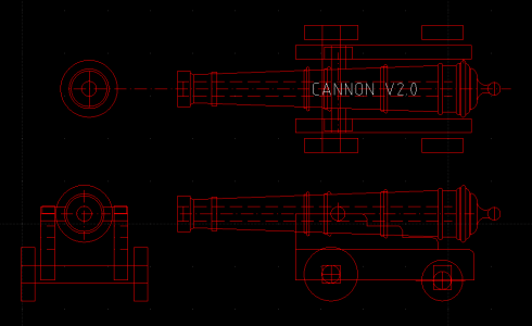

The only metal I have cast into cannon is pewter. Casting bronze could be interesting but I will probably stay with making a master with a lathe then making a mold and casting in resin rather than bronze or having 3D printed guns from my collection of drawings for various eras and nationalities.
Your drawings are very interesting but I hope you don't mind me asking why you are not making the designs as they were actually done on a ship?
The reason is because I am designing a ship based on the Walt Disney movies, the 'Black Pearl'. Now, the ship in the movie is not practical. I can tell you that because I am reverse engineering it on CAD. I am not trying to replicate historically what was done, but making a new ship with old school advices. I gather information here by you peoples posts, and that helps me in understanding the nature of the craft, but why it was designed the way it is. For example, the seat of ease was placed at the head of the ship. Why? Mainly because of crew politics. The executives, the Captain and his administrators had their own seat of ease seperate from the crew. I am understanding Naval terms like port and starboard. Most people do not know the meanings of those words, or the light beacons on an aircraft that is red or green. They use the same protocols on ships so that a vessel can be determined from afar if it is coming or going away from the ships vantage point.
I am not trying to duplicate or authenticate historical vessels, or armament. The cannon drawings though do impress upon me as I know a lot about casting and machining.

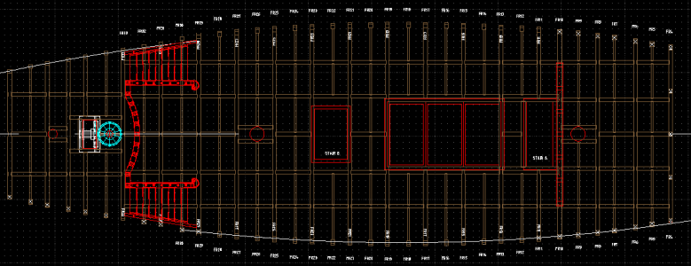

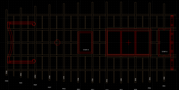

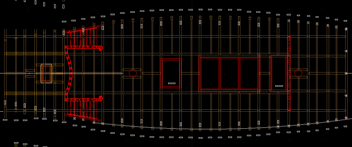

Here is the latest on this project so far. It has been a long time since I have posted to this thread, and here are it's updates:
I had to rethink the way I was proceeding with the illustration work as I found compiling mathematical errors in the just the Keel and the Bow, and it took me some time to reevalute my methodology in producing the blueprints. I have spent about a year and a half now on it and still cooking! I used to have 3D CAD but have resorted to 2D CAD which is sufficient with my limited resources. So with the CAD work on the Pirate Ship I am about 65% in completion of the basic structure and uniformity across the frames of the ship. I had to rescale the ship also because I saw that the size would not work full scale which I had intended. The truth is, I am going to produce free CAD drawings for the pirate ship for hobbyist to build at any scale, and the original 1:1 scale prints I am engineering for sale at boat and marine shows. You know that rich kids love to spend money at those? Here's to flying the Jolly Roger.

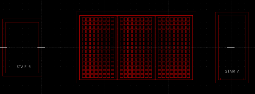

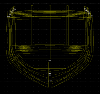

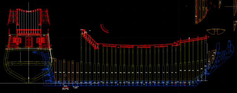

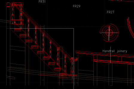

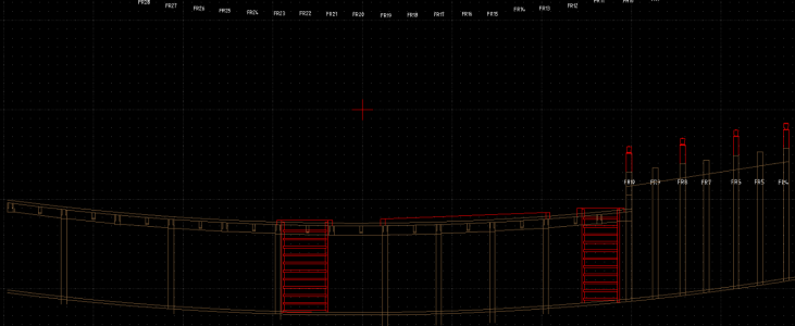

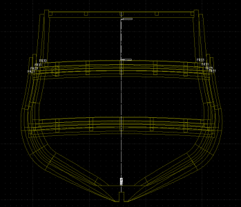

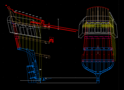

Working on the stern now. Truthfully, designing the components for the stern section has been the most challenging part of the design. Almost everything is curved, and pieces are running at different angles. Mind you I am using 2D CAD so anything I draw I use the age old process of using projections to figure out the different views. (edit: The white vertical stick in the middle represents the height of a 6 foot tall person.)

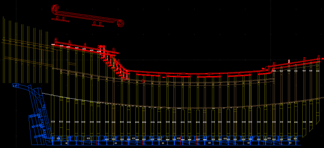

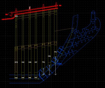

Now that I got that off my chest, I was gonna show you all what I am up against currently. I switched back to working on the bow section of the ship, which I had not worked on in over a year now. When I returned to that portion of the ship, I immediately error checked all the locations of the components and looked closely at the accuracy of where each component crossed another in geometry. Here is the product of that. The dark green lines represent the starboard elevation of the bow with the frames labelled 4-10 anchored to the keel to the bottom and also beginning to be anchored into the bow section. The brown lines represent the centerline of the decks crossing frames 4-10, and the red lines are the railings and adornments.

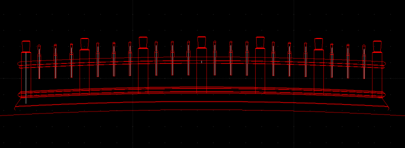

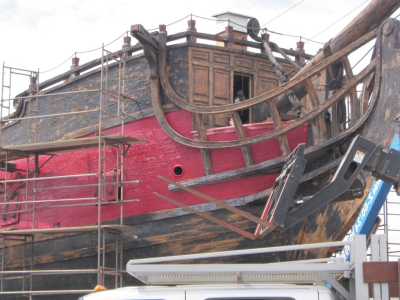

The above elevations looks okay until you study a real picture of the ships hull. It would be nice to have pictures that are taken perpendicular to the hull, but I don't have the luxury to travel to California or Hawaii or wherever this vessel is berthed now to take my own pics. These were probably taken a good decade ago. Anyway, some obvious things I missed is that the number of stantions on the left add up to 4 and the ones on the right add up to 5, yet it looks as if the distance on across the 5 stantions are shorter than the 4 to the left. In the next picture I will show you this HUGE error that I have to fix.

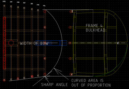

In this view from the top of the same previous image you see where the problem lies. In the CAD drawing all the stantions (post railings) are cicrcled in red. There are 5 in front and 4 on either side. Now if you look at the linear distances you quickly see that in the CAD drawing the front is longer than the side, which is just the opposite in the image above from the picture. That is why this small area in front of frame 4 is all crunched up to a distance of about 70" deep and 280" wide. So with my new found knowledge of a really crappy error, I took the photo above, which does not lie and traced it in CAD. By using some extrapolation to account for the two different places you work with you can figure out using scaling and percentages what the proportions should be. I hope to fix this in a week or so.
