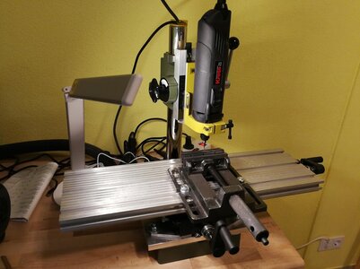

OK LET ME TRY TO EXPLAIN MY QUESTION, HERE FIRST I DO NOT OWN A PROXXON MF 70 MILL, JUST THINKING COMING TO TERMS WITH AGE AND EYESIGHT, I HAVE A VANDA-LAY MILL WORKS OF A DREMEL JUST OK WHEN MILLING FOR KEEL NOTHES I SET THE Z AXIS FOR THE NOTCH CAN NOT KEEP THE DEPTH OF CUT THE SAME DEPTH ESPECIALLY WHEN HAVING TO MOVE THE PIECE THAT IS WHAT HAPPENED ON THE LE ROCHEFORT SO NOW GOING TO A LOT OF SEMI/SCRATCH BUILDS AKA KRIS FROM POLAND SO NOT TO SURE WHAT I AM GOING TO DO THAT IS THE QUESTION HOPE I AM EXPRESSING MY SELF BTW DON ROBINSON ANSWERED MY QUESTION IT MAKES SENCE TO KEEP TRACK OF THE ROTATION ON THE HANDELS. GOD BLESS STAY SAFE ALL DON
The question is not easy to answer without all the details. However, what I can observe, is the fact that your mill doesn't have a stationary head, and you attach the Dremel rotary tool.
  • First, make sure the Dremel tool tightened in the mill housing very tight and perpendicular to Z, Y table at 90 degrees
  • Make sure the collet for the size of your end mill, and also tight firmly
  • Tight the milling part on the table: Here we have to know whether you use a vise or holding clamps. No matter what do you use, you have to tight the part 90 degrees to the Z column.
  • All work should be done by one installment e.g. if you doing the keel notches, tight the piece from both ends on the X table, set the deep for the notch, and operate only on X and Y handles until you make all the notches.

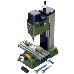

If you buy Proxxon looking for an advanced Dremel you will be very happy. If you're looking for a mini Bridgeport,
you may be a bit disappointed.
The Proxxon Micromot MF 70 Milling Machine is for work with extremely small cutters
Another review mentions the Z axis has a lot of play or backlash. Most likely the problem is that the Z axis
stop nut was set too loosely at the factory. Here's the fix: You'll need a 2.5mm allen wrench and a deep 10mm socket.
Remove the four allen bolts on the top cover of the Z pillar, unscrew the Z leadscrew from the spindle nut, and remove
the top assembly from the mill. Slip the 10mm socket over the leadscrew and tighten the nylock stop nut under the cover
(it's left hand threaded so tighten to the left). Lightly snug the nut then back it off a bit so there's minimal axial
play and the handwheel turns freely. Reassemble and test. The Z axis will be much tighter

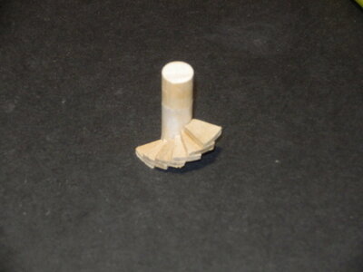

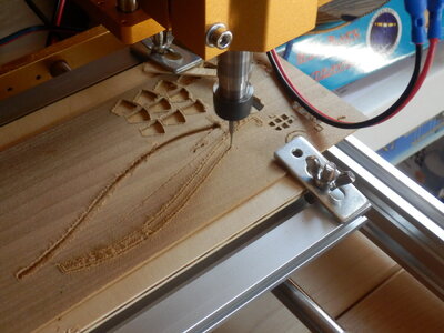

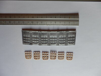

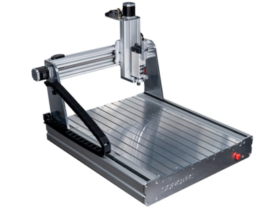

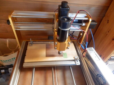

I am now working to build Euro Model Royal William. This is a scratch build except hull and metal decorations. So I bought 3018 CNC plus router from Ali Express. It cost about $450 including shipping fee to Japan. I attach some photos to show how convenient to use this machine. Since this is CNC, you need to connect to PC. I am using old Windows8.1 laptop and open source software like Inkscape, Jscut, Candle etc.. I also purchased several end mills from Ali Express. End mills sold in Japan or US are quite expensive, but the ones I bought from Ali Express are reasonable, like $5-10 for 10 mills. They are good enough to mill wood. The pars I made using CNC are window frame, fender and mast base and spiral steps. I think I can easily make round part of rails.

Thanks, Dave, this is great, I will try to decreasing the backlash this way. I assume the same applies to the X and Y backslashes too.
