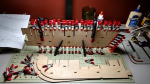

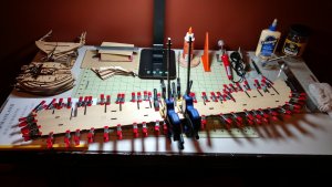

The false keel halves went together quite nicely, with little prep work. I purchased the little red clamps on Amazon for around $9.00 for sixty pieces. They really came in handy! The only drawback is that some are weaker than others. But no matter, they did the job.
And with the false keel all together, I'm getting a feel for the overall size of the project.

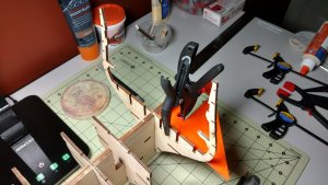

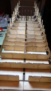

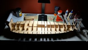

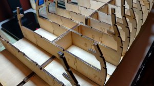

I'm not sure if other kits are like this, but these pieces have Lazer etched lines showing you which pieces need beveling and how much to bevel them. I was a little nervous about it at first, but after assembly of the beveled bulkheads, the shape of the hull was very nice.
IMG_20180320_180210.jpg IMG_20180328_164958122_HDR.jpg IMG_20180328_164902859_HDR.jpg

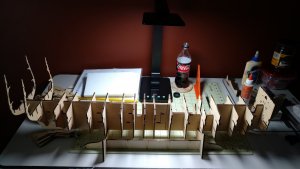

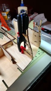

Here is where I made my very first mistake during my build. If you look closely, you will see, just aft of the clamp, the third outer bulkhead should have been installed at the same time as the second outer bulkhead (clamped) and support deck. But no problem; with a little bending and finesse, the third bulkhead went in, and fit well.

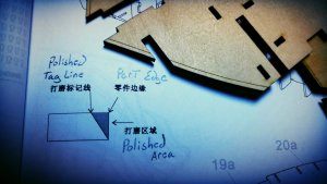

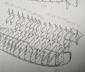

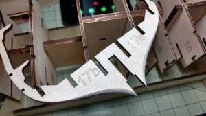

I wanted to point out that the illustrated manual points out the installation of each of the inner and outer bulkhead pieces, but numbers them incorrectly. In the manual (when assembling the outer bulkheads) it starts out with 1a thru 7a and then 8b thru 15b; all of which are on the same side. The correct installation is 1a thru 15a, but when installing 8a thru 15a, the bulkheads must be installed so that the laser etched numbers are now on the back side of each piece, and not on the forward side. This is due to the way the laser cutting machine cut and etched the pieces.
Of course all of the pieces were cut and etched from one side only; and as I mentioned before, all of the pieces were marked (if requiring beveling) with a "tag line" from one side only.
In the photo below, you can make out the numbering to 7a & 7b of the outer bulkheads. This is because all of the outer bulkheads after 7a & b required beveling on the backside to shape the hull to the stern. Of course that goes without saying that 1a & 1b thru 7a & 7b require beveling toward the stem. This works the same for the inner bulkheads as well. Note that after 10, all of the inner bulkheads are turned around (laser etched numbers are now on the backside).
IMG_20180331_193032043_HDR.jpg IMG_20180331_193053197_HDR.jpg IMG_20180415_115534472.jpg

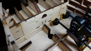

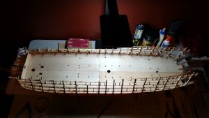

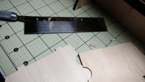

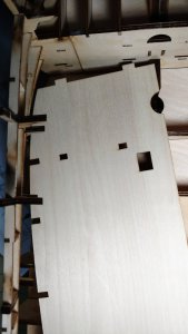

As per the manual, you build the false keel, then install the center bulkheads, then the outer bulkheads, and then the first deck (four pieces to the deck). So that's how I did it. The problem arose when I went to insert the forward end of the deck into the ribs and forward bulkhead. It just wasn't going to happen with the tangs on the forward end of the deck, so I had to remove them in order for the deck to fit properly into position. After cutting off the tangs, I cut a strip of wood and fabricated a forward support for the fwd end of the decking. I think it turned out rather well.
Looking back on the assembly steps, it I had installed the decking prior to installing the outer bulkheads, then I wouldn't have had to remove the tangs from the decking. But no matter, all turned out very well, and I'm very happy with the results.

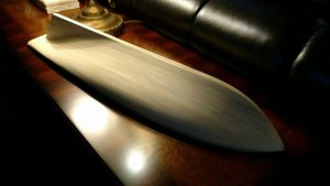

In this photo, you can see how ridiculously small my work space is. lol
In this light she is looking like a sculpture - Looks very interesting.
BTW: The hull you showed in post #17 is realy looking good. Very good workmanship!
