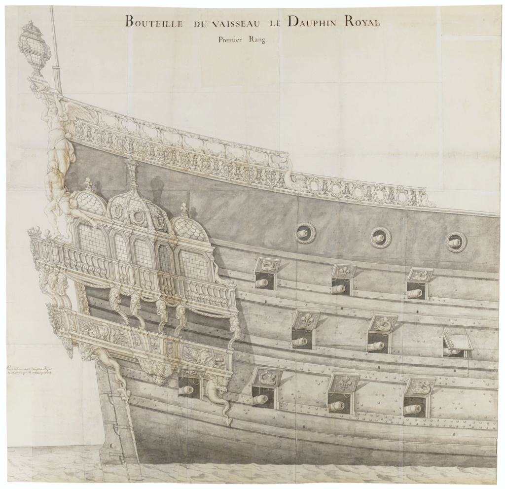

I got a question: Can I use this "le dauphin royal" drawing as an inspiration for the port lids? Do good drawings showing the faces of french 1670' port lids in detail exist?
I think I'll use milliput to do the ornaments (fleur de lys/sun...).
It's me or heller forgot a porthole on the quarter gallery?
That is not a porthole, but the entry/exit door to the lower quarter gallery. Nobody seems to do so, but if you are going to cut out the decorative panels, you might consider cutting an opening for this entry door.
This drawing of the DR is the best and really only detailed drawing that shows the gun-port decorations. From the stern, you can see that they are relief sculptures and not painted on:
You can see that the lid ornaments are a combination of Fleurs, the Royal symbol, and dolphins, which supports the name of the ship.
On this closeup of the Monarque, you can get a sense for the variety of ornaments employed:
Noted that on the monarque/royal louis drawing, only 1 battery is shown with decorated port lids. I think I'll cut the doors for the lower galleries, I thought it was a gun port because it looked like one. For the lids, I'll use 1 sheet of styren/plastic with the ornament being done in milliput. Currently reading loic charpentier LOS! 63 article on the french marine, I'm done with the one telling a general story of the french 1st rate and the living condition of their crews.

Thinking about it, since the 1st rate french ships past the royal louis were supposed to have a lower budget for their decors and the soleil royal is thought to have sober decor than the RL in its first version, I wonder if they wouldn't cut down on the decors of the port lids, per example, by having only 2 symbols like on the dauphin royal, not 3 like the royal louis (or one, tho I think I'll stick to 2).
