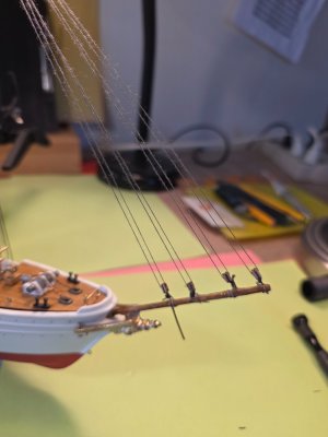

SoS member Jacques Cousteau discovered that I installed 12 blocks and tackles (on the masts and bowsprit) incorrectly. Without printed instructions, these Artesiana Latina kit videos really stink at fine detail. One has to consult the box top to see how the blocks attach to the overall rigging, but it is still not clear. And I got them backwards.
There are also a few knots that are used to attach sails to masts that I cant figure out because the videos go fast through that part of the build. Will have to check the George Biddlecombe book on rigging to see how these knots are tied.
And now every sail that need brass rings have them. I only put the tiny brass rings on the top jib ("flying jib"?) because it is visible. I put larger 4mm rings every where else on the 19 sails in all because I could twist them open with my fingers. There were a total of a 108 brass rings attached before sail rigging can happen.

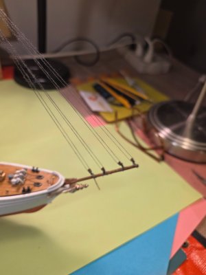

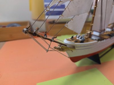

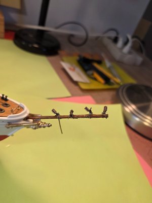

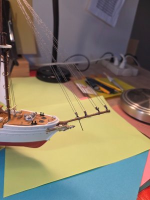

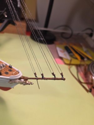

I fixed the bowsprit blocks first to see whether they can accept a line from each of the jibs and the foremast stay sail. Lots of work, and it still looks a bit of a mess. I plan to sand the bowsprit down and re-stain it because it is accumulating too much glue. But really looking forward to rigging the jibs and the dolphin spike next.
I did this test rigging in the picture to make sure the blocks work the way they are supposed to. Check.

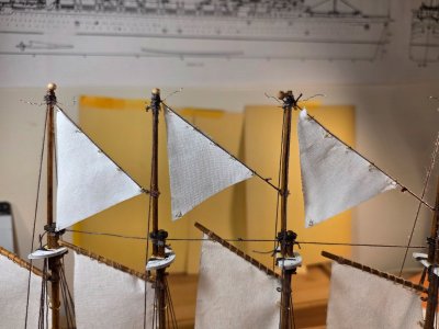

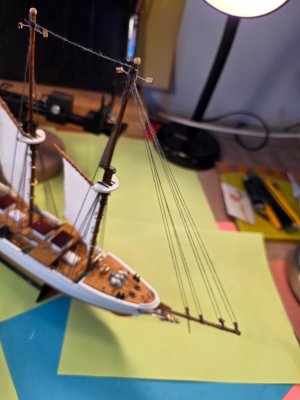

Now I have to re-do the 8 blocks atop the 4 masts so they can accept the 3 staysails. Outside chance I can hang the 4 gaff sails (fore-and-aft sails) tomorrow, but the Masters is on...
Nice work, the bowsprit blocks look a lot better! If it were me, I personally would redo the mast head blocks, as it doesn't seem like it would be too difficult at this stage. That's frustrating that Artesania Latina doesn't include more detailed info on how to do it. For stropping blocks with wire, the instructions for the Model Shipways Muscongus Bay Lobster Smack include pretty clear instructions on how to do them, and are downloadable at the ModelExpo site. (Or it may be the Norwegian Pram kit, I forget.) I haven't used wire, but I have stropped blocks with scale rope and fly-tying thread, following the instructions Chuck Passaro has provided (I think it's downloadable on his Syren Ship Model Co. site). It's not 100% accurate, but is relatively easy to do and looks quite good. I have yet to model internally-stropped blocks, which I assume are what the real Esmeralda uses.
Yep, I'm going to unwind all the blocks above the 4 masts to reorient them like the bowsprit blocks. That way I can start tying the main sails and gaff sails up near the mast platforms and pin drill another pinhole about a cm from the mast top to guide rigging through. I may even apply white water-based paint to brighten the sails somewhat.
Agreed. There really is no point to work with wire when it comes setting up blocks and tackles.

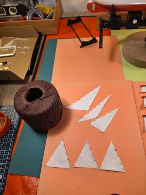

I ran out of dark mahogany thread after rigging the stay sails and the 4 booms, so I did the bowsprit in gray thread and did a double-wind for the bowsprit rigging just because. I toyed with the idea of coloring over the gray thread with a black stain marker, but I don't want to get stain on the hull. Maybe I will color the gray thread when I do a sand / restain of the bowsprit now that everything that should be rigged to the bowsprit is.
Still have to replace the wooden blocks at the tops of each mast and then do the running rigging by attaching the blocks to the tip ends of the square sails and the gaff sails.
And then do all 4 sails on the foremast -- mainsail, topsail, topgallant, and royal sails (if I have the terminology right). Run the rigging lines to tighten through all 19 sails and tie off the foremast sails to present the ship under full sail, if possible. Need to shape the sails, especially the foremast sails, the fore-and-aft sails (jiggermasts), and the 3 stay sails atop the 4 masts. Doing any work at the top of the masts is particularly treacherous because any rigging above the gaff sails can simultaneously make the whole rigging job go from taut to limp and back again with each added line tied.

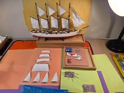

Kudos to you for sticking with it! What's the next model you have lined up? Hopefully something that includes at least a set of plan drawings?
JacquesCousteau -- Yes, indeed! My next build is the Mayflower 1620 kit 1/140 scale from Corel.
While the build is small scale, the rigging is for real, as you can see from the 3-pages of Rigging Plans that come with the 16-page set of drawings for the Mayflower. The kit looks like higher quality than Artesania Latina, so kudos to Corel there. It is also my first attempt at a solid hull with laser-cut planking and decking. I'm not necessarily a "Mayflower" fan (my people came later on the S.S. President Lines to Los Angeles) and I just picked this kit because I wanted to try Corel, having heard good things and seeing good build logs of Corel kits on this site (and it was ON SALE for under $100).
My original plan was to "step up" from the intro rigging job of the Esmeralda / J.S. de Elcano, to the more sophisticated / realistic rigging job of the Mayflower 1620 kit -- but we all know how that turned out! It's a nice looking model and presents a micro-fine rigging challenge.
Has anyone out there done this kit? There are a couple of resources for this kit on SoS, but no build logs for this specific kit (there is a decent build log for this kit on MSW). I think I will skip doing a Build Log for the Mayflower 1620 1/140 scale (because a good one already exists). This time out I will just build it.

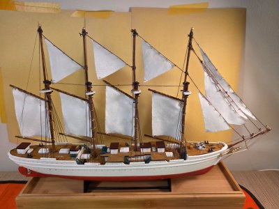

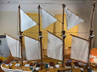

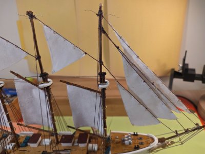

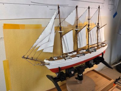

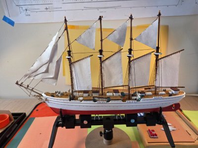

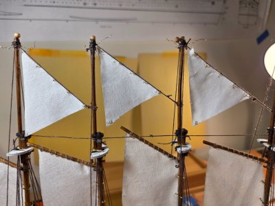

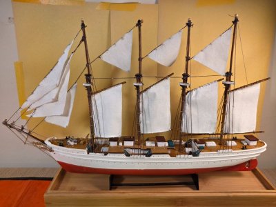

More progress pics on the Esmeralda rigging project. I know that the Brass rings are way out of scale, but the prospect of attaching 108 of the 2 mm Brass rings (after it took me over an hour to do one sail) was not happening. And this build is not about reality, it's kind of like a Lego build.
Also, the tension on all of the rigging lines so far is pretty good. I'm losing tension mostly in the two aft masts, but once I moor each of the mast booms to the 3 eyehooks on top decks, the tension should be set.
I have pretty much decided not to complete fabrication of the shrouds. My strategy of pre-wetting the cross pieces for the shrouds did not work and the work to put just one shroud crosspiece on the shroud vertical lines is ridiculous. I'll have another chance to do shrouds on the Mayflower 1620 kit from Corel.
The rigging job will be done once I attach the 4 gaff sails to each of the 4 masts and attach every sail to a wooden block that gets moored down by tying to the eyeholes on top decks.
The blocks for the 3 jibs and foremast stay sail will throw the line to a brass cleat at the bow. I will then add the 6 red personal flotation devices, the 2 water pump guns, and the 4 tenders / jollyboats (will drill holes for the 8 davits, 2 for each tender). Oh, and the brass anchors, which are a bit small for this scale. The real anchors on the J.S. de Elcano are black.

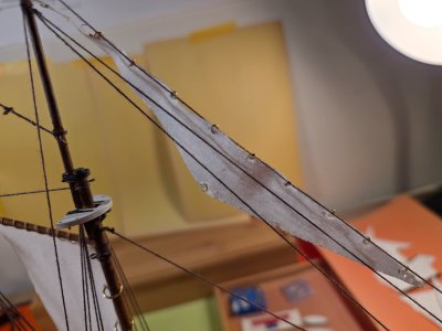

If you don’t mind me suggesting that you should consider swapping out the rings holding the sails to smaller ones, it would be a big improvement.

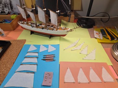

Bryian - I took your advice and switched out the 6 mm brass rings for the smaller 2.5 mm brass rings. You are right, the rigging will look much better with the running rig going through smaller channels. The proportions were way off with the larger rings.
I ran out of 2.5 mm rings after switching 98 of them, I still need 10 more to switch the rings on the mainsail, topsail, topgallent, and royal sails. So off to the hobby shop.
I will redo the top mast rigging again (for like the 4th time) and the jibs once I have every ring switched over.

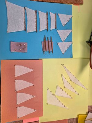

I switched out 108 6mm brass rings in exchange for 2.5mm brass rings. The larger rings were easier to put on the sails, but they were out of proportion to the rest of the Esmeralda. The easy build is not always the best build.
I ran out of 2.5mm rings part way through. Luckily, they had 2.5mm brass rings at my local hobby store. 200 for $2.49.

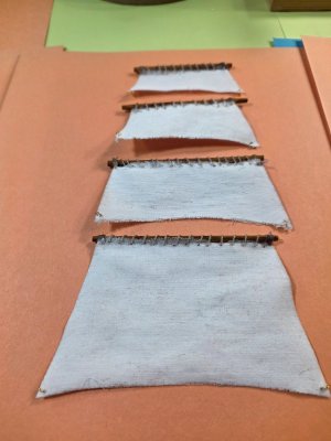

I had a chance to re-rig the top stay sails with the smaller rings and they look great. It took all day to get this far and it was alot of work, but the ship looks much better. So it was worth the effort.
All the sails got a fresh cost of 50/50 Elmer's Glue-All and water and acrylic white marker to show a consistent white sheen and bendability throughout.
Tomorrow, re-rigging the jibs and the foremast stay sail to the bowsprit. Then attaching about 24 wood blocks to the sail spars and tying off the booms and gaffs to eye loops on top deck. Then running all the rigging through the wood blocks. I got rid of all the silly wire that was part of the original video rigging plan.
And if I'm lucky, I will have time to trim the mainsail, topsail, topgallent sail and royal sails, but the wooden blocks will need to be on by then. Also, the 4 gaff (fore-and-aft) sails need to be tied up (they are not sewn on to a mast, gaff or boom).
Trying to finish before I go out of town on Thursday, but I need to take my time. The slower you build the better the results.

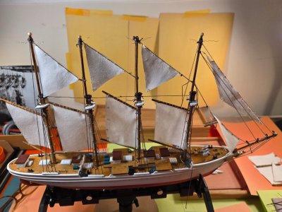

UPDATE: I saw the rigging mistake caused by a misaligned corner ring on the fore corner (leech?) of the flying jib and I fixed it. I tried to delete the old pictures but they were only moved to the end of the post.

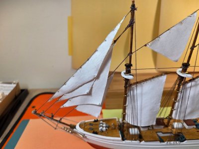

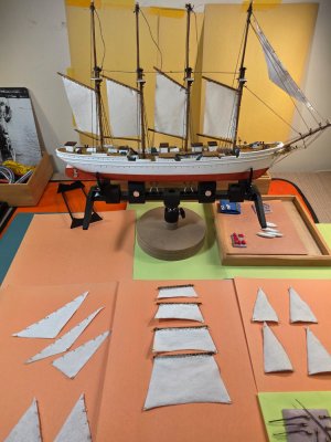

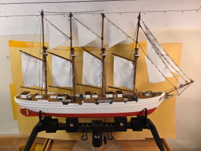

This is as far as I'm going to get before I leave for my 5-day trip tomorrow. It doesn't look like much progress, but in the last 2 bench sessions I managed to:
1. Give all the sails another coating of glue solution to make all 19 sails consistently sheened and bright white (like the kit). They are now bendy and pliable and I'm starting to introduce billows into the mainsail set of 4 square sails and the gaff (fore-and-aft) sails.

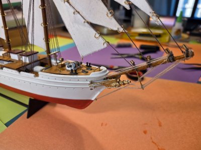

2. Locked down the jibs and foremast stay sail rigging to the bowsprit. It took a long time to get the jibs to lay right atop the bow. Had to do some extra knots to get all the jibs lined up correctly. I'm happy how the jibs came out. Next, I need to attach wood blocks and running rigging to 12 of 19 sails. That's going to be at least a 2-3 day job. I will be using the Biddlecome book on rigging throughout.
3. Re-stained all my booms, gaffs and masts where exposed to get consistent teak colored masts. Cut off the cheesy wire rigging atop all 4 masts. The wood blocks for the gaff sails and square sails are now going to be tied in with rope yarn instead of attached with wire.
Still trying to decide whether to re-do the bowsprit rigging underneath the figurehead now that I have black rope yarn. The double lines running through the bowsprit rigging look off to me because of the gray thread I used. Now that I have black rope yarn I can rig with a single thread instead of the double.
Lots more to do, and I'm going to take my time.

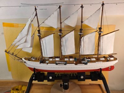

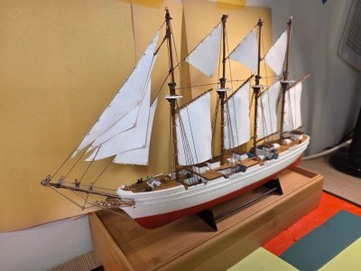

Looking at the recent pictures of the Esmeralda, I just noticed that the foremast is leaning / canting forward by about 3-5 degrees, most likely as a result of my rigging the jibs and foremast staysail a bit too tight to the bowsprit.
I will have to fix this when I get back in a few days. There's always something!
Still thinking that if I want to present a model that has "some" similarities to the real Esmeralda / J.S. de Elcano, I should paint the figurehead and anchors semi-gloss black as they are in the pictures of the Esmeralda under way. However, this build is very, very far from resembling the ship in real life, so do I leave the figurehead brass colored or not? Is this an esthetic decision or a modeling decision?
