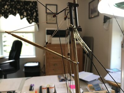

More rigging research:
This step is interesting. There are no pin rails to hold belaying pins on either side of the mast. I’m assuming (dangerous thought) that all the lines tie off to cleats on the mast or the cross trees or the eyebolts on the deck by the mast
So the theory is to follow Mr. Peterson’s sketch and tie off the lines to the deck cross trees, cleats or eye bolts.
Jan
