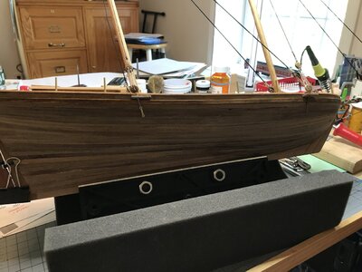

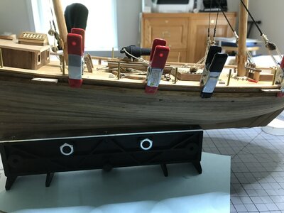

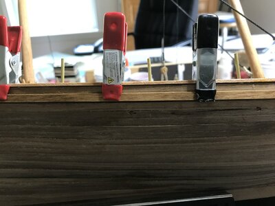

I would be interested to know what type of glue did you use for the wales?
I used Titebond II Premium. It's the only glue I've used since I started building.
I think the problem is the the type of wood and expansion. The planking underneath is Nussbaum (Walnut??). Since both the Port and Starboard pieces have done the same thing I suspect there never was a good bond. I think a replacement is the best bet, since there appears to be a slight bubble effects I place the clamps.
:rolleyes: Hah, now that I typed that I don't know if it makes any sense:rolleyes:.
The bubble sort of moves as I clamp, I think that's because neither the bow or stern sections of the Wales have come unglued.
Jan
Oh s...
I thinkalso, that a replacing would be the best way -
you have to see the positive point: better now, than afterwards, when the model is finished - so somehow you had luck ;)

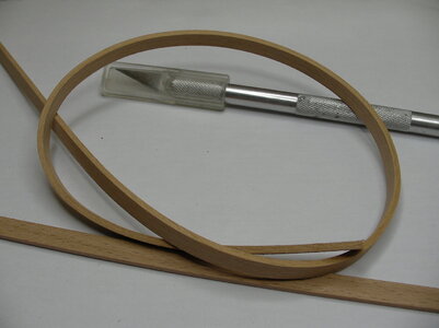

Hi Jan!
I think at the "Alert" the wales were supplied from this beech bentwood. At first glance, this wood is very easy to bend only by hand and almost indestructible. The marine model builder and book author Wolfram zu Mondfeld writes about this wood: bad to nail, dowel and glue.
If possible, I would make the wales from another wood (possibly from two laths, each 4 mm).
Maybe the rest goes well to take off.
Thomas
Hi Jan!
Thomas
Hi Thomas,
Well it took less than five minutes on each side to pry those pieces off. There was absolutely no glue residue on the hull where those pieces were “glued”. Fortunately there are only two deadeye straps on each side, easily removable to make way for new Wales. Your suggestion of two 4mm laths to replace the old 8mm Wales is a good one.

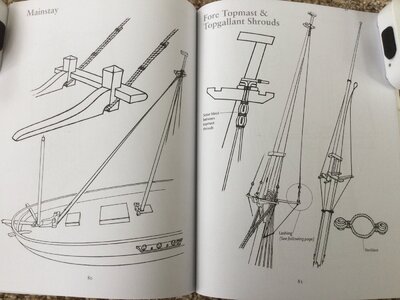

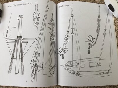

Hi Heinrich,
The contents are great, there are detailed rigging drawings for three ships. A British Naval Cutter, a French Lugger and an American Schooner. A lot of information for a guy like me who is trying to interpret rigging plans.
These are some samples of the pages in the American Schooner section. There are some similarities to the Cutter I’m trying to rig. I figure every bit of knowledge that I can find will help with what I’m trying to accomplish.
Jan
I am glad that you find the book a help. The American Schooner section, may also be of help to the Bluenose builders, the section on the French lugger can assist the Le Coureur builders, while the Cutter section should be right up your alley. Luckily we have Ab Hoving for the Dutchmen.

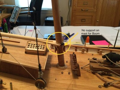

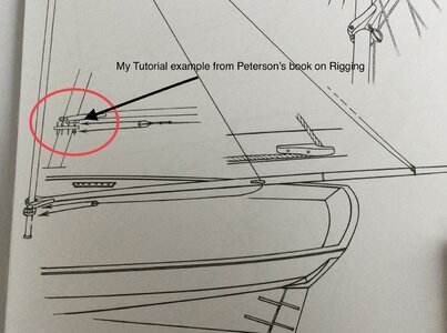

Interesting build item:
I’m currently working my way through the standing rigging. I‘m working forward from the Stern so I can keep the tension on the lines that I’ve done. That brought me to an interesting dilemma. What supports the Main Boom??
The Alert plans do not show any type of shelf, ring or stop on the mast for the boom to “rest on”. All my literature on rigging shows at the minimum a half ring or wedge type shelf.
Since I’m new at this ship modeling stuff it makes sense to me add some sort of support. If I don’t then boom will only be supported by the lifts and rest on the cleats fixed to the mast.
My guide to resolve this little issue. It’s in the American Schooner section of Peterson’s “Rigging Period Fore and Aft Craft”
Jan
