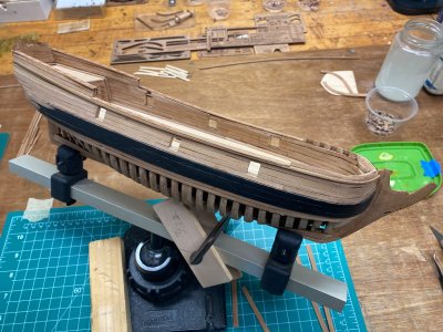

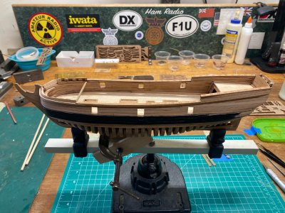

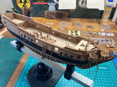

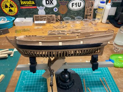

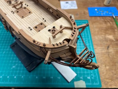

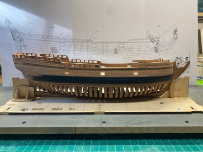

Finally some progress. I got the hawse Timbers in. Also got the deck beams and pillars installed. I’m gluing the deck planks together only this far the rest I’ll add in the ship. I see clearly the instructions with these POF kits leave a lot to be desired. I had planned to add ceilings, interior structures, etc etc not included in the kit but decided to just carry on with the kit parts, not go by the Ancre plans and get it finished but definitely not perfect. Mixing very fragile kit parts with scratch build extras just doesn’t make sense or appeal to me. I’d be better off just scratching the entire project. Live and learn !
Way to go Tony
Good morning Tony. I agree with Paul it is looking mighty fine. I think there are very few guys who actually get their models very accurate. The rest of us tend to make a fair representation of the ship. Cheers Grant
Indeed. A reasonable rendering of a ship. Didn’t deviate too much and good thing I have a lot of wood here because some kit parts either broke or didn’t work right. It’s all learning.

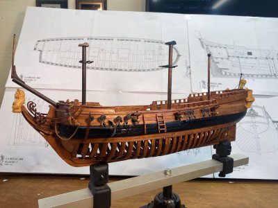

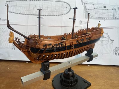

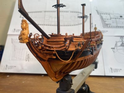

Bonjour Tony, félicitations pour votre maquette. Comme je suis en train de la construire moi-même, je la consulte fréquemment.
Pourriez-vous peut-être me décrire la technique que vous avez utilisée pour peindre vos canons en vert-de-gris ?
S'agit-il de peinture ? D'un procédé de gravure chimique ?

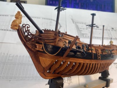

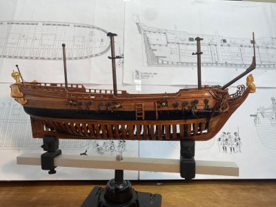

Congratulations, Tony! Be encouraged - it is a very nice model that you can display with pride.
Thanks Paul. Going for something bigger next time. I built 1/700 ships for a long time. Tired of tiny ! I coated it with shellac. Its really not glossy, thankfully ! The lights I hit it with and phone camera didn't do me any favors.
Thanks, Yes I just applied vinegar for days to get the color.
