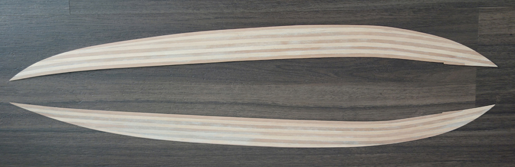

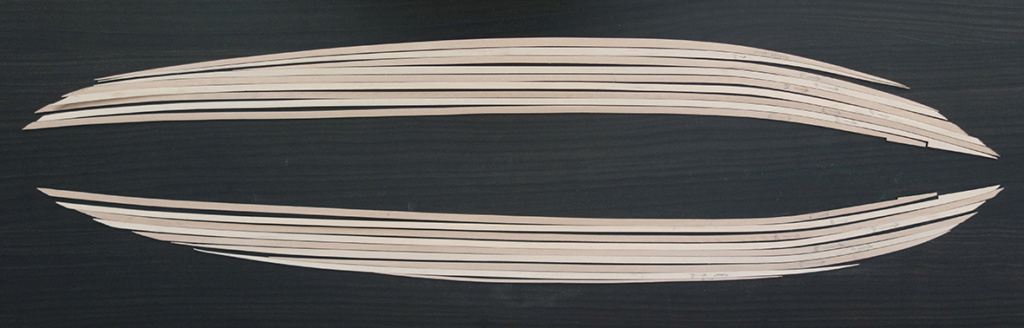

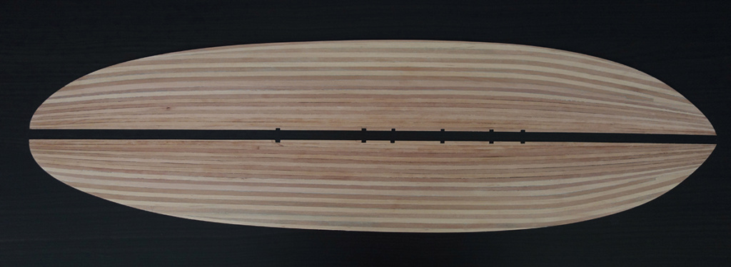

It was a long time ago, wasn't it ! I had "lifted my feet" certainly but despite all the work continued ...

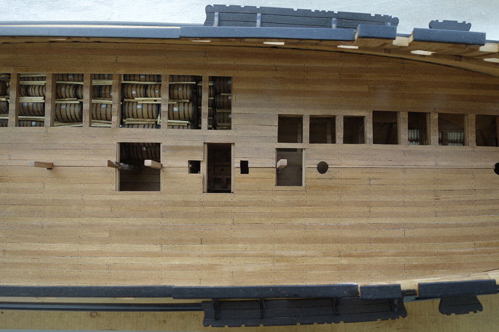

A big piece for me: the false deck. I was not sure how to do it. Finally, I decided to do everything by hand : cutting the slats, adjusting them, sanding etc ...
Some photos of the successive stages :

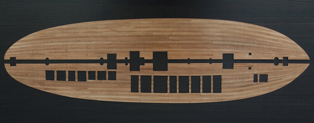

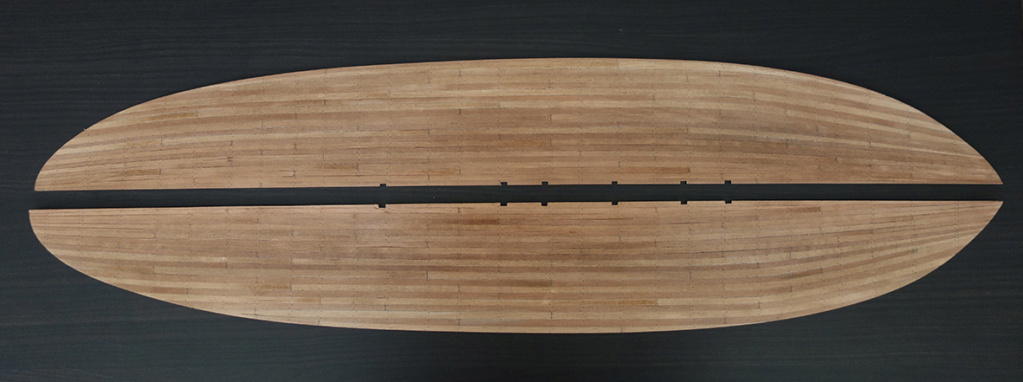

A small patina, nails :

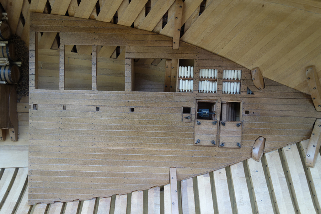

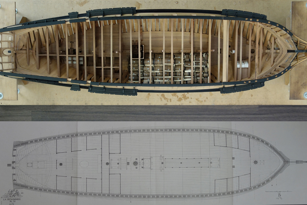

I decided to make openings in different places where there is something to see. The upper decks will also be opened to show the structure ...
To summarize : the wedge will be visible through the frames and on the opposite side we will see the structure in "plunging" mode.

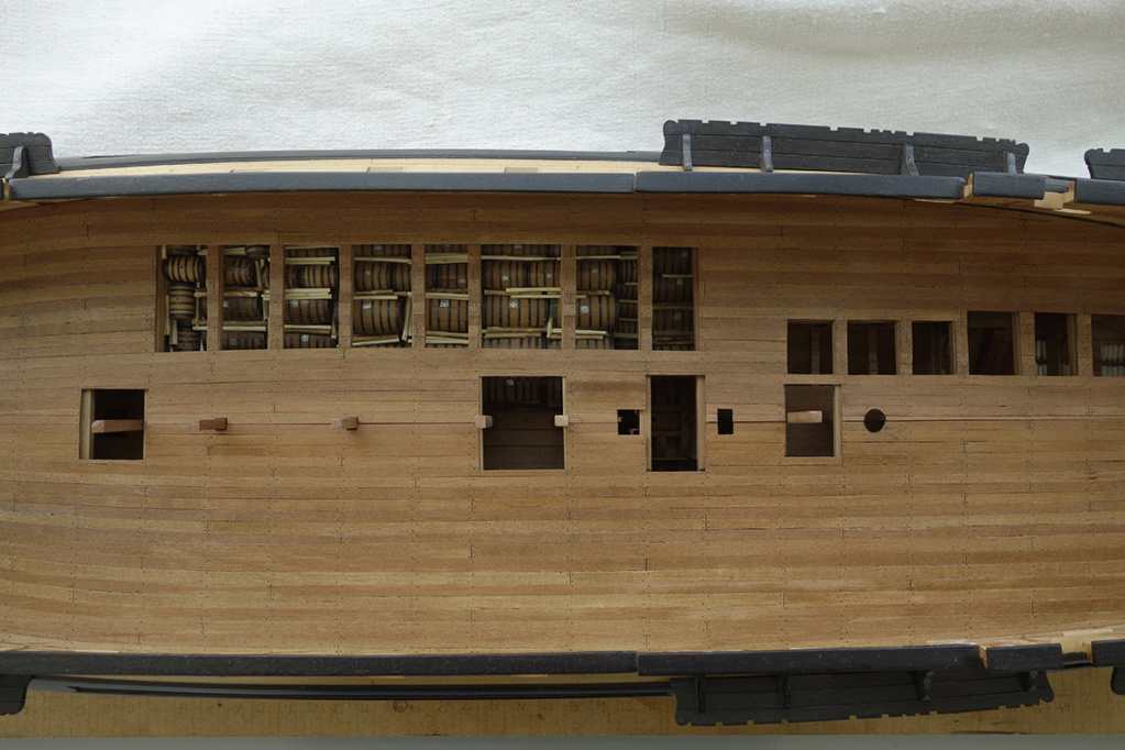

I make the openings :
The false deck in place - not glued - to see what it gives :

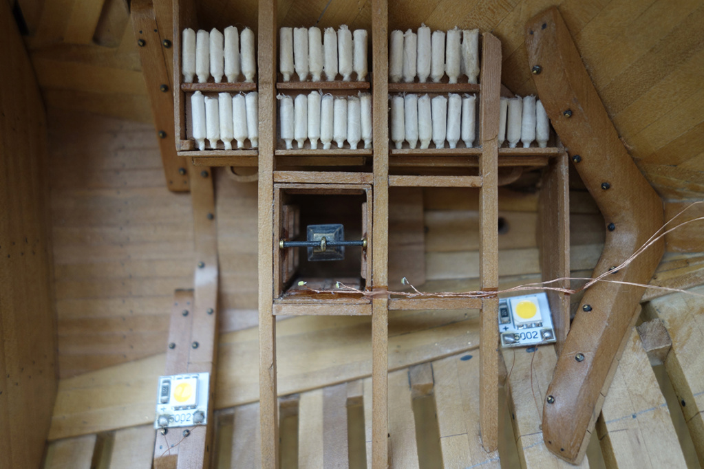

I also wanted a lighting system for the hold and the deck. I had not shown you these photos where I installed some micro-leds in the bilge to start :
All this being practically invisible from above :

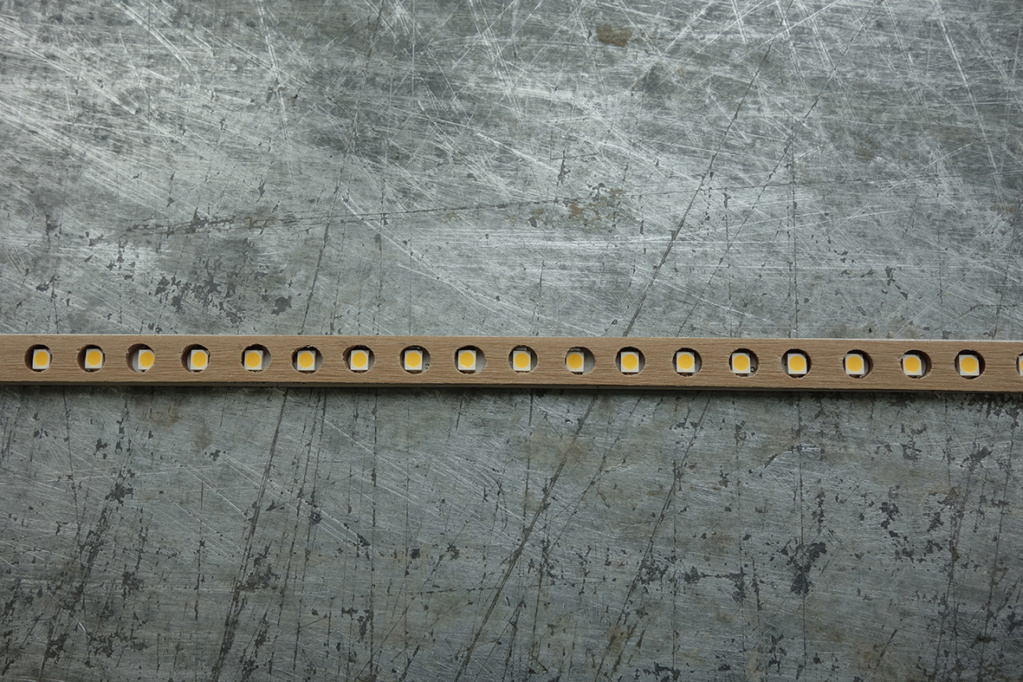

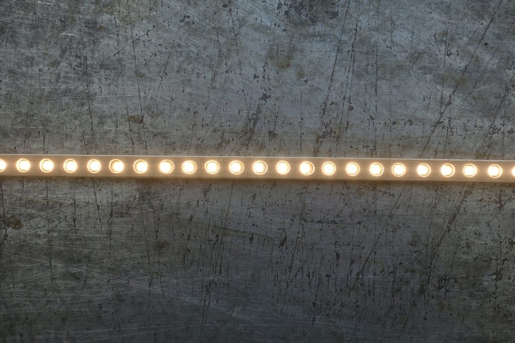

continue the lighting work with a whole ramp of leds, embedded in a slat, so that they are not visible when we look between the frames :

The Leds ramp is now definitely in place :
The false deck is glued.

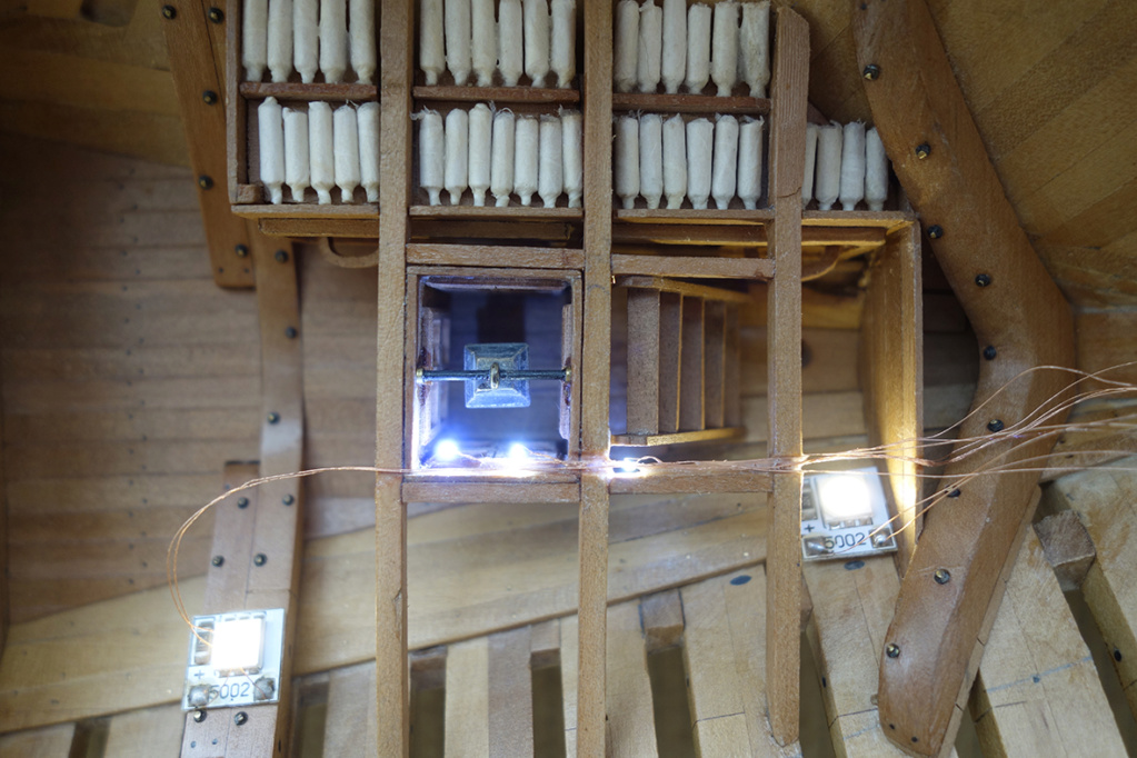

Here is a lighting test. The brightness satisfies me : the goal is not to let it light up permanently but to be able to show the inside of the hold on occasion ...
So let there be light :
So much for this day. I enjoyed myself ...
