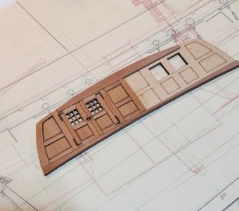

Really wonderful work! That decking on the schooner is amazing!A good CO2 laser and the correct settings can minimize char and give great results. These were cut on an 80W Trotec CO2 laser. It's a pretty expensive production machine that uses proprietary software. The first image shows window frames and mullions for an N scale train shed were cut from 1/16" basswood and polybak respectively with very little char on the wood and almost none on the polybak. Polybak is resin impregnated paper that cuts like butter on the laser. It takes great detail and is strong for its thickness.
It takes a lot of work to dial in the proper settings but with care you can minimize the char. I don't cut much wood thicker than 1/8" very often but as you can see by the rafters in the second image there is very little char. All parts of this train shed were laser cut, windows, framing, rafters, siding etc.
Correcting for the kerf of the laser allows for tight fitting pieces. I really enjoy designing for the laser and fine tuning the results. I also laser cut cannon carriages and a jig to glue them together as shown in the third image.
The fourth image shows the deck for the topsail schooner Julia that I laser cut and laser engraved. For the size of it I don't know how I'd do it manually.

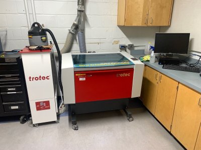

Thanks Dave. Those windows are basswood. Pretty soft. Haven't tried boxwood because until just recently I've not had any. This laser uses a 2" lens, so while we do get the V shape to cuts it's not as pronounced as with a longer lens. A shorter 1.5" lens might reduce that even more. Here's the machine I have access to at work. Trotec Speedy 300 80W CO2 laser. Nice machine for this kind of work. 17" X 29" bed so cannot cut big sheets but it's fine for my needs.nice work Todd i tried to laser cut windows with no success my problem was the lasers i use are industrial size at 800 and 1,200 watts. trying to dial it down to fine cutting just did not work. The laser does not cut square it cuts as an upside down V the beam spreads out. This made the frames and mullions V shaped and trying to clean off the char they just crumbled. Another problem was the wood grain the mullions had a cross grain and extremely delicate. The softer the material the less char but more delicate, harder the material like Boxwood the stronger the piece but more char.
Now a low power laser engraver may do the job i do not know because i do not run a laser just program them.
i use AutoCad because the lasers are open end that is to say it will use any vector file so they will cut from a AutoCad DWG file.

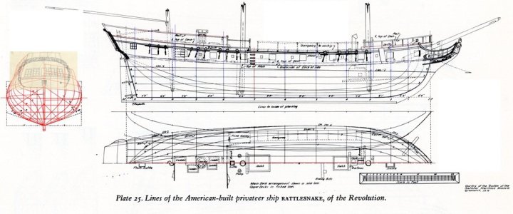

you know there is truth to that in the early days of graphic design we had to draw layouts for web presses and die cutting. i can pick up a layout and instantly know who did the drawings. Later i became aware of the artists mark who did it.Re; Bob Cleek’s post #22 above. As an example of the “hand” involved in manual drafting, Howard Chapelle’s drawings are instantly recognizable even when published somewhere other than one of his books.
Roger
