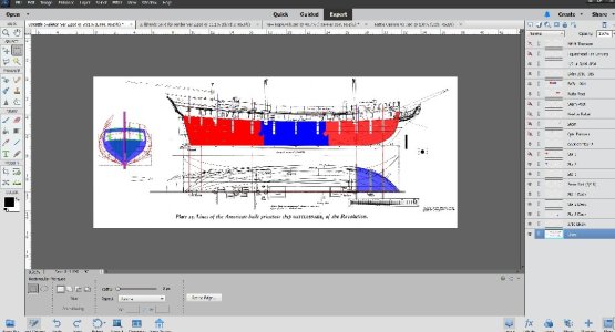

My work flow is somewhat primitive by modern standards because my early go-to was Photoshop Elements.
It's not usually considered a drafting program , but I get by with the primitive operations that involve line drawings.
I accomplish what I want, and don't care to invest time and money in a more dedicated drawing program. The good ones are lots of money and/or subscriptions as mentioned earlier.
This is how my work screen typically looks. Each part for the model is a separate layer. I isolate each part and export it as a .PNG solid form for LightBurn.
Lightburn has a very robust tracing function that converts the PNG to an .SVG for cutting. The .svg can then be exported to any other supporting program.
