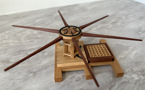

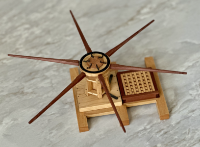

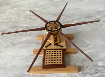

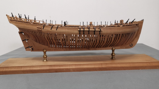

So, I took my break with the capstan project. It's a scratch build of a 1:24 scale capstan circa 1776. I think it turned out well.
Most is made from boxwood while the combing and bars are pear. Making a ten-sided column with every other facet recessed using wedges cut on a tilt arbor saw was tough. Also, milling the combing with my super cheap mill (toy) and applying really small treenails, and finally soldering together eye bolts and then eyebolts to super tiny chain were the main challenges. Custom fitting each cheek was pretty tough too. But it was fun. Plans from Toni Levine in 1:16 scale.

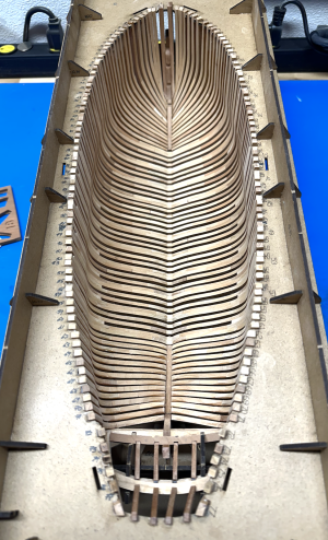

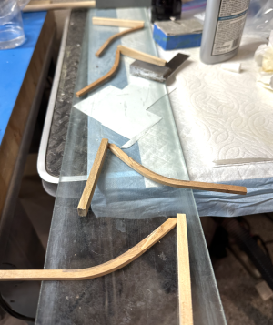

After cutting away the model from the berth, I sanded, filed, and occasionally Dremeled my way to a final fit using the lines from the template.

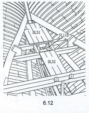

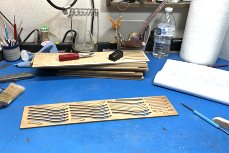

I have to tell you, I looked at the pieces and the instructions for the cap rails and despaired. It just didn't make any sense at all. Not enough pictures and the instructions contain English words, but aren't actually English as far as I can tell. So I sat on this for a while, part of the reason I did another project (that I had already started a while back).

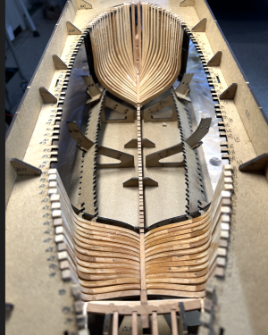

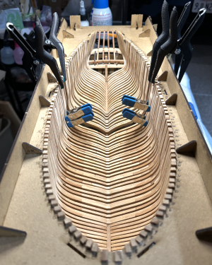

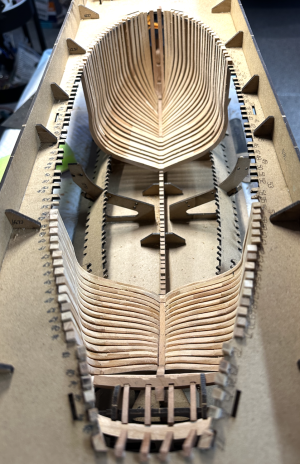

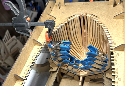

I also noticed that the frames on the starboard side rise above the decking less than the port side for much of midship. I don't know where that error crept in. I have never had good luck with guides for the decking from a jig. In this case on side didn't fit into the hooks well. Sometimes I think it would be better to use a buildng board and to measure from the plans. I have applied all manner of small scrap pieces to the tops of the effected timbers and will sand to shape and length.

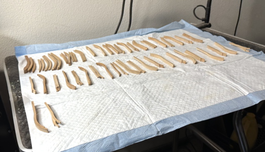

I finally regained the courage to continue this kit. For the differences in the top timbers at the deck level, I cut some scrap up to glue onto the tops and then shaped the tops carefully. This is what they looked like before shaping. Like many steps, they start out looking like it will never be right.

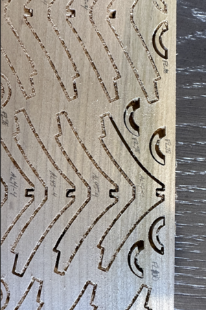

I took a detour from the railing and went back to the ongoing problem solving for the pumps. I tried the parts in the kits the way suggested in the pictures I found from the manufacturer and it was an unmitigated disaster. The pieces splinters on their edges and never looked right. Also, the angles on the back aren't 22.5 degrees like they should be for an octagon. Again, I am working with a kit that is probably well above my skill level, so I'm sure I just didn't have the technique.
Fortunately I sensed that it might not work out well on my first try so I took measurements of the pieces before I cut anything out. I drew the parts in Illustrator from the measurements and cut them from boxwood on my laser cutter. Boy, that thing is handy for botched parts. I had to try more than once, but finally got two I liked and glued on the zinc parts.
Progress, but cautionary tale for this kit at my skill level:
It took a while to figure out the next part of the rails. Again, the instructions rely on you to already know how to figure out this stuff.
