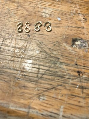

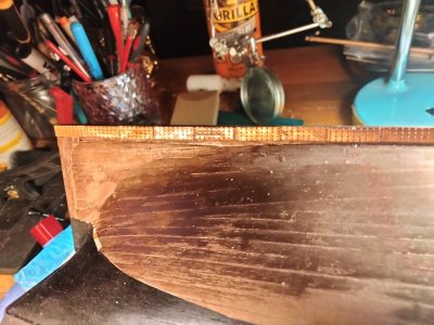

I've been making hooks while I watch the videos. No real consistency but have made about 50 so far. What ll pick and choose when the time comes. I suspect,I'll get better and more consistent with practice.17500160204935333379166026916238.jpg

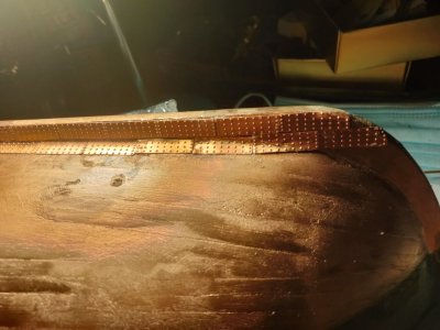

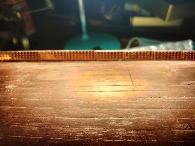

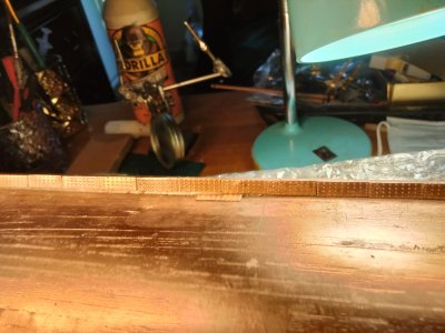

I glued one plate with the Super Phatic glue and it is holding better than the ca.

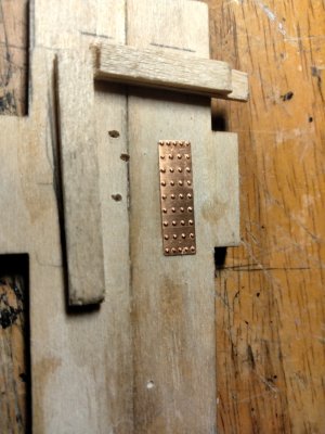

After only five minutes I tried prying up a corner of the plate and the remainder of the plate remained adhered to the wood rather than popping off. This looks like a great product for this task. Water cleanable until cured.17500300185701132394071905988470.jpg
The super Phatic glue is really thin and the plates float around when I'm installing them. I have started putting a dot of CA on all four corners and one in the center of the plate. This locks in place. Making a pool of the glue on a bottle cap allows the SP glue to thicken and gives a thicker coating the back of the plate. All in all I think the end product is straighter and looks better than before

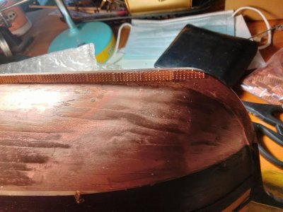

Have sent several emails to Caldercraft/Jokita but no response. In fact they have never responded to any of my messages. Are they still in business IMG20250618113358.jpg
