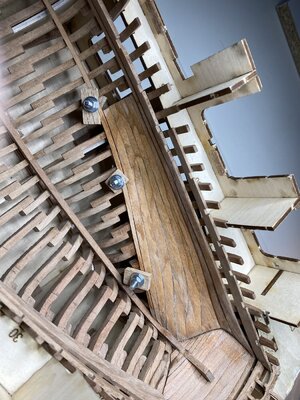

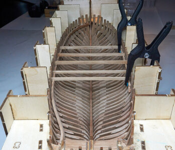

I have a reef tank and a few other hobbies that takes quite a lot of my spare time so I cannot spend so much time in the ship yard. Thus the progress of the last week is limited to a couple very small steps. I have made the inner planking of the stern section, glued one of the middle deck clamps and I have started to dryfit some of the other deck clamps.
One of the spring-clamps had a strong desire to fly all the way across the living room. I don't know if it mistook the Courreur for an aircraft carrier but without permission it made a close flyby over the ship and broke one on the bat wings on the stern

Space-ships can fly :cool: In this case it was a spring-clamp though. Unfortunately I did not know that these things can fly. Now I have learned. Not only can they fly, apparently they can fly beyond mach 2 . . .or something :(

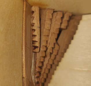

I rushed ahead and did frame 1. It was not straightforward. The key is to figure out the correct orientation first. The only way I could make it work was to orient the frame so the teeth were pointing to the bow. Then use one of the contour lines to get a rough fit with the notches in the jig (this should be obvious once the piece is oriented the right way). Finally, start at the bottom and gradually fair the piece so that it fits into jig to the required depth.
It actually makes sense once you start doing it... but very hard to guess from the lines themselves.

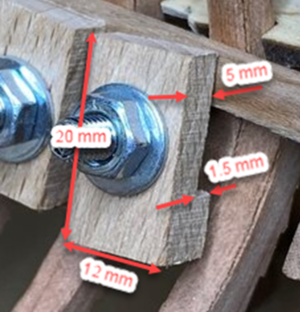

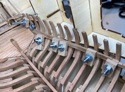

I am planning to make some clamps like you show in the blog. Can you provide approximate size on what you are using to I know what to cut parts too. I have scrap lumber from other kits to use to make some or all of the parts needed to build a few for my use.

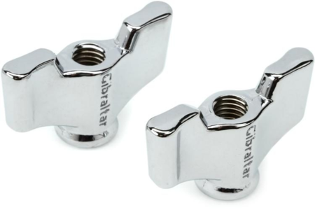

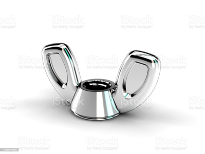

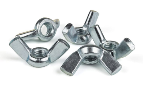

Great clamp additions, Poul. If I may suggest, to swap a regular 'nut with a 'wingnut'. They come in a variety of shapes and\or sizes. Here is the typical one

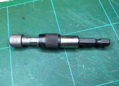

Thank you for the advice my friend :-) I would have used wingnuts but I didn't have any. Apparently physical shops around here does not have less than M5 and I could use maximum M4. So the only option was internet shops. I'm too much of a Ebenezer Scrooge to pay a fortune in freight for something that cost 1$ for 4 pcs.
Hence I opted for the nuts I had in the garage. Using a top it is actually just as fast as wingnuts and by turning the shaft with my fingers only I have good sensitivity of the force used. So maybe I'll just stick to this solution. Unless you tell me there are some advantages with wingnuts I overlooked?IMG_1036.JPG

Hi Kurt, I made a few different sizes but most of them has aprox. these measurements:
the outside part has same lenght an width but flat 5 mm thick all over. The screw is M4 (for some ships in 1:48 I think perhaps M3 is better, or the screw may have to be flattened between the frames. Anyway it does not take more than a few minutes to make half a dozen so I can alway make some more in other sizes)
Thank you for the advice my friend :) I would have used wingnuts but I didn't have any. Apparently physical shops around here does not have less than M5 and I could use maximum M4. So the only option was internet shops. I'm too much of a Ebenezer Scrooge to pay a fortune in freight for something that cost 1$ for 4 pcs.
The only advantage, IMHO is an ability for a quick set, While holding and positioning parts with one hand, you can tight clamp with another. Also tightening by hand you can control the force you are applying. But I totally understand the availability situation and crazy shipping costs.

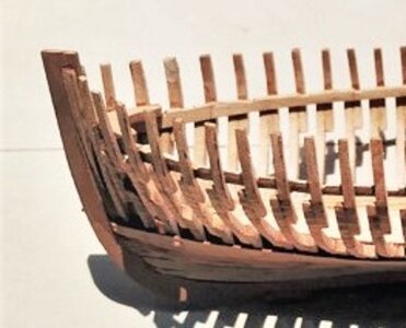

I'm thinking a little bit ahead for the inner planking and I wonder if there is kinda best practice regarding which side to keep open for a glimpse of the interior? Looking at others I noticed that Uwe and Etienne Piette seems to have decided leaving the starboard side open while Tom/CAF and Francesco has opted for the port side. I think the same goes for the model build for Jean Boudriot & Hubert Berti's monograph. If there is no best practise, what are the pros and cons of either side? The only thing I can think of myself is that the small cutter / lifeboat is placed on the starboard side and thereby might obstruct part of the view through the deck.
you're right Poul not only you do not miss anything .. but also read the thoughts of others! after the effort I had to make the lifeboat I absolutely wanted to enhance it . I didn't want it to obstruct the view of the interior from the deck.. and even less so that it was placed in the void
After all I don't think it makes much difference though..

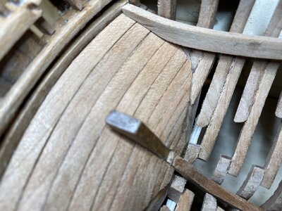

Anyway, I've got all the deck clamps installed and have slowly started on the inner planking. Since I did not hear a lot of pros and cons for which side to leave open I opted to have the port side open (due to the minor obstruction of the lifeboat).
I'm taking a different approach to other before me and starting with the top section (1R) trying to see if by doing it that way could exclude the need of stealers - and it does! The intricate shapes of the planks does actually fit together without using any stealers and no excessive sanding other than barely removing the laser char. Moreover the lowest part of this section almost hit the pencil marks I had initially made for the top of plank 12 of section 1P
The top plank from section 1P is only dry fit.
The color is just a tiny bit of water put on with my finger to spot residual glue.
The pencil mark on the port side was an attempt to mark the locations of the 2 lower deck. As Uwe said, these marks can of course not be made when the inner planking is in place but I'm thinking they can be transferred to the inner planks when the planking is approaching the marks, using e.g. a compass or a piece of 10 mm wide plank to displace the marks with 10 mm and then shift them back the 10 mm in the opposite direction once the planking is finished (just mentioning this for the sake of others, for me it is too late to do it that way, I have to mirror the marks from the port side to the starboard site)
I'm thinking about leaving out plank 12 (maybe also 11) in section 1Q (port side) to get a bigger "window" to view the interior from the outside. What do you guys think? Bad or good idea?
