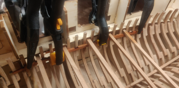

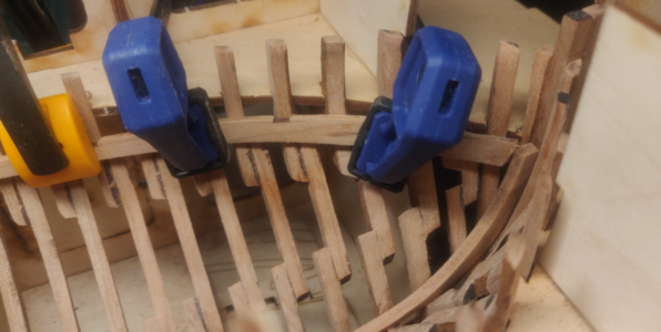

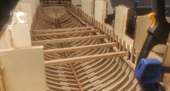

Next up were the lower deck clamps. Positioning of these using the measuring sticks has been covered elsewhere. I bent the clamps by soaking for 12 hours, setting in a curved jig and applying heat using a travel iron. I then soaked them again and clamped them in their final location, allowing them to dry.
Another good tip here is to start with the middle clamp, then do the rear and front, sanding the ends to fit.

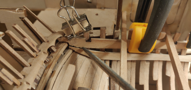

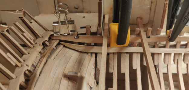

Port side upper clamp deck is next. Careful fitting followed by gluing... then I noticed that there didn't seem to be enough space between the upper and lower clamps (note where the tip of the file is inserted).
I consulted the plans and it appears that the lower edge of the upper clamp should be level with the shelf that it rests on. I quickly removed the clamp before the glue dried, sanded the aft lower edge to a gentle taper and reinstalled.
Much better.

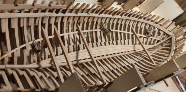

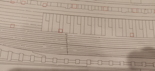

Moving on to the inner planking, it seems there is an error here somewhere.
So let's assume you believe this plan, specifically that the #12 inner plank should end butting under the horizontal measuring sticks (red squares). This seems pretty reasonable.

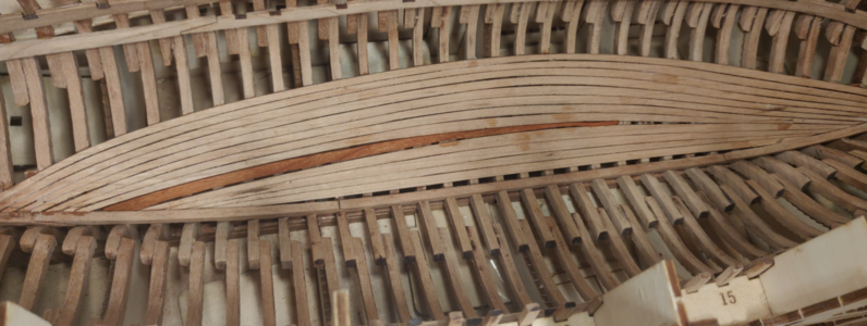

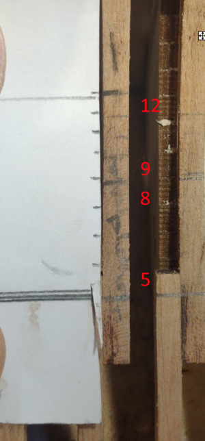

However, I transcribed the plank heights to a piece of scrap paper. As noted in Uwe's log, planks 1-4 fit snugly together and so do 5-12. However, there is a suspicious gap between planks 4 and 5.
I then pressed plank #12 into place, butting it against the horizontal measuring sticks and drew a line where it intersected the frames. Using that line, I positioned the scrap piece of paper and marked off the location of planks 1-11. The marks weren't perfectly aligned due to the width of the planks, so just to be sure I fitted planks 9-12 and traced their lower edge. Then did the same with planks 5-8.
This leaves a rather large gap on the bottom of the frame, enough to fit 6.5 planks (not 4).

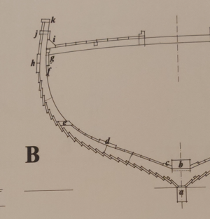

We know there is a limberboard in there but there's still room for another large plank. This is probably the missing plank "d" depicted on the Boudriot plans.
The correct way to plank this would probably be planks 1-4 (in order), followed by planks 12-5 (in order). The the missing plank D has to be hand cut and fitted.

I also wonder if this explains the need for stealers others required when fitting the stern inner planks.

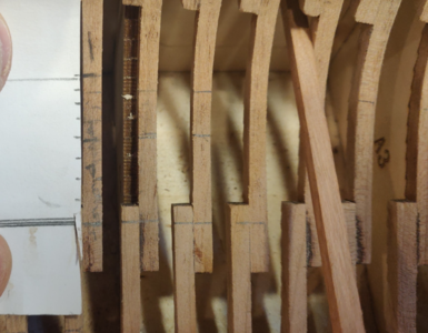

Working from the top down showed that the garboard strake and upper planks (planks 1-4) were installed a bit too far forward. I attempted to follow the plans and installed the fore tip of the garboard strake at frame 6... it would have been much better to install it perhaps at frame 7. This resulted in an uneven gap between planks 4 and 5.

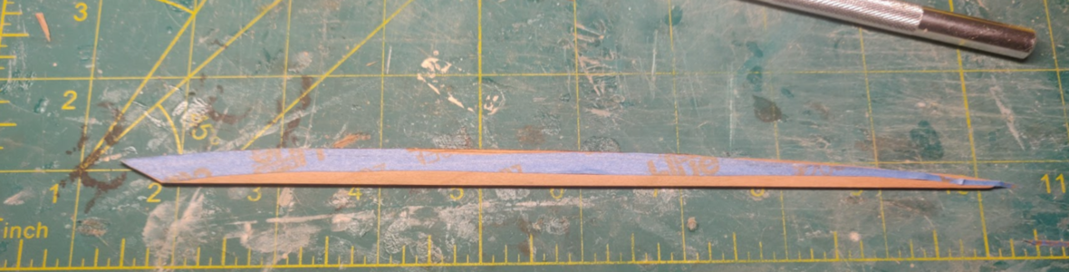

I intend to fit a raised plank ("d" in the Boudriot plans) but this gap is too wide, so I created a filler for it. Using blue painters tape, I cut a rough fit and then gradually sanded it down with a drum tool to fit.
Test fit:
Pretty decent. I left a bit of space on the bottom edge as this will be covered up with the raised plank "d".
While it's drying, I took the opportunity to assess how much clinkering (and thus sanding) is going to be needed. I do this by shining a light from above and seeing where the shadows drop. Most of the clinkering is at the fore and aft ends... there's relatively little in the middle due to the fact that the planks were properly cut to fit. I also noticed that the tip of my stealer around frame 7 is slightly raised... will need to glue that down.
Next step will be to fill the cracks with dilute wood glue and give it a good sanding to fill in the gaps.
So while I'll reproduce the same positioning on the starboard side so that the planking pattern matches, I would do things a bit differently if I was starting over.

Another question... what type of wood is the inner planking? There does not appear to be enough scraps to make a plank "d".
As for the shape of this plank itself, it appears it should be shaped similar to #5 though a bit wider (exact measurement can likely be lifted from the Boudriot plans). It is positioned in about the same place, roughly at the upper end of the junction where the #20 frame lower and mid frame sections meet.
I doubt the thick stuff was one long plank. If you make it in 2 planks there seem to be lots of extra wood e.g. on plate 1M & 1N. This board is a little thicker than board 1O & 1P so in your case it is maybe not directly useful. Assuming you are only using one of the boards 1S & 1T as well as either 1R or 1Q maybe you can get the extra planks out of the 2 not used board.
Besides, I think there are plenty of extra 1.5x5 mm lists. These or the extra wood from 1M / 1N could be sanded down to proper thickness

The Boudriot plans state that the mid-plank is made of two parts, though he doesn't provide any further detail. I would assume that it means there are two parallel strips which make up the plank (otherwise why say anything?)
Plates 1M and 1N likely have enough wood if doing 2 strips on each side. The question is how long (exactly half the length of the ship?). Perhaps this is related to the earlier question about a nail and planking pattern.
I think these planks have to be custom cut. Making them from 1.5x5mm strips will probably clinker.
Looks like 1M and 1N are the same thickness as the inner planks (~1.37mm). So that could work!
