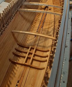

Voici quelques photo du François, je n'ai malheureusement pas pensé à faire un reportage complet au début de la construction. je vais essayer de faire cela maintenant, et faire des photos de meilleures qualités.
le chantier avec sa quille (notez un relèvement à l'avant et à l'arrière)
google:
Here are some photos of the François, I unfortunately did not think of doing a full report at the start of the construction. I will try to do this now, and take better quality photos.
the site with its keel (note a front and rear bearing)

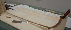

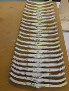

quelques pièces de charpente
some pieces of frame
quelques varangues
some floor timbers
suite au prochain post, ici c'est pour un essais
following the next post, here it is for a test

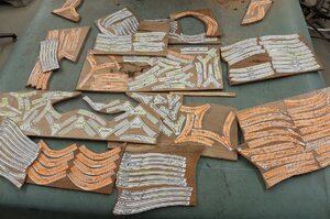

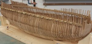

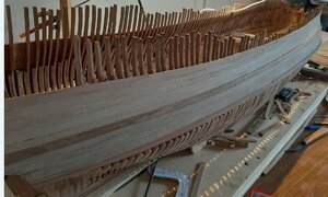

here is somes other pictures, The quality is not perfect, i'll try do better for the next.
here is the projet at this time.
pour le moment, je suis occupé a faire les porques des photos suivront dans quelques jour.
for the moment, I am busy doing the porches photos will follow in a few days.

That should be a beautiful model in 1:36.

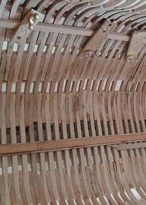

What is the wood selection you are using?
Frames in pear, but what is the light coloured wood for the planking?

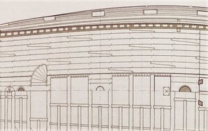

Just received also the booklet of the monograph in english language, so I had a chance to read a little bit.

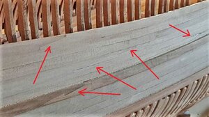

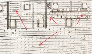

The hull as well the decks of the Francois was planked with butt joints (on the two excerpts from the monograph with red arrow)
(left deck - right hull)
And we can recognize these joints also on your model
Great detail Thumbsup

Your right about joint of the hull, if you look rignt there is 2 kind different of joints one on (preceinte c'est un assemblage a trait de jupiter) I Don't know the name in English, and the other on the simple plank of the hull and deck. the lengt of the planks are about 8 to 10 metres. (26 to 32ft)
Here too, for facilities, I Don't make this kind of joint at the place where I must cut for the sabords.
