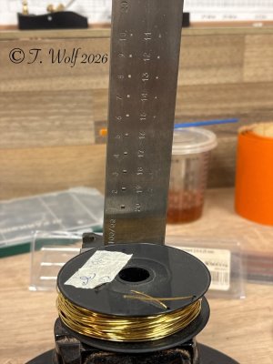

That looks fantastic Tobias! Have you detailed somewhere how you made the square wire? Did you hammer lengths of wire, or do you have a square drawplate?

@RussF , regarding your question, yes, I use a wire drawing die. I have two: one for round wire, which limits me to buying only one size.
The second one is for making square wire.
These wire drawing dies are sold in jewelry supply stores, so anyone looking for one should check there.

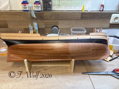

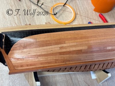

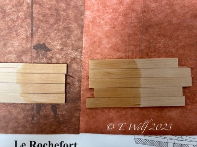

My friend, I think I wrote something about this earlier in the report. But no problem, I use "Ballenmattierung" (Ball Matting) from Clou.
What is Ballenmattierung?
Ballenmattierung is a product for manually finishing wooden workpieces. In just a few steps, you can achieve a satin-gloss surface. The surface must be dry, grease-free, and dust-free. I've tried many different varnishes, oils, and waxes. For me, the Clou product is the best. Why? For example, a treated surface can easily be roughened with sandpaper or completely stripped of its finish without leaving any residue.

Cześć Mirek, dziękuję bardzo. Tak, korzystałem z Clou.
Hi Mirek, thank you very much and yes, I used Clou.
Thanks Tobias. You did but I had forgotten….was too lazy to sort through 54 pages ROTF. Thanks again however I cannot get Clou here so will have to stick with linseed oil. Cheers Grant

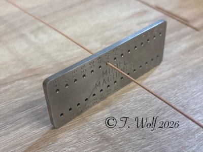

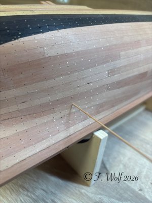

Preparing a wooden nail with the model Machines Plate.

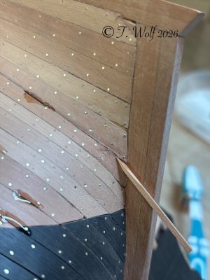

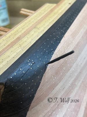

Sharpen the wooden nail and insert it into the correct hole.
Now prepare the wire, cut off about 20cm from the roll and sharpen it, warm it slightly and then insert it into the correct hole and pull it through with the pliers.
A few minor cosmetic corrections and then sanding everything down.eZy Watermark_05-02-2026_08-53-26-4430PM.jpeg
I filled the slightly larger gaps with superglue. Results in the next post. Have a nice evening, see you soon.

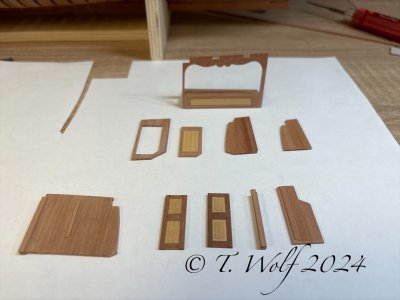

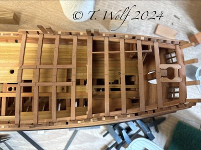

Hello dear friends,
we remember the expansion of the sleeping quarters and the deck beams.

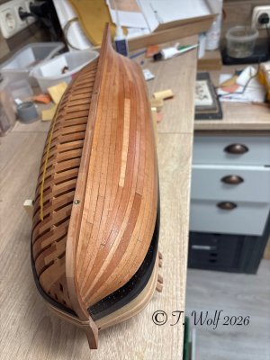

As I mentioned before, there was an accident with one of those nasty clamps during the planking process.
I know, it's supposed to be built up, not demolished. The damage was too extensive, so it will be removed for now and rebuilt in the near future.
Therefore, my advice to everyone: only work on the outer planking if nothing has been finished inside the hull yet.
