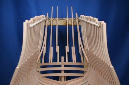

Here are the lower and upper counter timbers during fabrication:

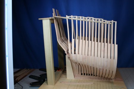

In order to control the position of the counter timbers I made a jig:
I mentioned the top timber that sits above the fashion pieces (forming the corner of the ship in the back). That piece is a 3D marvel that shares the profile of the counter timbers I just showed - but it also follows the curves of the ship hull (effectively making this piece S-shaped when viewed from the stern).
In the center of the image shown below you can see this vexing part. My first attempt was long ago abandoned. This was the second attempt. It has also been binned after an investment of nearly a full day. I made the mistake of trusting the drawing of the filler frame (labeled #18 in the picture below) when creating the curved portion of the fashion piece top-timber.
Anyway, I have given up for the day and will make another attempt over the weekend.

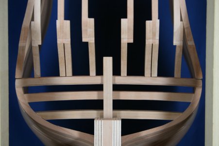

Hello Friends,
Over the past two days I have managed to make actual progress on the stern of the ship. With several failures in my wake, I was starting to have a pretty good idea of how to fabricate the top timbers of the fashion pieces.
As it turns out there was less 'curvature' than I had envisioned. I would love to blame Mr. Lemineur for the previous failures, but at the end of the day I think it would be better to own my own mess rather than blame someone who has forgotten more about ship construction than I will ever know.
Unexpectedly, Nigel has now offered to move to the US to guide me during the balance of this build, so that is comforting...

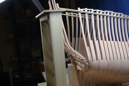

Everything is loose fit and prior to fairing...
I wish I had more excess for the fairing process, but at this point I think it will be acceptable. Keep in mind that the exterior of this stern section model will be planked - everything you see will only be visible from the inside, and the particular shortcomings will almost certainly be lost in the overall experience of taking in the build out of the interior.
The learning curve has been steep...but I hope it will pay dividends in the future...
Agree with Christian, your last picture really is the “money shot” Paul Thumbsup
Things will really take shape now as you add the fan of upper futtocks to close the gap.
If you do find you have an odd low spot when final fairing these upper timbers, don’t be afraid to add a sliver of Pear. As you say, this area will all be planked. This is much better than oversanding to try and chase a dip

I love the last picture. She has beautyful curves.
Indeed. And this interior view will remain open albeit with the addition of beams, knees, etc. - but no interior planking or decking.
